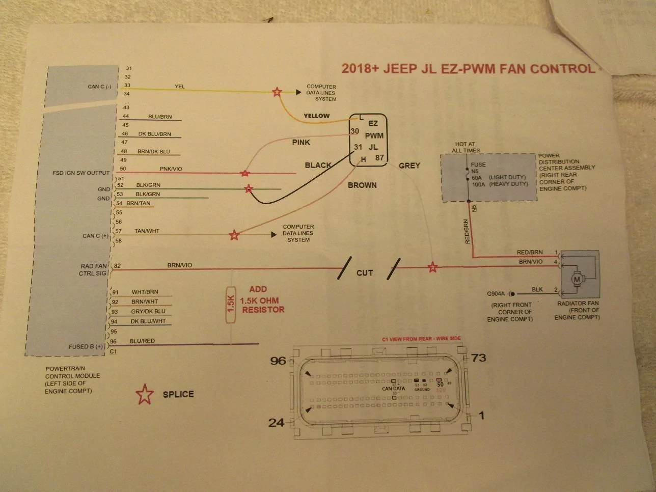

Seems like this is my next mod. The instructions on their site doesn't seen to be downloadable. Im curious how you tied into the CANBUS system and where. Was power connection at the battery or and Addafuse from an ignition controlled power source>?

Seems like an easy 2 beer install.. Now to see if it works on the 2.0 Turbo E-Torque
I need to find the ECU connector and see how accessible it is. I might have the pin extractors for that conn. too. I don't like the wire wrap and solder method of splicing

It should work on the 2.0
You can pull back the loom tap and see if the wire colors mach his wire diagram
I believe I was the first one for the 3.6 JL
Jon told me that he would make one and test it on his 2018 3.6 wrangler JL . Jon has been making these for the Jk for a few years . Drove my wife's 2018 Rubicon JL 3.6 last night and realized that hers is running 221 coolant and 218 oil so hers is next. I am so so happy with the one on my 2020 willys

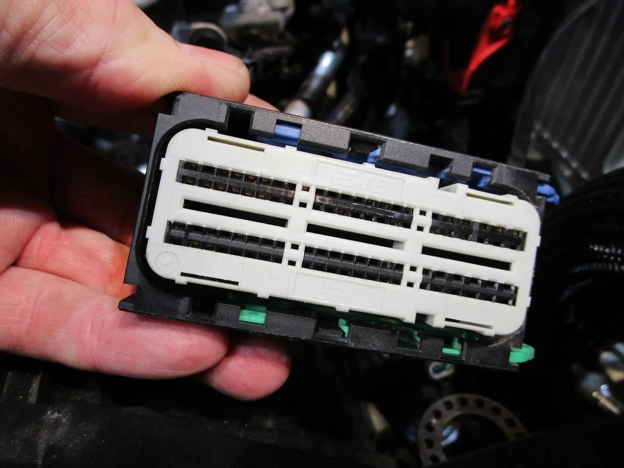

Doesn't seem like there's a lot of room to work with those connections. How'd you manage??

Yes, looking at the 2.0 its pretty tight. I check in with Jon once a month for the 2.0 fan system, Still nothing yet. Im at a point that if anyone is in the area of Jon ill pay for half of that persons kit just so that Jon has something to set it up on.
