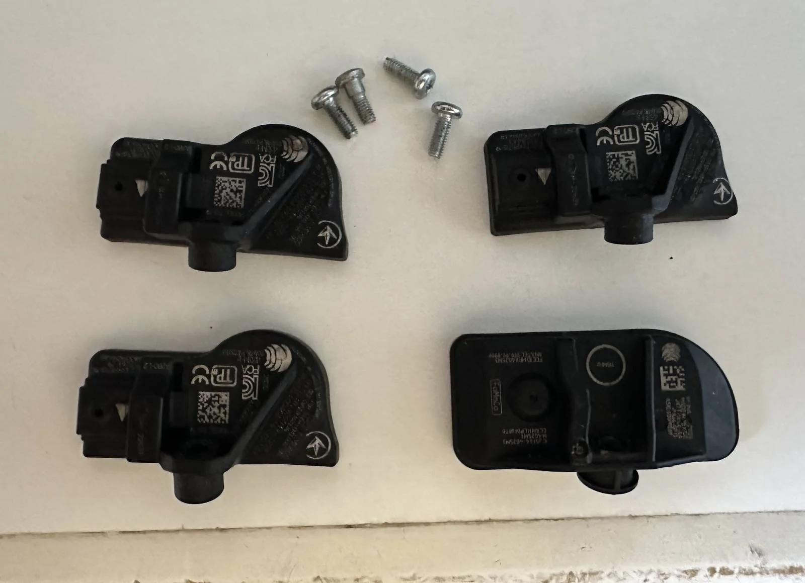

These are the new TPMS sensors from Continental - good from sometime in 2021 until now.
Jeep Wrangler JL Questions on Swapping TPMS Sensors i-7QzTn5d-X3
These are the old TPMS sensors from Schrader - good through sometime in 2021.
Jeep Wrangler JL Questions on Swapping TPMS Sensors i-Vkbh63g-X3
If you have the right sensors, new combinations will sync up while you drive around. Generally, in less than 5 miles.

These are the old TPMS sensors - good through sometime in 2021.
These are the new TPMS sensors. Good from sometime in 2021 until now.
My tire guy put sensors on a set of wheels and tires I bought for $10 per wheel. The tire did not have to be removed, he just used his tire machine to push one side of the tire over enough to stick his hand in and change the sensor.
I have had no luck selling used TPMS sensos.
You have those flip flopped. The gray ones are Schrader and older than 6/21. The black ones are Conti's and they are the newer version 6/21 and newer.
