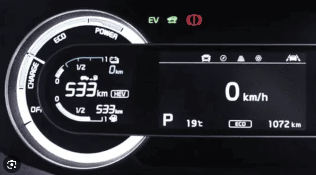

To add to what I wrote above, Jeep handles the PHEV battery % indication in a weird way. The PHEV I owned before this, a Kia, handled it much better in my opinion. The battery display looked like this:
Jeep Wrangler JL 4xe questions TiP18Hs
The battery level indicator is above the 533km text. It shows that actual, real battery charge level, with the 25-100% level being highlighted in blue, showing the amount of battery remaining for dedicated EV driving, with an estimated EV range under it. The 0-25% level is white, and shows what's reserved for regular hybrid mode driving.
It is much more clear, looking at this display, that even though you've exhausted the EV range of the battery, you've still got 25% left (or in the case of this photo above, probably more like 18%).
Jeep's vague way of doing it, calling any battery level in the 0-25% range "<1%", is very confusing and doesn't really give the driver the whole picture about what's going on with the battery. I have no idea why Jeep decided to do it that way, but I wish they'd take a cue from Kia in this case.
