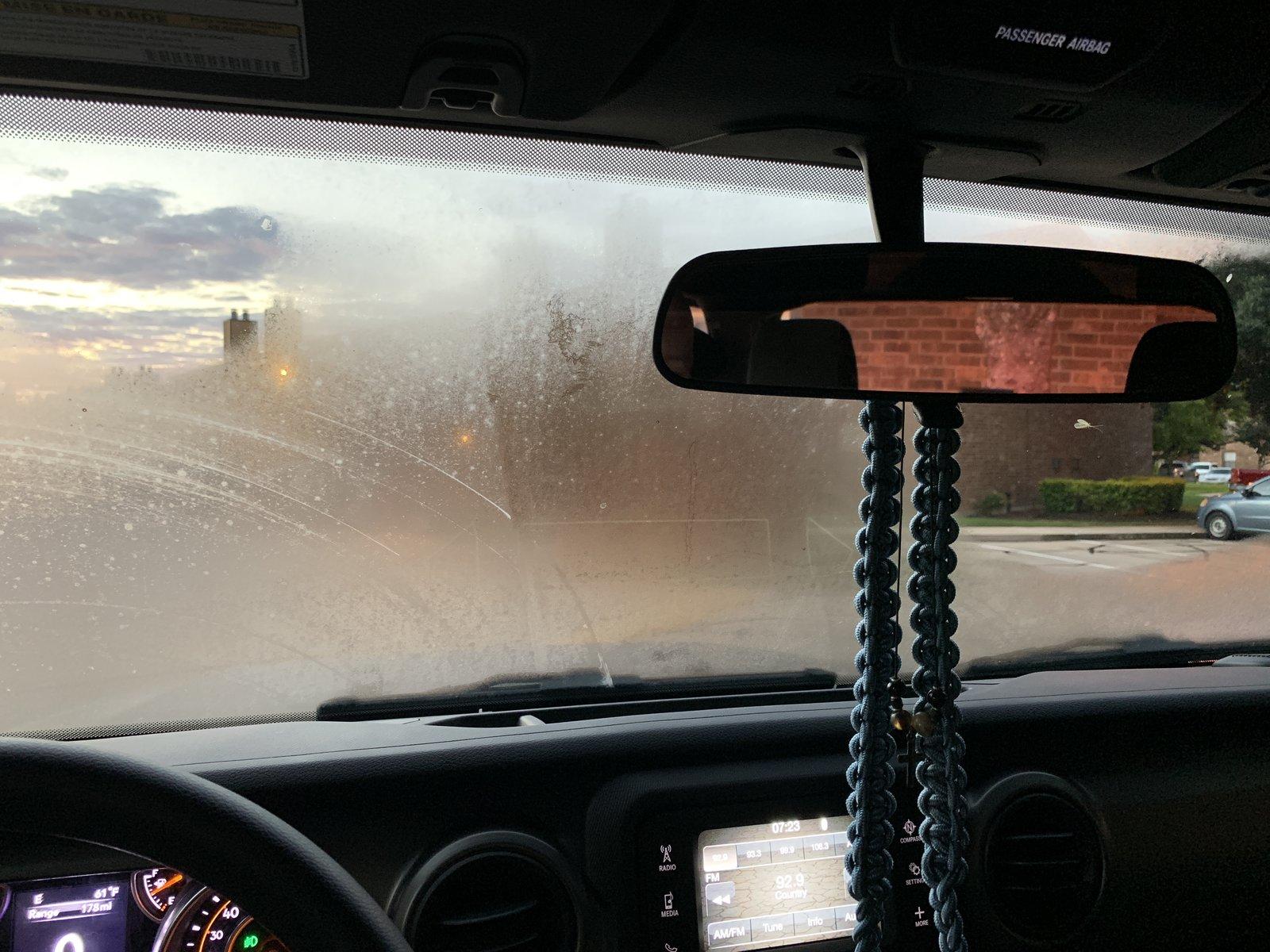

I tested mine out this morning and noticed that the middle cleared last for me, even noticing that air only came out of the middle as shown by OP... luckily I’m in Texas and won’t have to worry significantly about snow build up!
Jeep Wrangler JL Question regarding the Windsheld defrost 6C73BF53-71E8-4757-BC3B-91F45951F29F
And that is the way it is, we all own this issue!
“Middle cleared last”. You mean the sides cleared first with only air coming out the middle? Not understanding.

That’s what it seems. Air strictly came out of the middle of the vents, but both sides cleared up before the middle of the windshield... doesn’t make sense to me, but pics say it all.
Maybe the Jeep design engineers are smarter than we think.
Guess we have to wait for more real world experience from others.

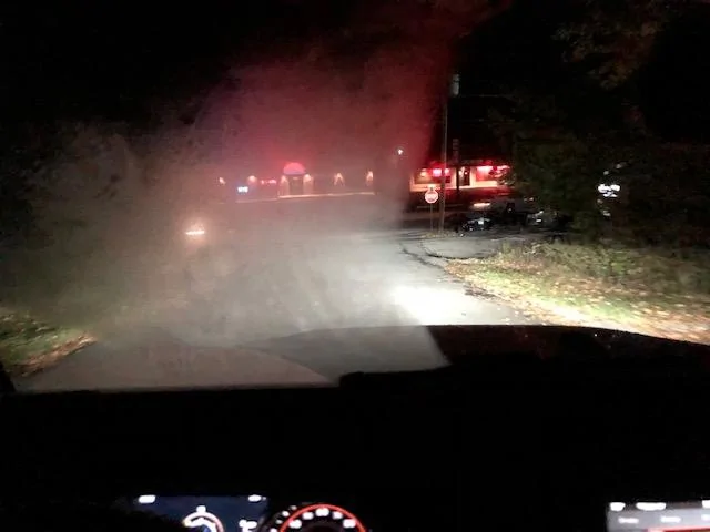

so here are a few pictures after warm up on remote start , so about 5 minutes of warm up and another shot 10 minutes into my
drive . tHIS SUCKS !!!!
This could be a real safety concern. I would file a claim with NHTSA. This is a real design defect. No joke!
Eveyone needs to report it to NHTSA.
https://www-odi.nhtsa.dot.gov/VehicleComplaint/
Again, who was testing the JL for 3 million miles exactly?
How do Jeep engineers get something so simple, to be so bad. Doesn’t give me faith in other systems. Kind of like the recirc damper door design that randomly opens and dumps unregulated/unfiltered outside air directly into the cabin below the glove box. The HVAC engineers really messed up. They should be ashamed. We should give them an award for “Worst HVAC system in a modern vehicle”.
FCA are you reading?
You have the auto temp control? Was this with the defrost or A/C on to dehumidify? Was it set to recirculate or fresh air?
This was set to defrost,which kicks the A/C on . Also this is not fog this is frost ..... nothing on the inside of the windshield .
I assumed it was fog inside the windshield that was not being dehumidified. Frost on the outside is another issue all together. That's a huge problem if blasting the windshield with defrost mode for 15 minutes. That definitely should have melted and cleared up the frost outside. I wonder if you have a blend-door problem? Is the air from the top windshield vents hot? Or do you feel its because the JL only has functional vents in the center and not in front of the driver and passenger areas of the dash?
