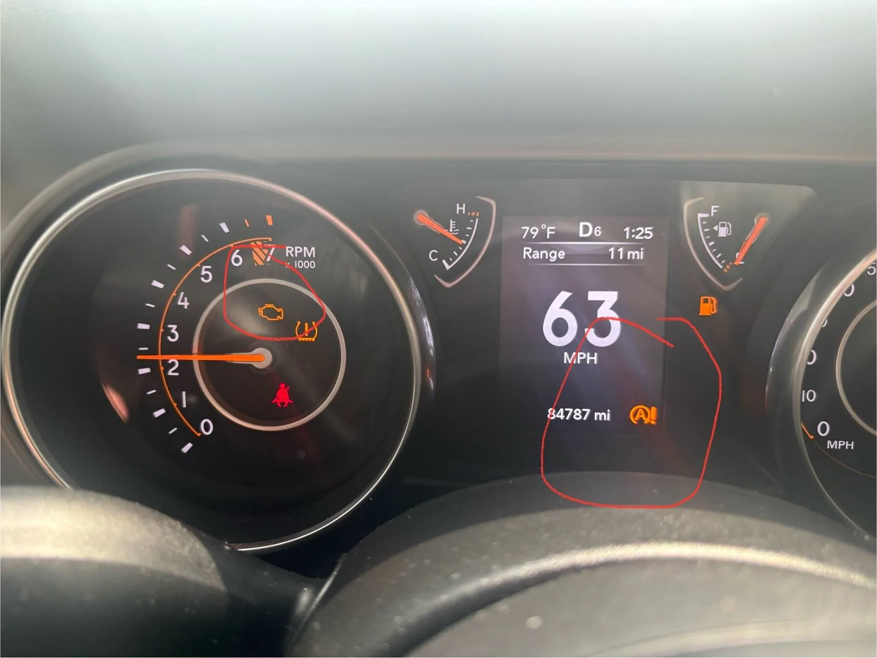

Is this what is happening to your dash?
All subsequent cold cranks will still test the Aux battery but if it fails, repeat this procedure automatically trying the crank against the main battery, and if successful at getting just the main battery to crank the engine, keep this ESS off light illuminated in the dash.
When this light is on ESS events can't occur: this light having no connection to the ESS off button.
Not until the next cold crank in which an energized Aux battery is detected, if any, or the JL is tricked as per the below procedure, will this light in the dash shut off.

I'm sorry, I mildly misspoke. The ESS off light in the dash appears as the letter "A" with a near circle around it followed by an exclamation point as shown in your picture OP, not this letter and circle with a slash through it as I originally reported.

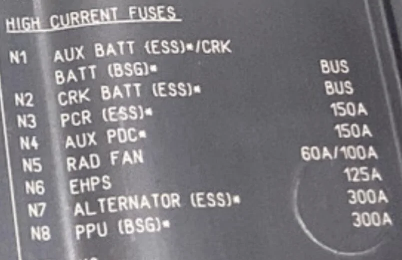

The Aux battery, as per the factory spec participates in providing power in engine cranks along with the main battery: cold and post ESS event alike--the main battery bearing most of the responsibility for turning over the engine.
Genuine question: is there documentation the PCR closes prior to ESS starts?
I remember reading about this; I will try to find the source.
That said, with the PCR relay energized and open I don't mean to imply that the main battery can't, say during ESS event be tapped. In fact when Jerry @Jebiruph did the initial testing on this I think he found some things on the dual AGM battery JL that tap the main battery, like power steering, even during ESS events.
Thoughts Jerry?
https://www.jlwranglerforums.com/forum/threads/drained-battery-any-jumpstart-tips.12316/post-981215
The EHPS (power steering) and radiator fan are connected to the main/crank battery through the Z Case Fuse Array so are physically unaffected by PCR state.
