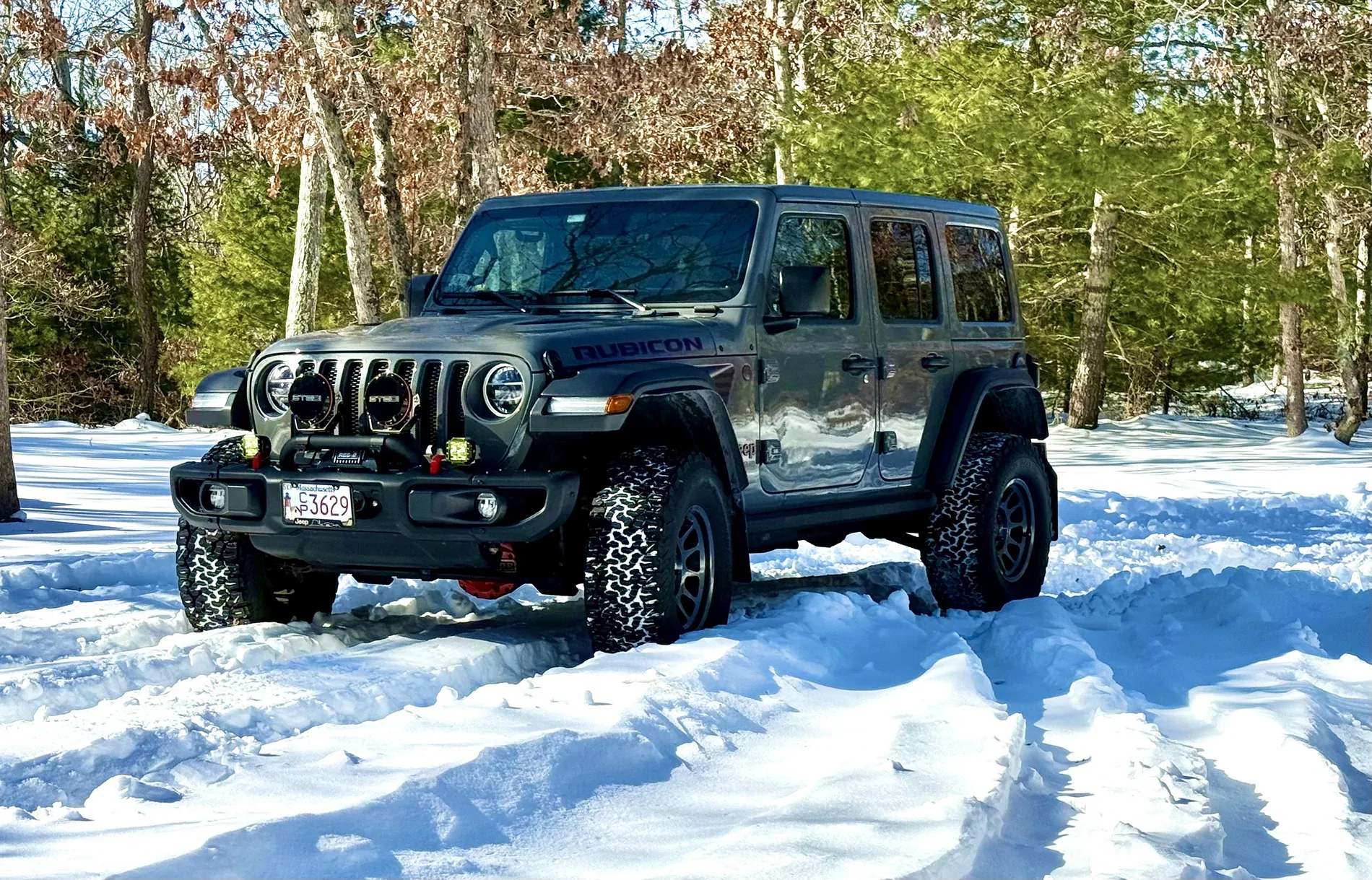

I built my Rubicon up to take mild trails, not crazy rock climbing stuff as it is also a daily driver. The Rubi is already super capable, so I did not want to go overboard. I looked in to most of the kits available, and in the end settled on Clayton 1.5 Overland+ with Accutune's Fox shocks. Kit is complete with arms, springs, track bars etc. Awesome quality and the ride is better than stock. Would not hesitate to do this again. And if I ever decide I want to upgrade it, it's easy peezy too.
