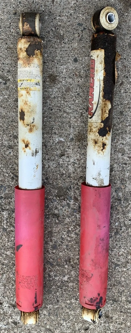

Rancho shocks are prone to rusting heavily. They look pretty bad after a few years even on our roads with zero salt.
These came off my 2018 Silverado with 15K miles at 3 years. They were OEM. They were leaking. I would never buy Rancho's.
Yep. We throw away a lot of them that look just like that. On a work truck, they do function well, but the body rusts so bad I would never put them on a personal daily driver.
