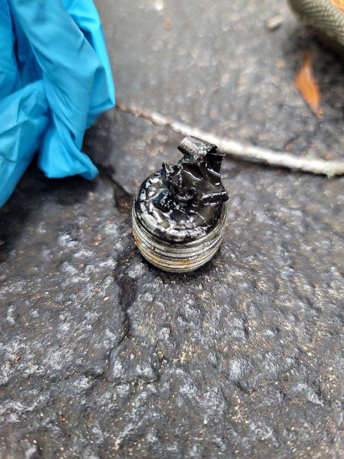

Just got done doing this at 17k miles and went well. Both sensors were without any oil and came out easily.
I didn't have to take off the right side bolts, just uses a very thin t20 and the sensor bolt came right out.
I went agonizingly slow drilling the holes in the sensors and let them sit a full 24hrs to cure. The potting mixture is very runny, so be prepared with some shop towels.
I did have a bit of metal in the rear (image attached), but the front was clean.

I feel a lot better after getting that crap out of my diff and the sensors potted.
Likewise
Glad I did it thus far. The only thing I didn't do the way I wanted was to use yellow thread tape on the fill and drain bolts.
I had to use thread paste, so hopefully they don't leak on me... if they do I'll just have to drain and refill I guess.
