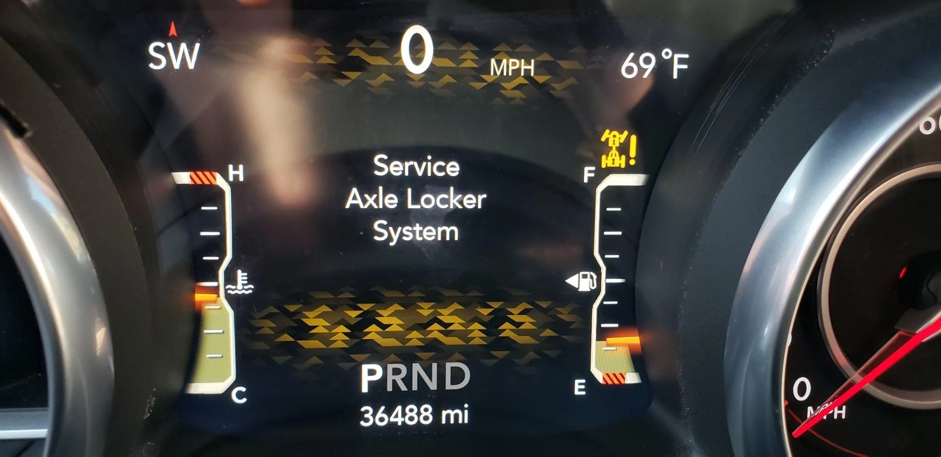

Another great post about this issue. I recently had the dealership change out the 3rd new axle to "fix" this problem. The plan was to pot the sensor as soon as I got home. But I ended up getting this warning less than a mile from the dealership. And my understanding is that if the error has already started, then the capacitors are already starting to fail. So, I will have them put a 4th one in it. Maybe this time it's the front?
Holy crap, what a shit show. I hope you can get it resolved. Have you tried the zautomotive wiring harness thing?

I considered it, definitely. But I want to have the electronic sensor fixed before considering the bypass. It's ridiculous that they don't have the sensor available as a separate part yet. So I will keep forcing Stellantis to repair it on their dime.
