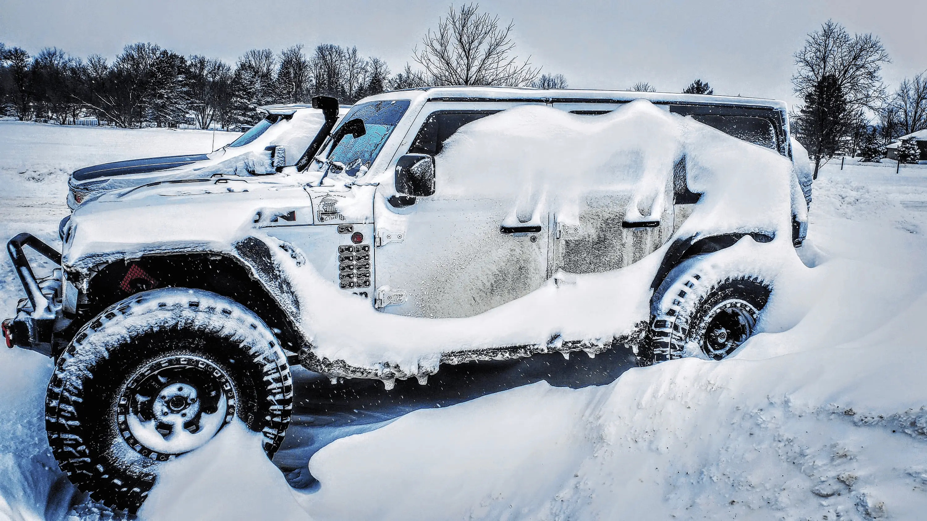

Anyone used the screen protector in really cold weather? Do they resist the cold fairly well or a waste to use at temps below 0F?
I have not had any problems in cold weather like this...
