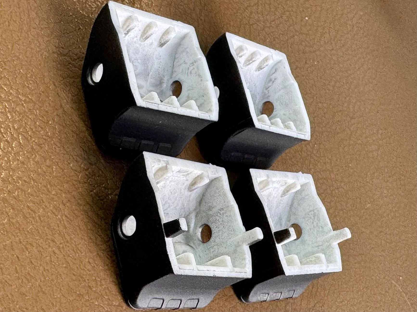

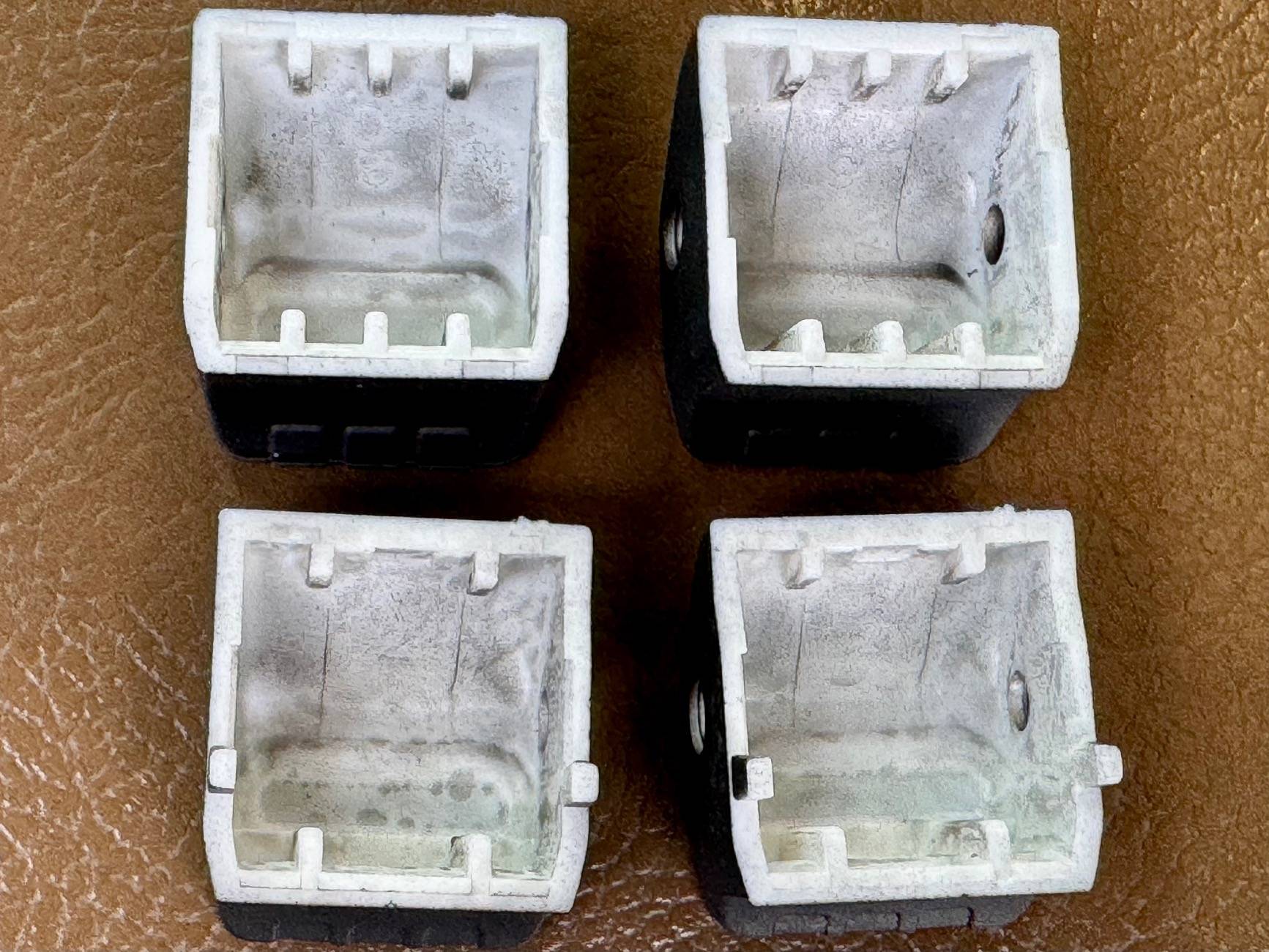

The edges of the levers are deteriorating. I pulled off the edges since they were about to fall off. They still work but feel very wierd.

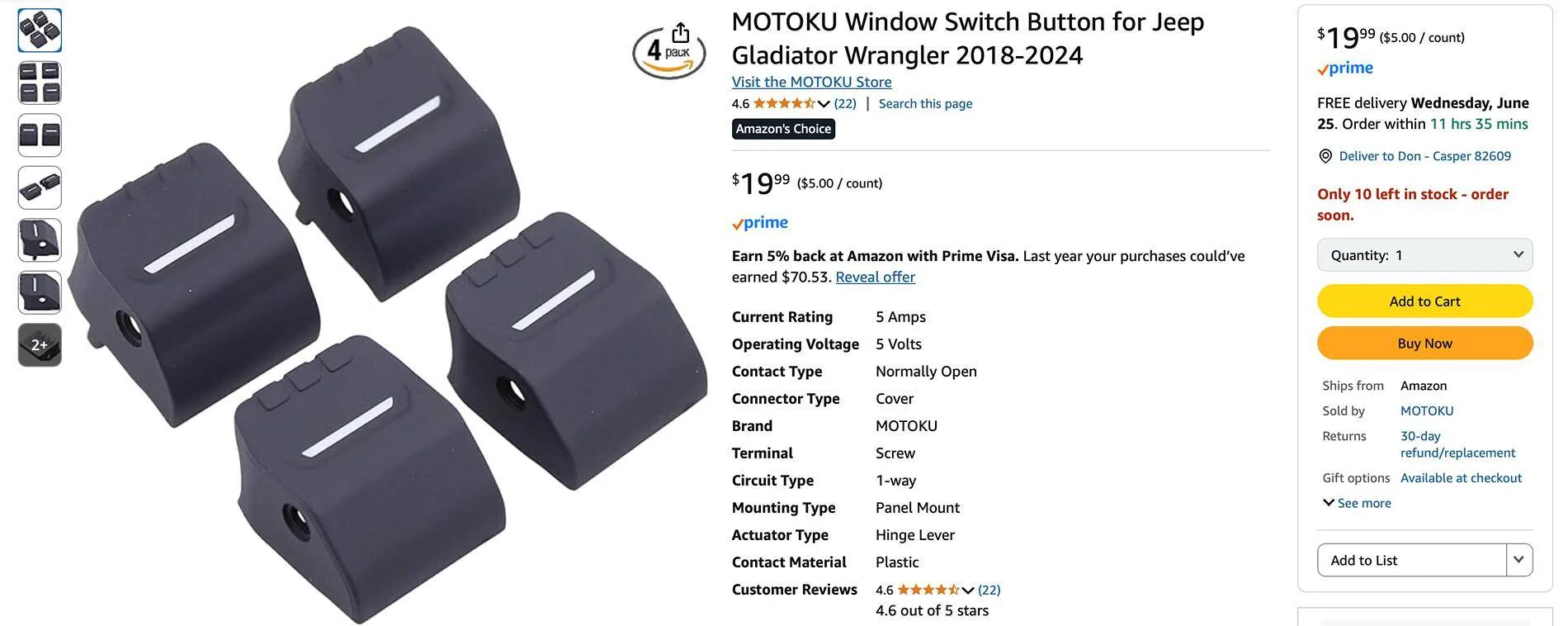

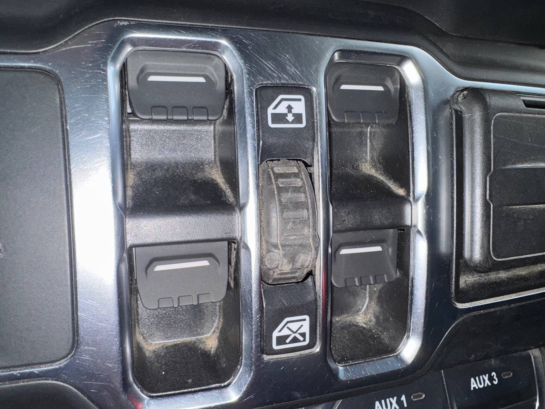

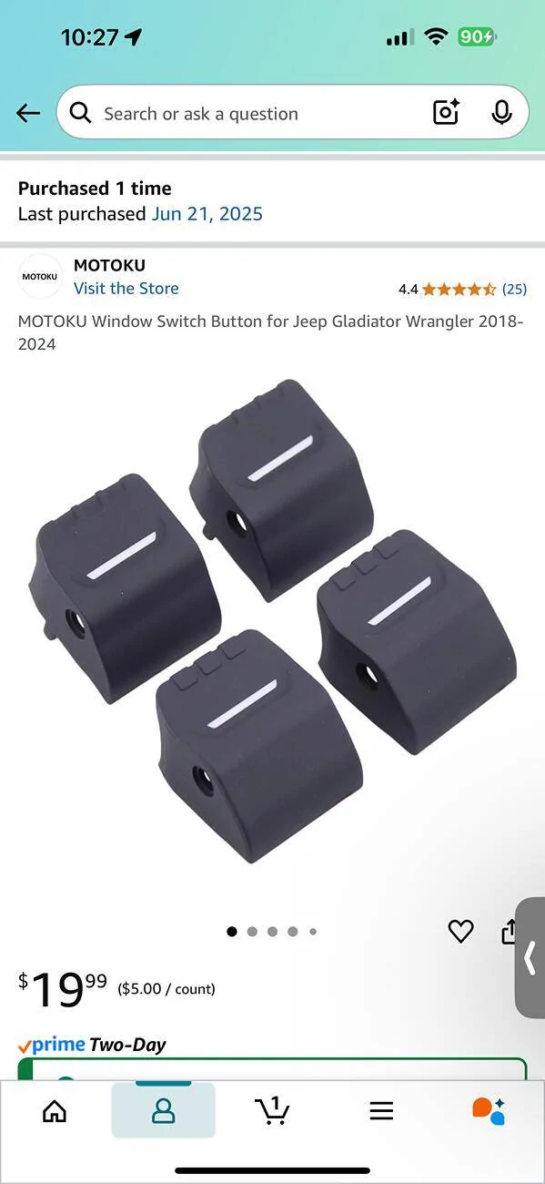

The product is flawless. Fits perfectly, texture matches original, clickiness is spot on, looks like the original buttons.
The two buttons with the tabs go on the bottom.
No need to take the dash apart. I used plastic trim tools to pry out the old buttons, and pressed the new buttons in.
