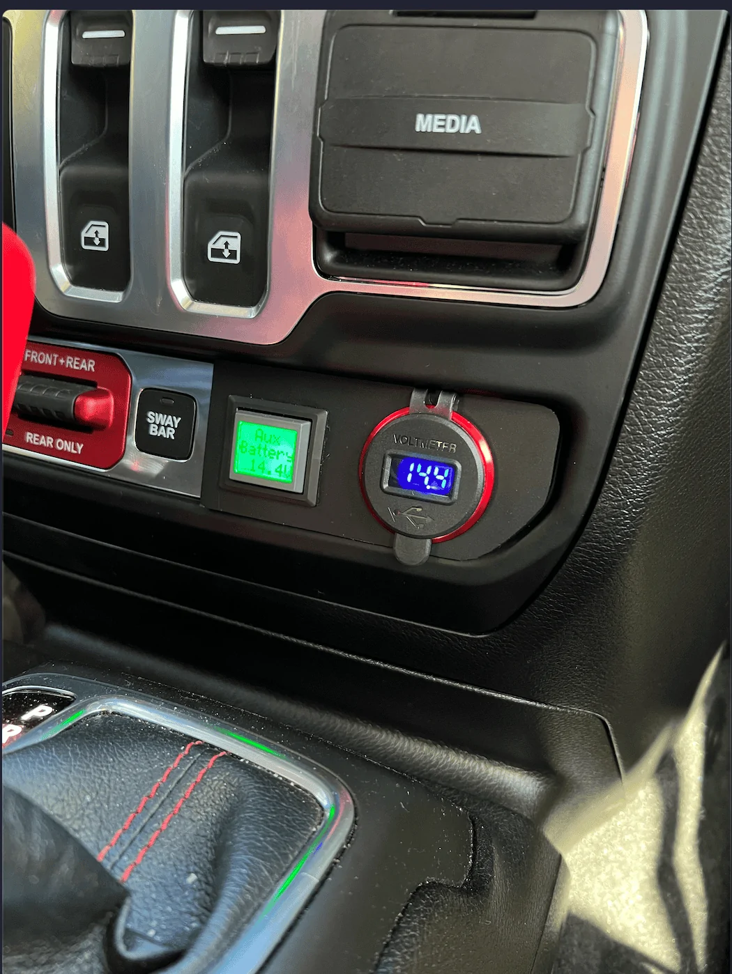

I have the dual battery and considered the power station.
I think it really comes down to the price and what you are looking to run/connect and the trim you have.
Have all my aux lights and soon will be running a small fridge. I do have a 2 door so space was a factor.
Went with the Genesis set up and SUPER happy with it. Not a day goes by where I feel like I regretted the purchase.
I also went a little overkill with the volt meters haha; added the G-screen from Genesis which I have set to see the AUX batter voltage and also added a charge port that also has a volt meter which shows the main battery(bought it in red and matches the locker switches almost perfectly).
Also, another benefit from the G-screen is that I am able to jump start myself from inside the cabin should my crank/main battery die.
Jeep Wrangler JL Power station vs dual battery Screenshot 2023-02-01 at 2.32.25 PM
You can't go wrong with either set up.
