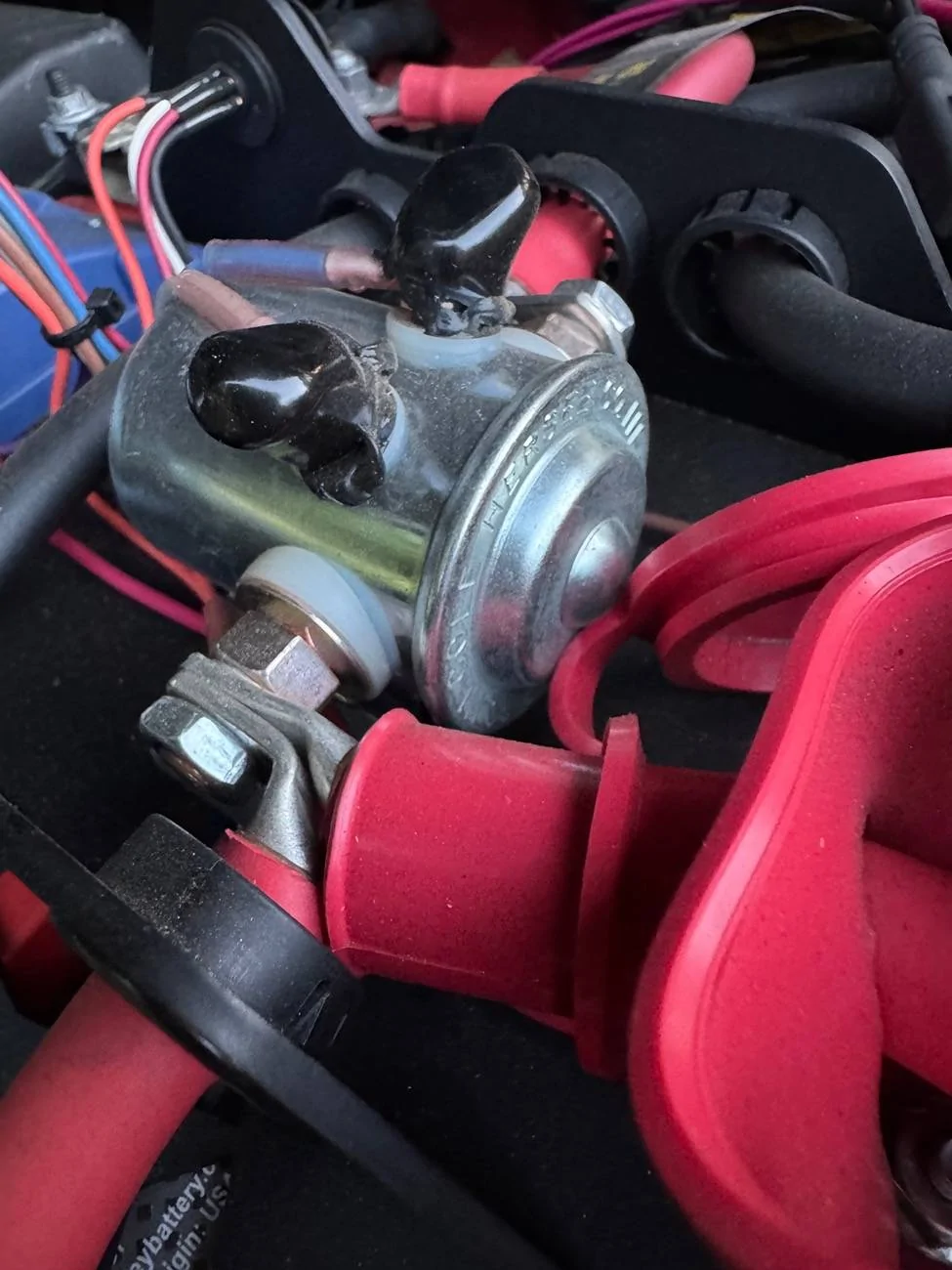

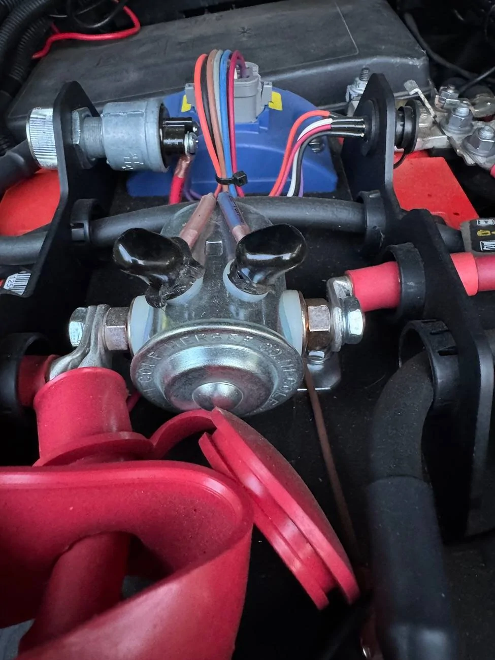

I installed the Genesis dual battery system a few years ago. Since that time my biggest challenge has been keeping a charge on the batteries. I’ve been working a lot, so the jeep lives in the garage on a battery charger. I’ve been using the Noco 10 amp smart charger, but it doesn't keep the jeep start-ready, whether I connect it per the Genesis videos, or connect it to only the starting batter. It’s appears that the charger will charge the battery up to a point, then turn off, so the battery will be dead again in two or three weeks (or less).
This evening I jump started the jeep to take my wife to dinner. When we got home I let the jeep run for another 30 minutes or so to improve the charge. Ten minutes into that I noticed a terrible stink — like sulfur or rotten eggs. I popped the hood and saw smoke coming from one of the batteries. (See video) I pulled the jeep away from the house and disconnected both grounds.. The rubber caps on the solenoid are melted too. I’m at a loss as to what caused this or how to fix it. Any ideas?

Were they new batteries when you installed the Genesis kit? I think one of them might have been bad from the get go and is now failing in a dangerous way.
It's hard to say without looking at it but I'd start with the following.
  1. Remove and load test both batteries. See if one of them (likely the smoking one) is bad bad. i.e. has an internal short.
  2. Triple check the Genesis wiring to the wiring diagram. Years is a long time to go with incorrect wiring but it could be possible. Never hurts to re-check and confirm.
  3. Replace the solenoid. I don't have the Genesis Dual Battery kit, just the Aux relocation kit. I assume the solenoid is between the two batteries and connects/disconnects them. A lot of current went through that solenoid and you should assume it is now compromised and dangerous to use.
But again, I'm guessing here. Can't be certain about anything without examining the wiring physically or with a multi-meter.

Given that the boots on the low-current contacts of the solenoid melted, it's possible the internal coil was/is damaged. I'm not sure how that would cause or be caused by a smoking battery - could be unrelated and just the result of running hot over the years. The battery likely smoked because it failed due to age/damage.
Replace the batteries (immediately stop using the battery that smoked) and swap the solenoid for a REDARC BCDC. A smart solenoid is outdated technology anyway; a dedicated DC-to-DC charger is the modern way to run a dual battery system.

So I took both to Batteries Plus. One was fried… showed 2.3 volts. The second one showed 11 volts.
The only AGM Group 25 option I could find within 80 miles was the Optima red-top. I had to drive about 120 miles, and bend over the desk for a sound beating on price, but I now have two new batteries in the jeep. I fired it up, backed into the garage, and disconnected ground cables until I can figure out what’s wrong and replace the solenoid (at least).
I’ve had lots of Jeeps, trucks, and boats with dual batteries. It’s a great reserve, but I’m not sure the trickier features of the current system are worth the hassle for me.
