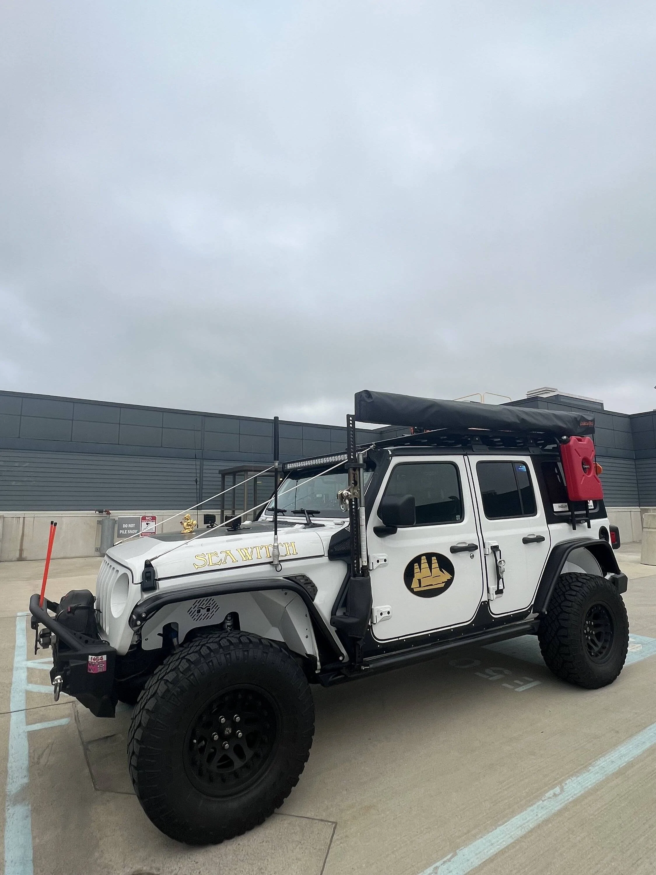

I have almost $200K in mods on this. I can’t just trade it in.
I don’t know squat about your overheating issue, but I don’t think any of us are going to glaze over that statement. I didn’t know anything remotely close to that was even possible. A build thread with photos is definitely in order.

DETAILS!!! I don’t want to derail your thread about your issue, but start a separate build thread. Good luck with the overheating.
