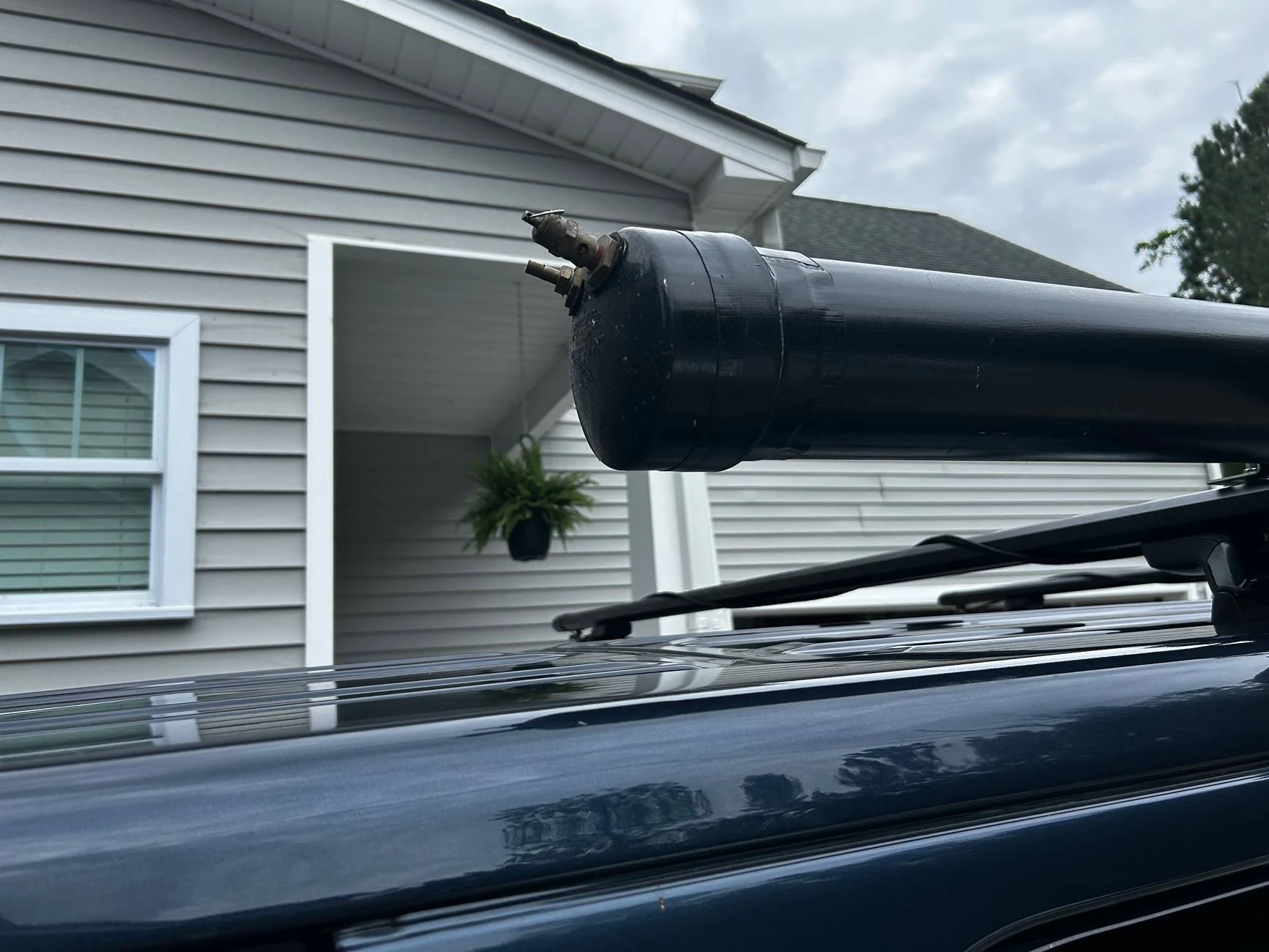

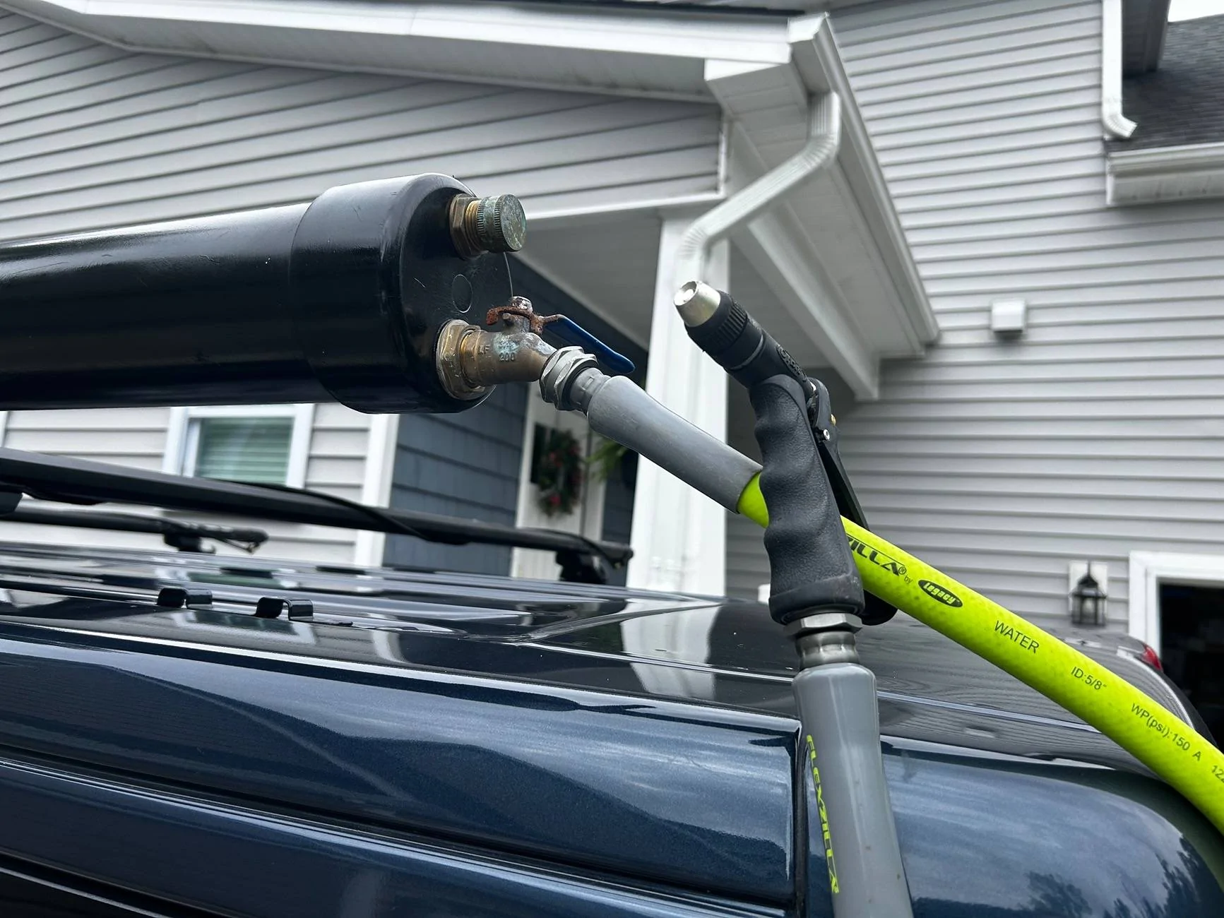

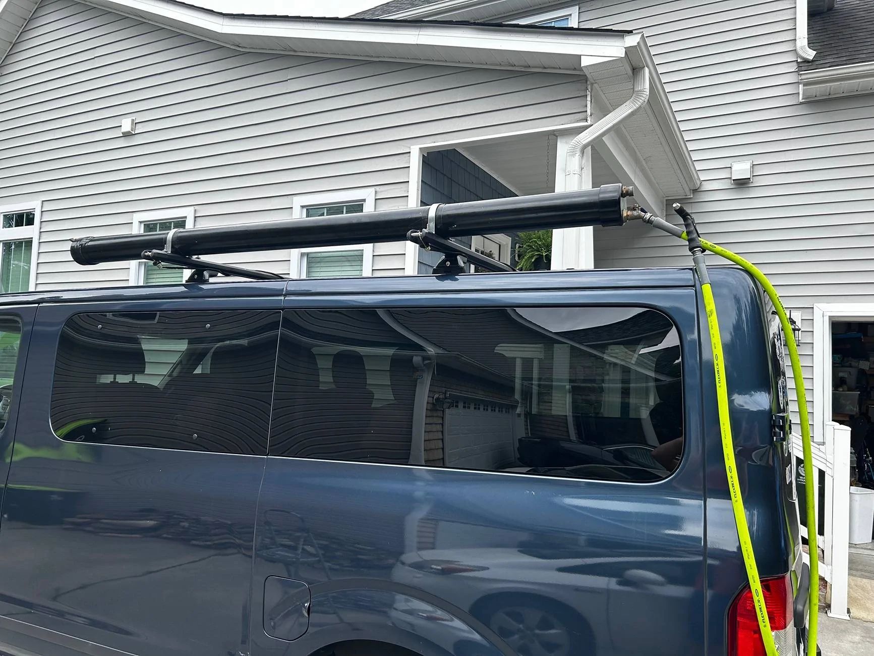

I just bought my JL about a month ago, so I don’t have a roof rack on it yet. But here’s my solution that we use on the family van for beach trips and camping.
Jeep Wrangler JL Portable shower ideas? IMG_2906
Jeep Wrangler JL Portable shower ideas? IMG_2907
Jeep Wrangler JL Portable shower ideas? IMG_2908
I have about 8’ of 4ā€ schedule 80 PVC. It holds about 5 gallons of water. It has a schrader valve on one end and I hook it up to a cheap $25 compressor from Amazon to pressurize it, and there’s a pressure relief valve that’s rated to 40 psi so that it doesn’t turn into a bomb. Painted black so that the sun warms it up a bit. Altogether it was under $100. Or you can get the prettier version for more.
