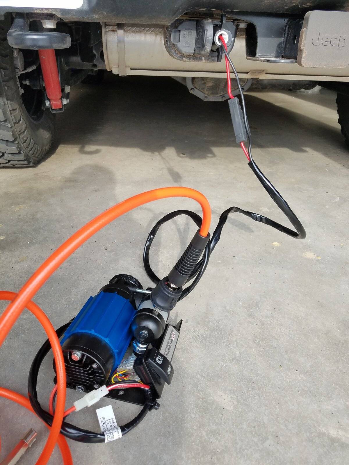

Rigged up the trailer plug on the ARB portable... seems to work OK, though I only tried it on one tire and a partial air-down and re-up. We'll see what (if anything) happens when I run all four back up some time... but for now it is a tiny accomplishment of convenience. ?
For the time being I kept the battery clips and stuffed them in my misc bag o stuff in the Jeep in case this fries a fuse when I really put it to work on all four tires. I can always splice 'em back on and clip to the battery.
Inspired by another forum member here, I also did this with my Viair.
I put a 45A Anderson connector on the end, and the same on the original battery clamps and a tow connector, so I can switch between them as needed, e.g. to use the compressor on another vehicle. It has been very useful.

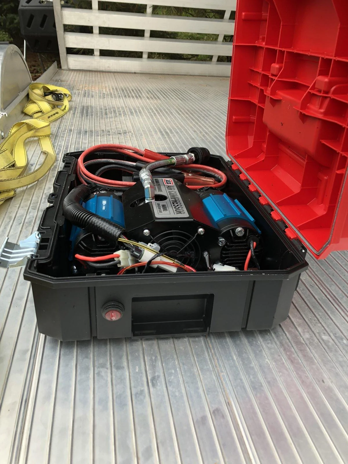

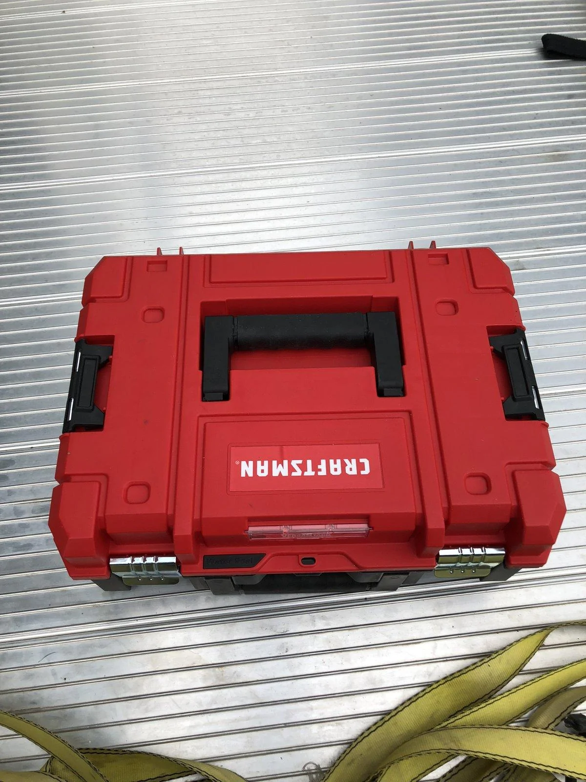

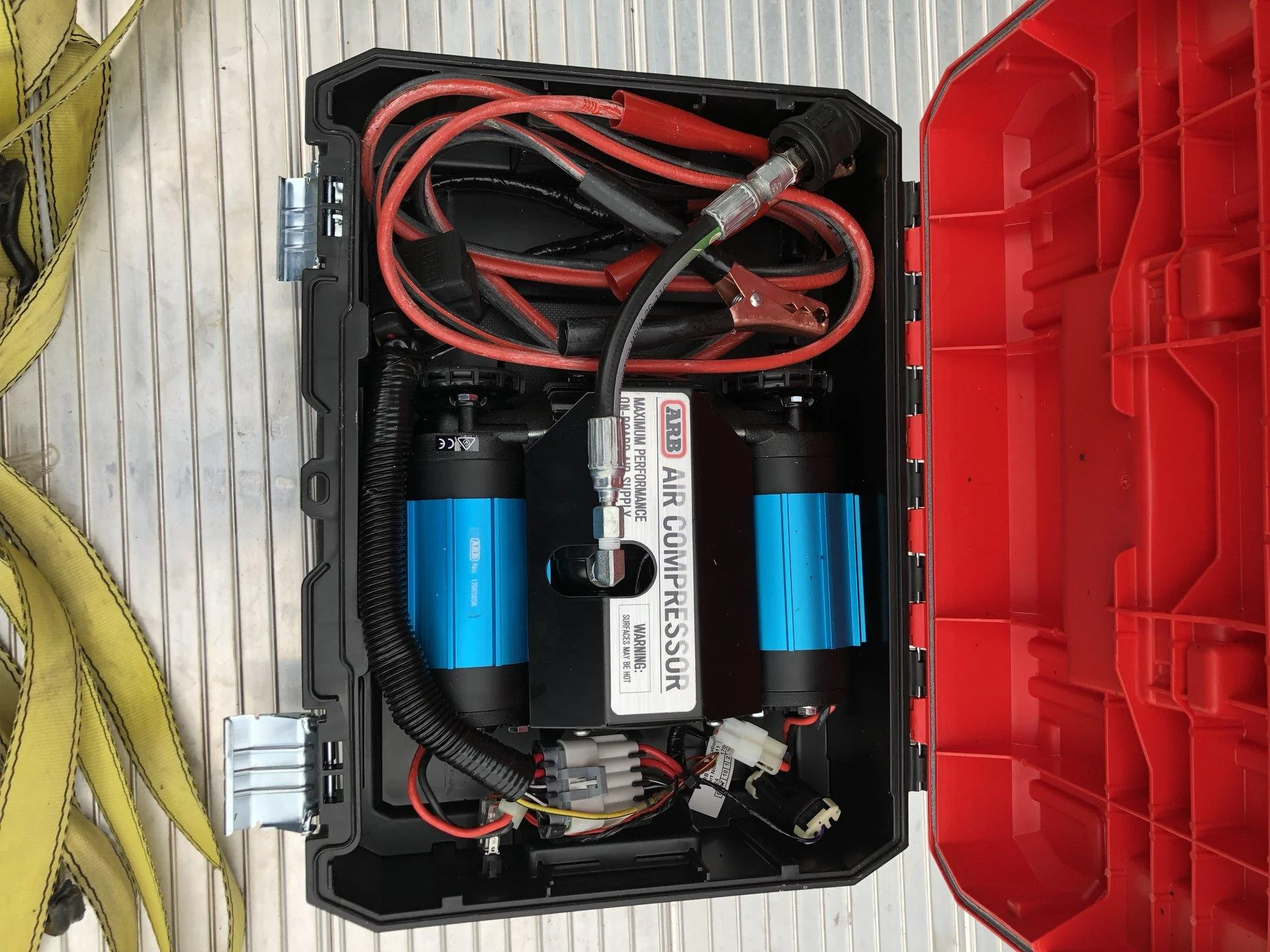

Do you have a parts list of what you use? Trying to save some money, instead of buying portable kit
Unfortunately not. I just found that box at a closing Sears store and had some cheap jumper cables I cut the other end off. That’s really it.

In the FWIW dept... I just picked up an ARB single portable unit and promptly ripped it out of its plastic box. Until I settle on a definite mounting for it, if ever, I will keep it in a stuff sack behind the driver's side seat - it fits nicely there in front of my Goose Gear platform support, and I can move it about if necessary or to another vehicle.
The ARB box is a nice touch if one has room, but in a camping Jeep the way I use mine, the box was too obnoxiously large and rigid. I went with the portable because I can still mount it in various inside places if I wish, and it comes with the hose, etc. I will likely run battery power to a terminal strip for both the compressor and fridge at some point, so the ARB wiring harness was less a draw for me.
In the mean time, I think I will also chop off the battery clamps and use a 7-pin plug to draw off the trailer outlet I have as someone suggested here. Saves opening the hood. (admittedly not a big deal, but mods ModS MODS!!!)
I know this is an old post so I’m hoping I get a reply. I’ve been looking at wiring my portable arb dual to a 7-pin plug also. My concern is about how much power it draws.
does This option work? I don’t want to chop the wiring for nothing and then have to rewire it back to stock
