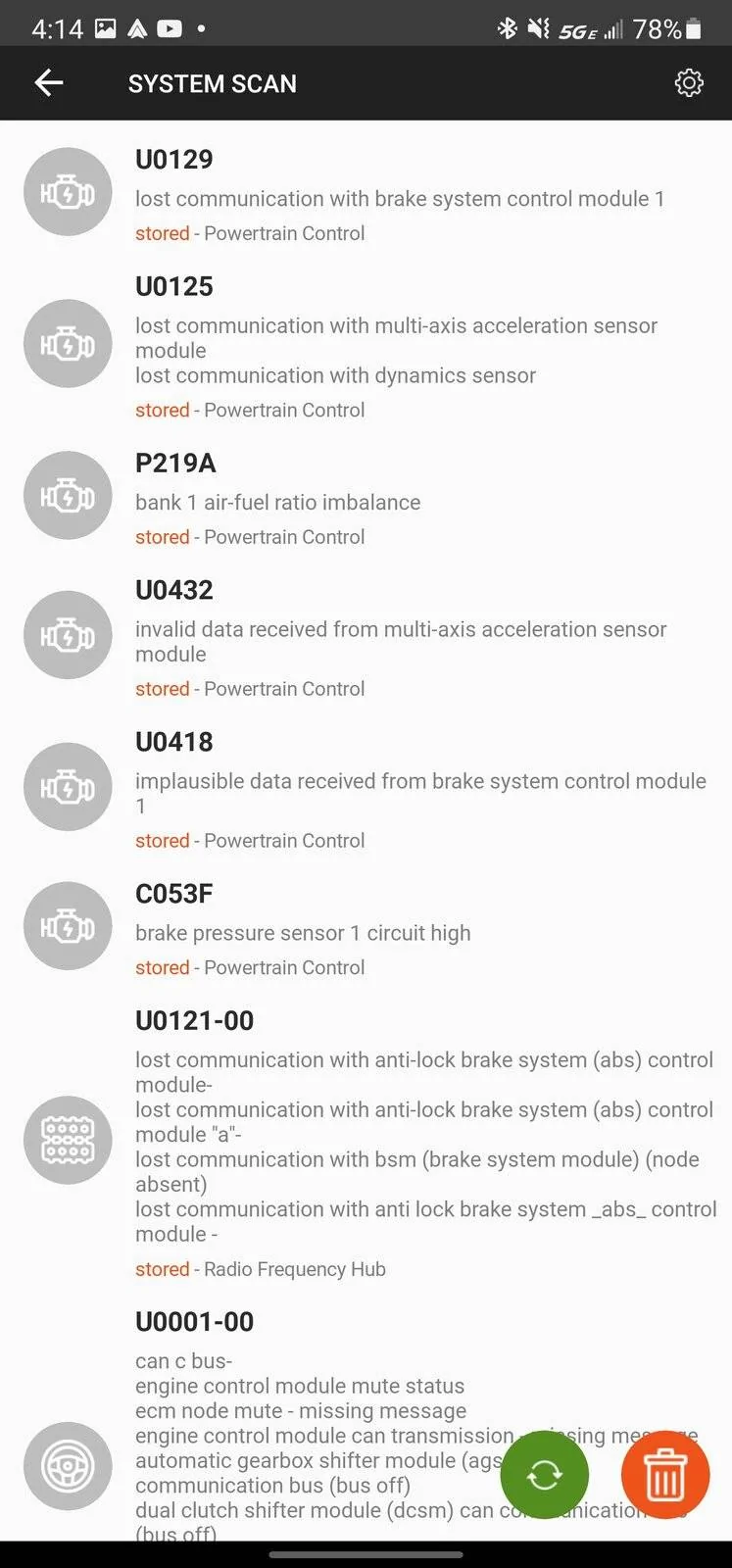

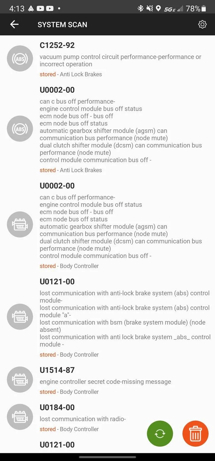

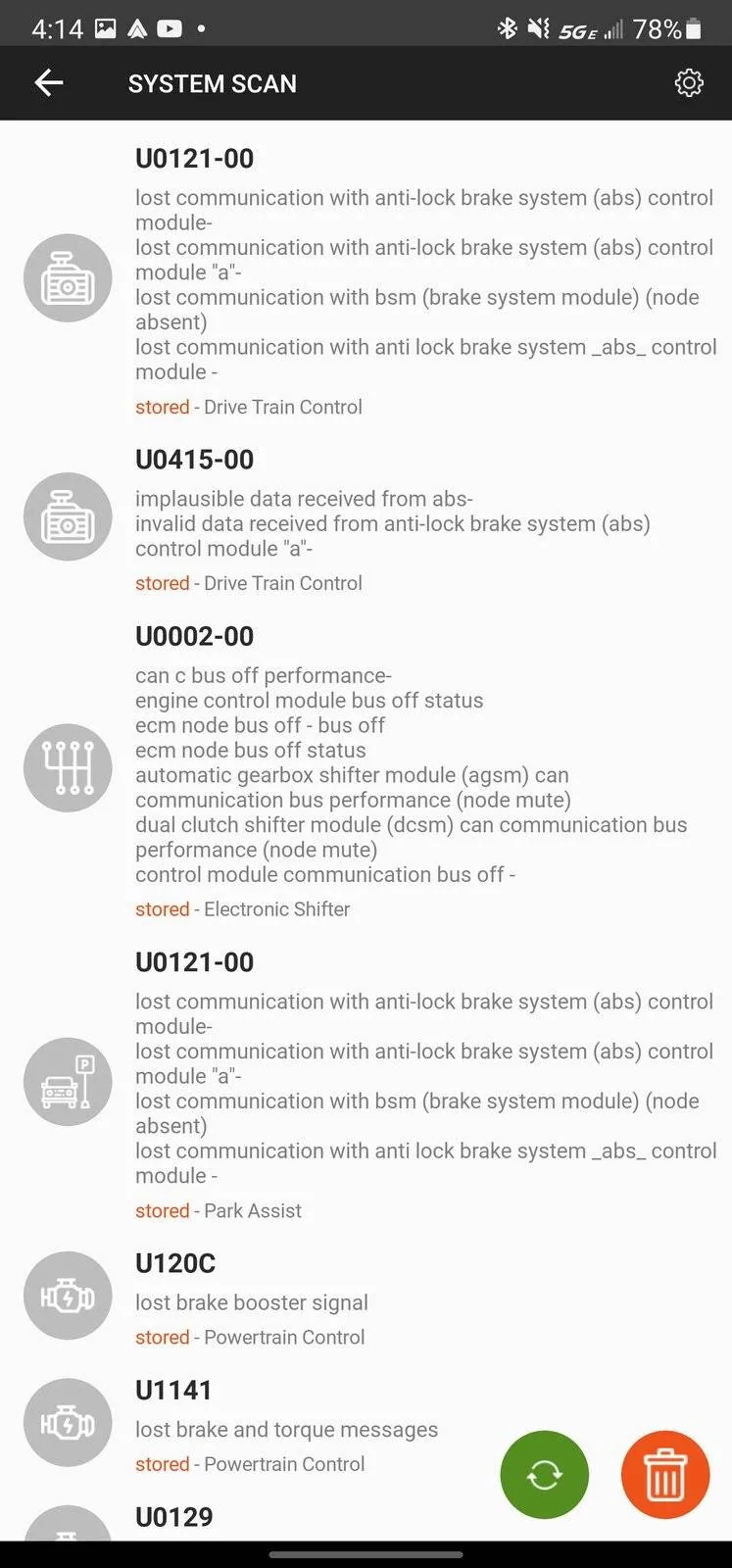

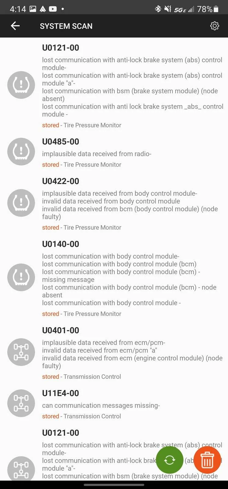

Has anyone had any of these codes come up? So when in driving or even stopped my abs, brake, traction stability, serive shifter, service 4wd. Warning lights all pop up. Has anyone had the same issues what was the diagnosis

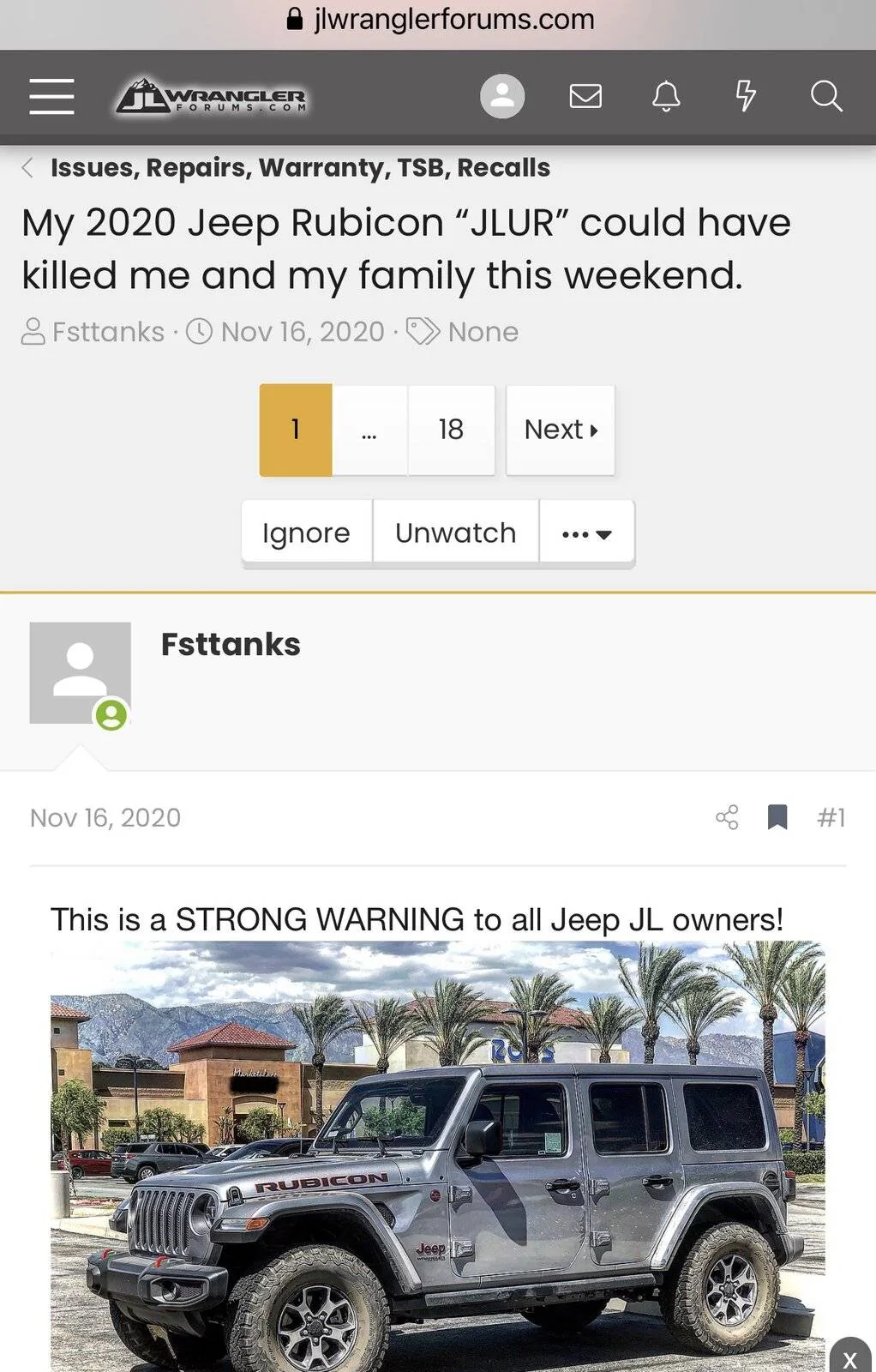

YES all of those and more. Our 2020 JLUR was just bought back by FCA because of the issues. FCA could not determine the causes, though it was highly suspected that a number of improperly seated fuses caused multiple shorts and malfunction. Once the damage was done there was no “cheap” or reliable way to fix the issues.
I have a lengthy thread about it here on the forum.

Update: so my jeep got looked at for a few days at a shop they played trial and error with the modules on can bus c. They believe the tpms module is the issue causing everything to fail. In which the tpms module is one of the only ones that isn't inside of the car this module is located on the bottom of the jeep. So chances it could've been contaminated with water/mud is very likely. So that is unplugged and haven't had issues for 3 days so far. So keeping my fingers crossed 🤞

Okay update jeep lasted 2 weeks with replacing the tpms module. Then it started doing its problems again. So then I left my jeep with my mechanic for a month. We tried replacing the anti lock module. That lasted a few days with no problems. But like before the dash once again lit up with the same problems/codes.
Then he ended up finding a forum some where, where the guy was talking about the same issues but he would hit is glove box and they would stop. Come to find out there is a spot where all of the can c wires plug into behind the glove box. So my mechanic replaced that. Also said that it took a half hour to unplug the wire because they were stuck in there like it was sticky as if someone had spilt something at one point. So far haven't had problems since replacing the can c part. Hopefully this can help someone. It really could be anything since they are all connected. The biggest part of the problem was it was just a bunch of trial and error.
