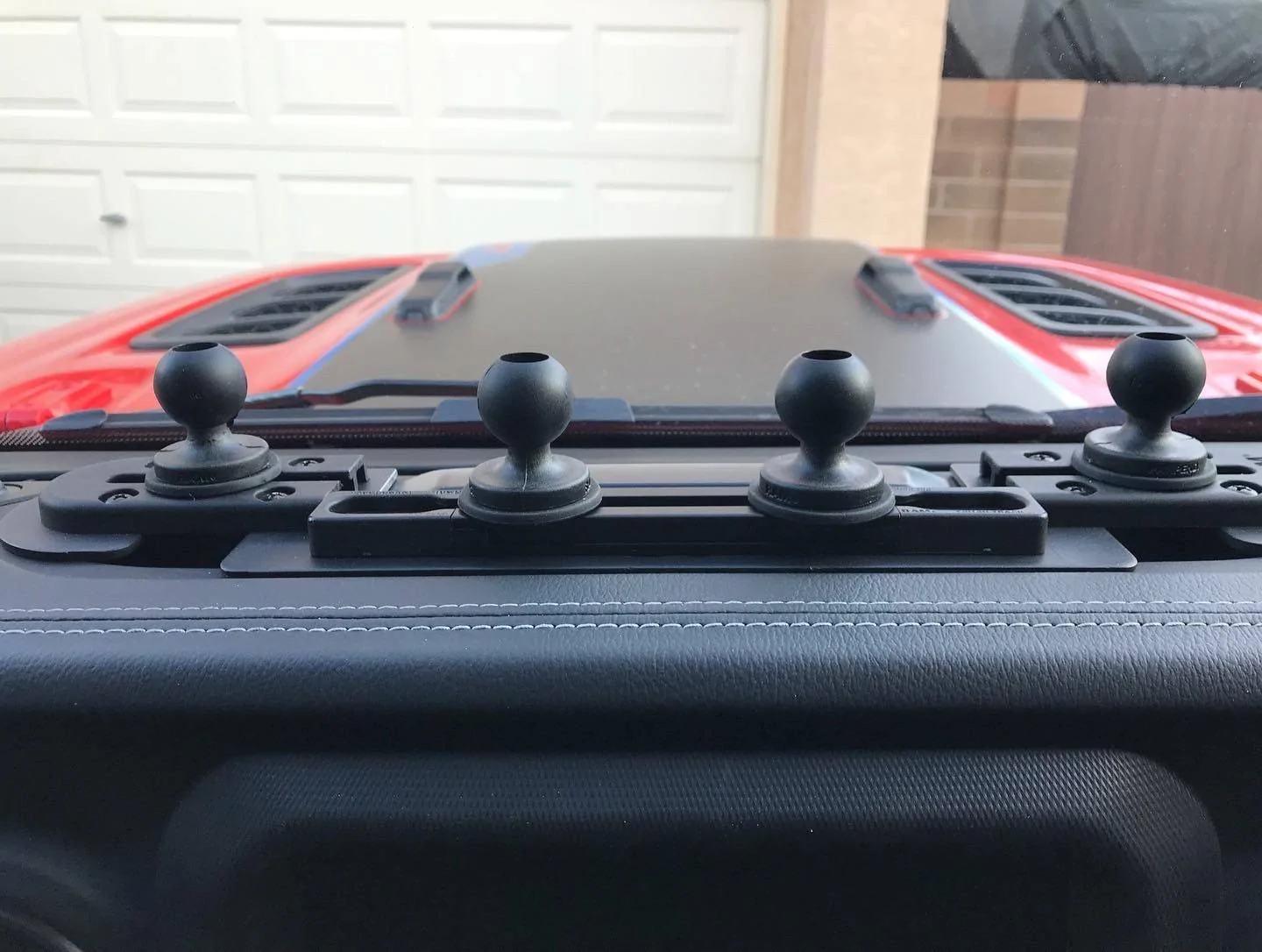

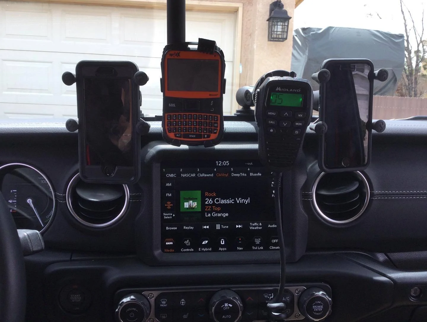

Nice job on yours! I like the short oval mounts. It gives it a nice finished look. I think I will order a couple of them.
I’m with you. I am heavily invested in RAM mount products. Here is mine finished.

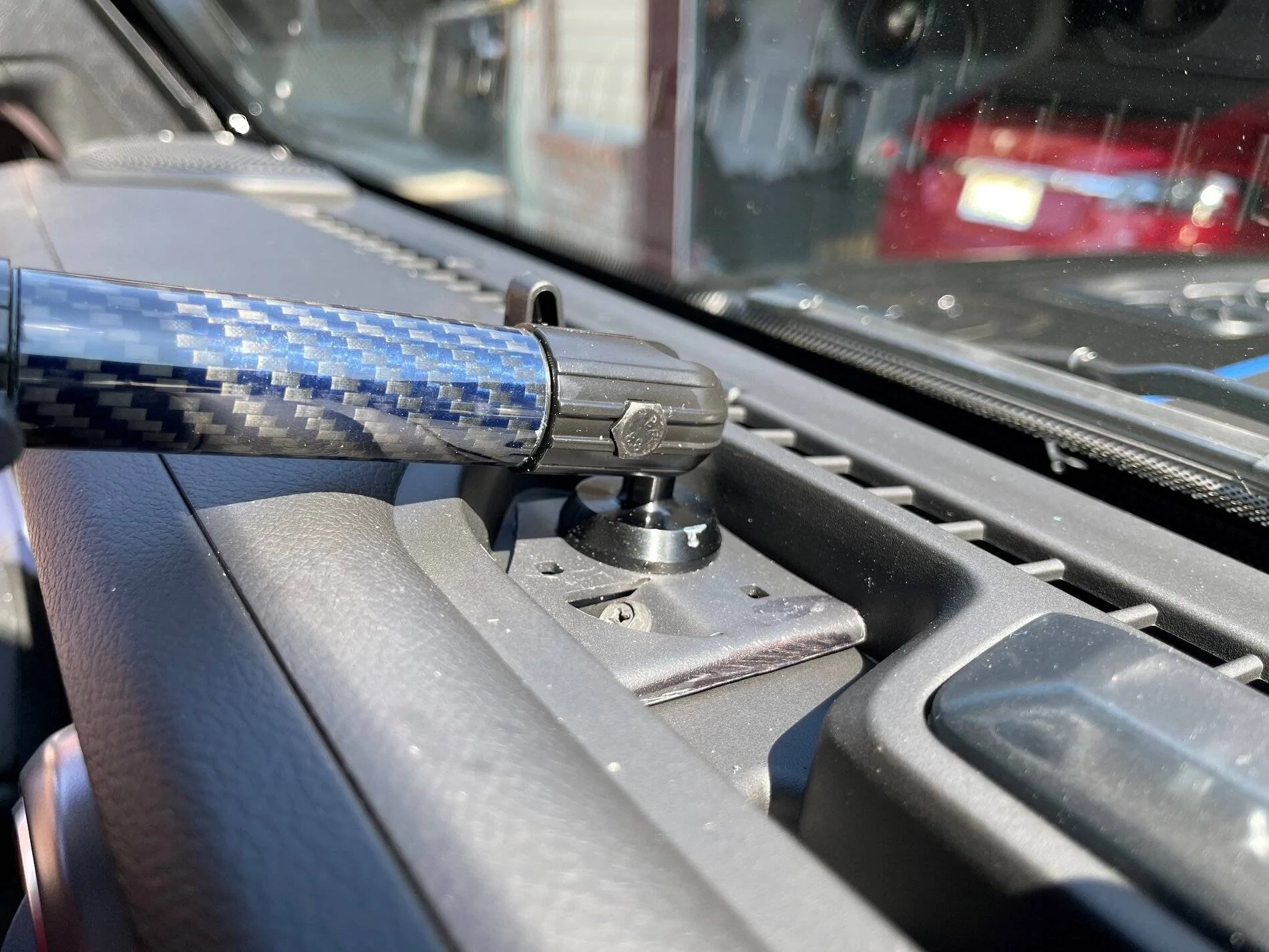

Mine worked and I didn't mod or cut?
As most may have noticed the the dash tray has been changed on the 4xe to accommodate the LED charging light array so most if not all of the on dash phone holders will not work. I Purchased the Bullet Point Mount which is basically a 67 Design Knock off except 1/2 the price.
Bullet Point Phone Mount at Amazon
Let me start by saying is is a quality mount that is all metal construction and will handle the trails well.
Anyway. The mount does not fit the 4xe without a minor modification. Pictured below is the base and all you need to do is cut 3/8" off the base leg, this will allos it to lay flat and fit the 4xe dash tray. That is is simple hacksaw job and you are good to go.
Becasue that was 2 Years ago 2 weeks after the 4xe was released, now manufactures have modified thier products.
