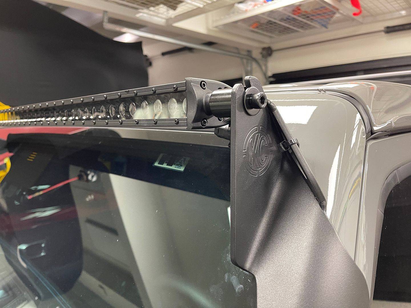

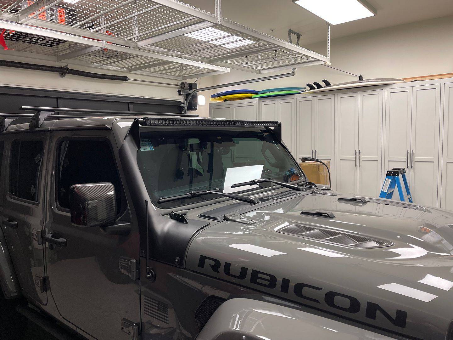

I figured I can deal with some wind noise, this car is loud anyway so I’m ok with it.. we take it to mountains frequently 400 mile trip each way and doesn’t bother me.. the mods to the bar helped for sure, without them it was unbearable. Those rare occasions that we use the car the lighting output it just insane ?
it looks great on the hood too, may eventually try that as well since the electrical feed is plenty long without having to shorten it :)

i bought the KC 4xe mount and combined it with RC single row bar.. I wanted something more sleek). Initial problem is that KC mounts are wider than 50" and RC bar is lightly shorter than 50".. so i had some aluminum spacers made which are now powder-coated wrinkle black. Main issue here is the noise. Both wind and whistle noises were out of this world at fwy speeds..(70+) (typical cruising speed here is between 70-85)
I expected both noises but not at these levels.. so i took it off and going to make some adjustments to back cooling fins.. read bunch of posts from JK guys doing everything from vinyl wrap to door moulding trim.. as others pointed out there is no way its going to be as quiet as stock,; impossible with such flat object.. but as long as i can eliminate whistle i'll keep it :) Love the look and light output is insane.. I'll update once if i'm able to solve this issue

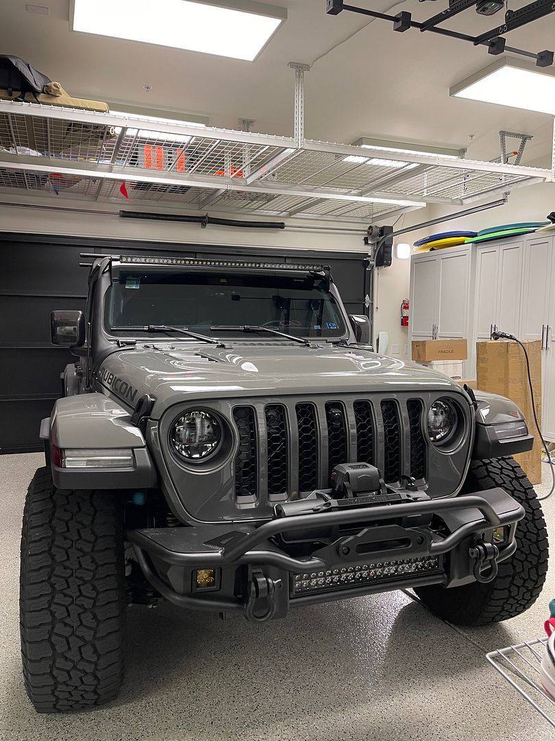

Hey man, do you mind sharing what bumper you have? I love the look!
