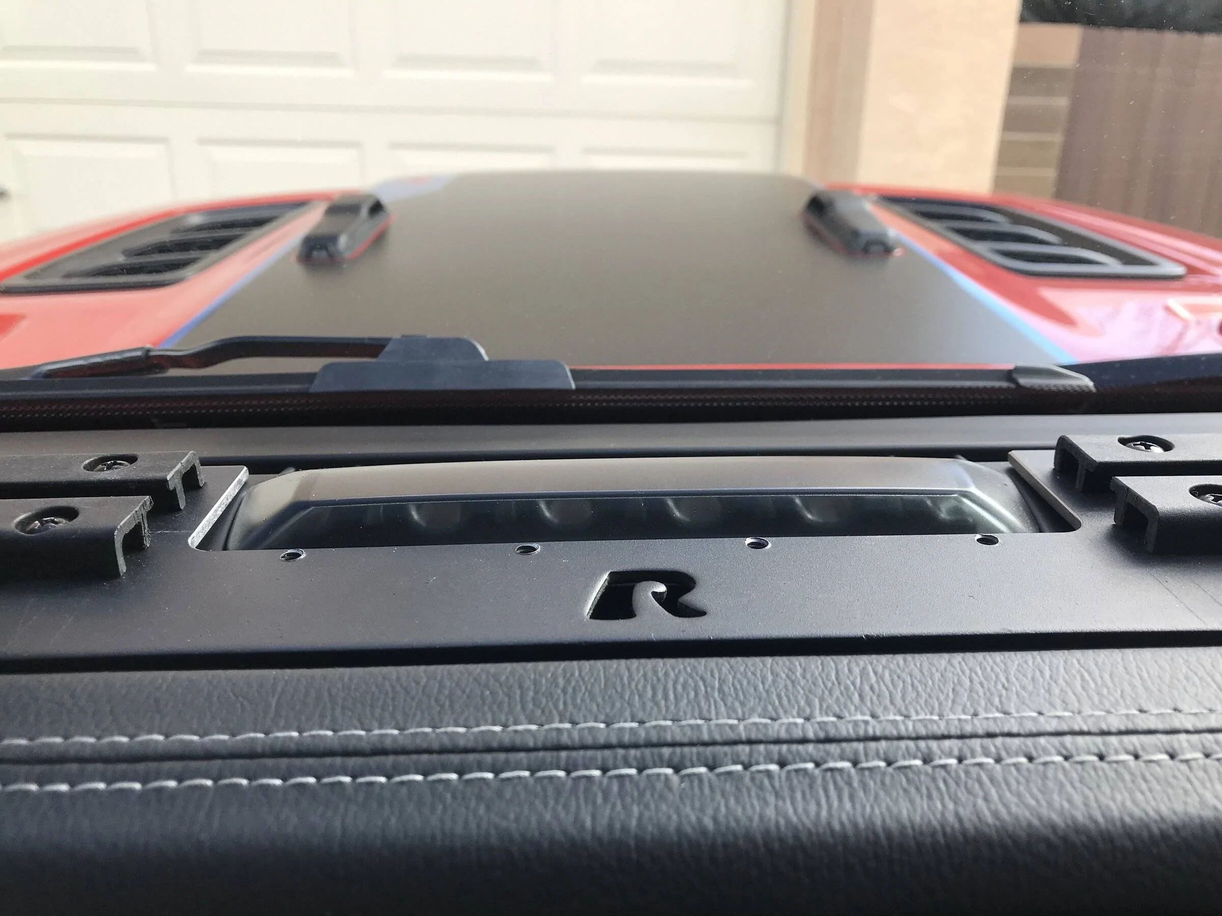

As most may have noticed the the dash tray has been changed on the 4xe to accommodate the LED charging light array so most if not all of the on dash phone holders will not work. I Purchased the Bullet Point Mount which is basically a 67 Design Knock off except 1/2 the price.

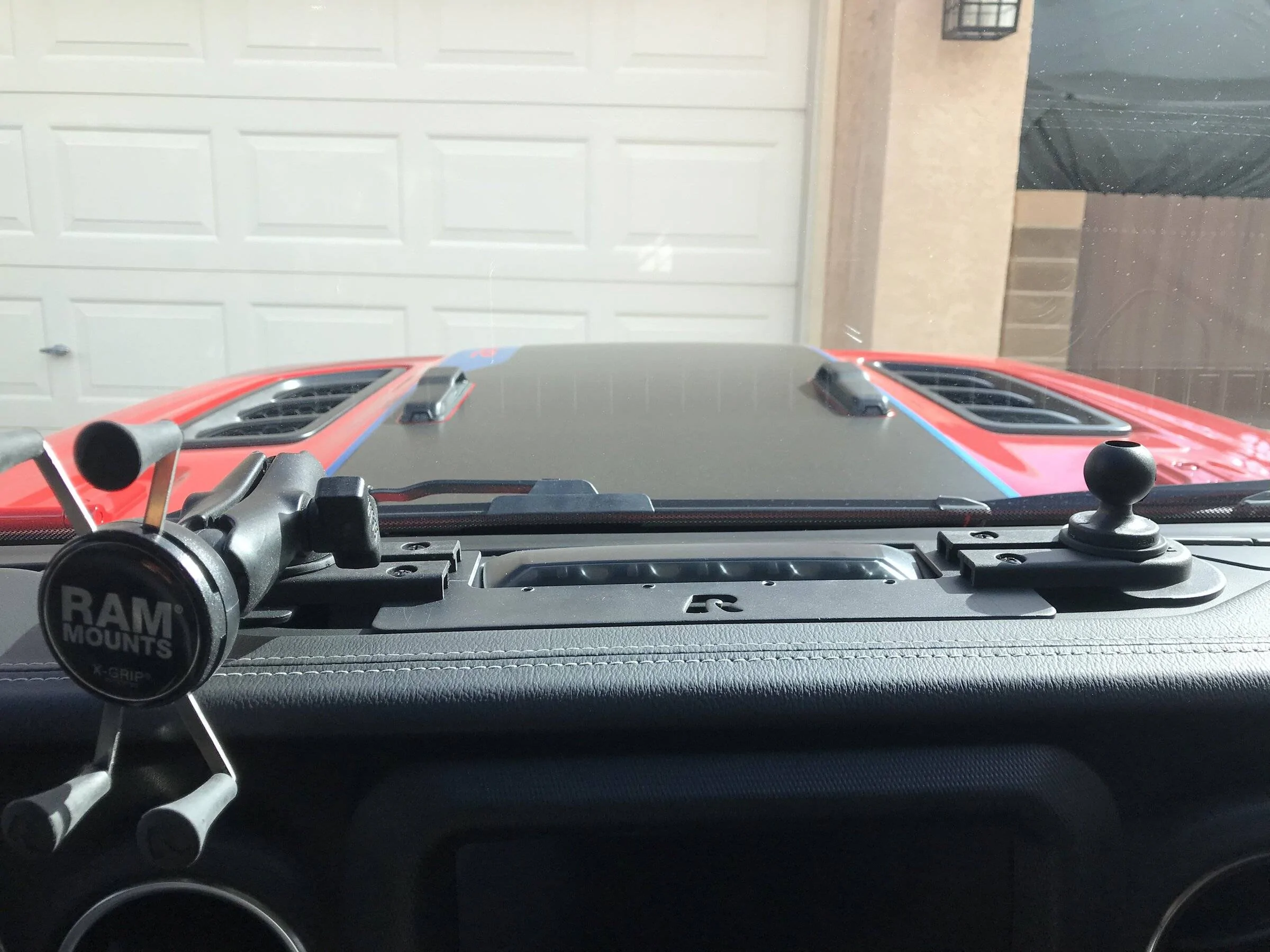

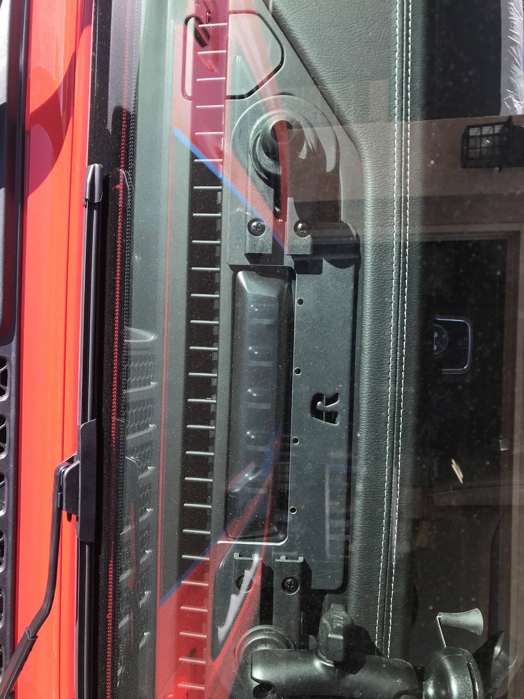

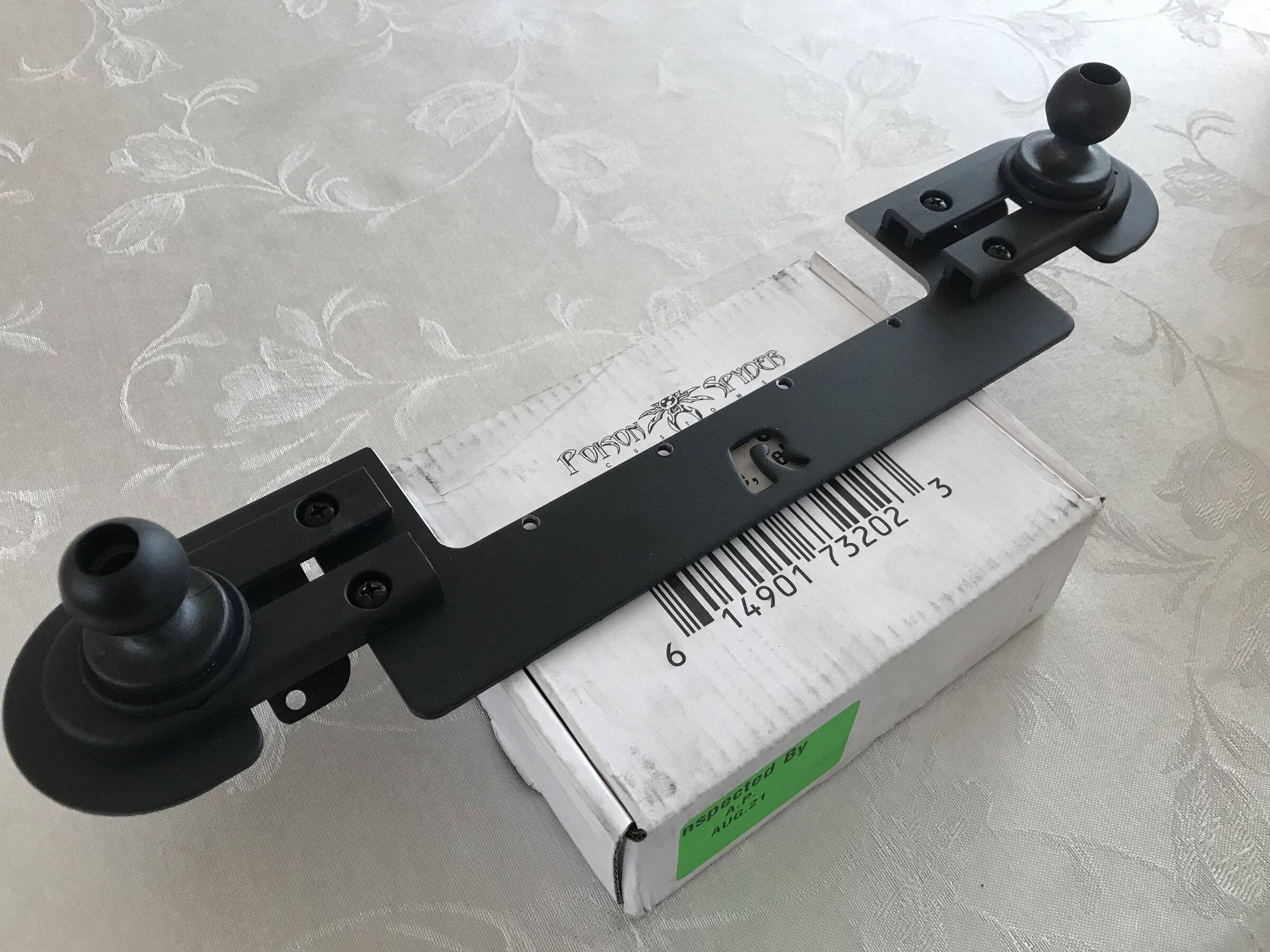

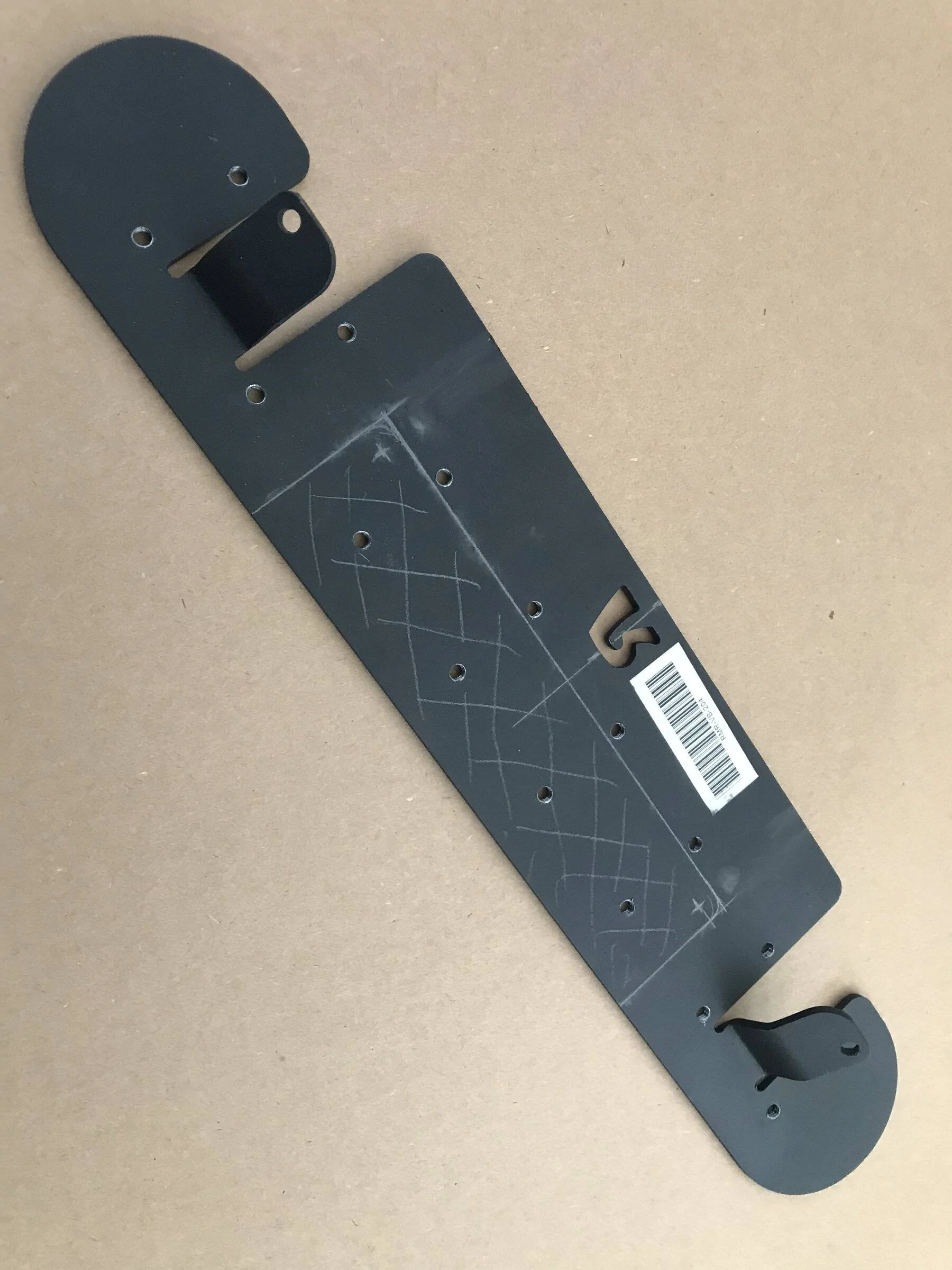

Anyway. The mount does not fit the 4xe without a minor modification. Pictured below is the base and all you need to do is cut 3/8" off the base leg, this will allos it to lay flat and fit the 4xe dash tray. That is is simple hacksaw job and you are good to go.
