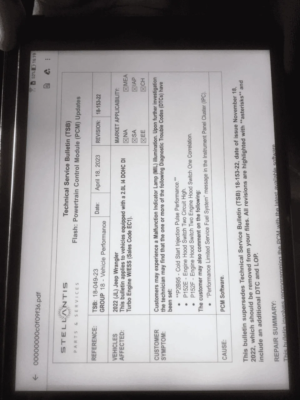

TIME TO GET FLASHED BABY!!!!
on April 2023 a service bulletin came from Jeep Europe, see attached. Erased the system and installed an updated one. Problem fixed!
Show this bulletin to your dealers and they will solved it once and for all! It’s been torturing me for whole 9 months :)))

Does anyone have a complete copy of the TSB and has anyone actually had a dealer perform the fix to their satisfaction?
