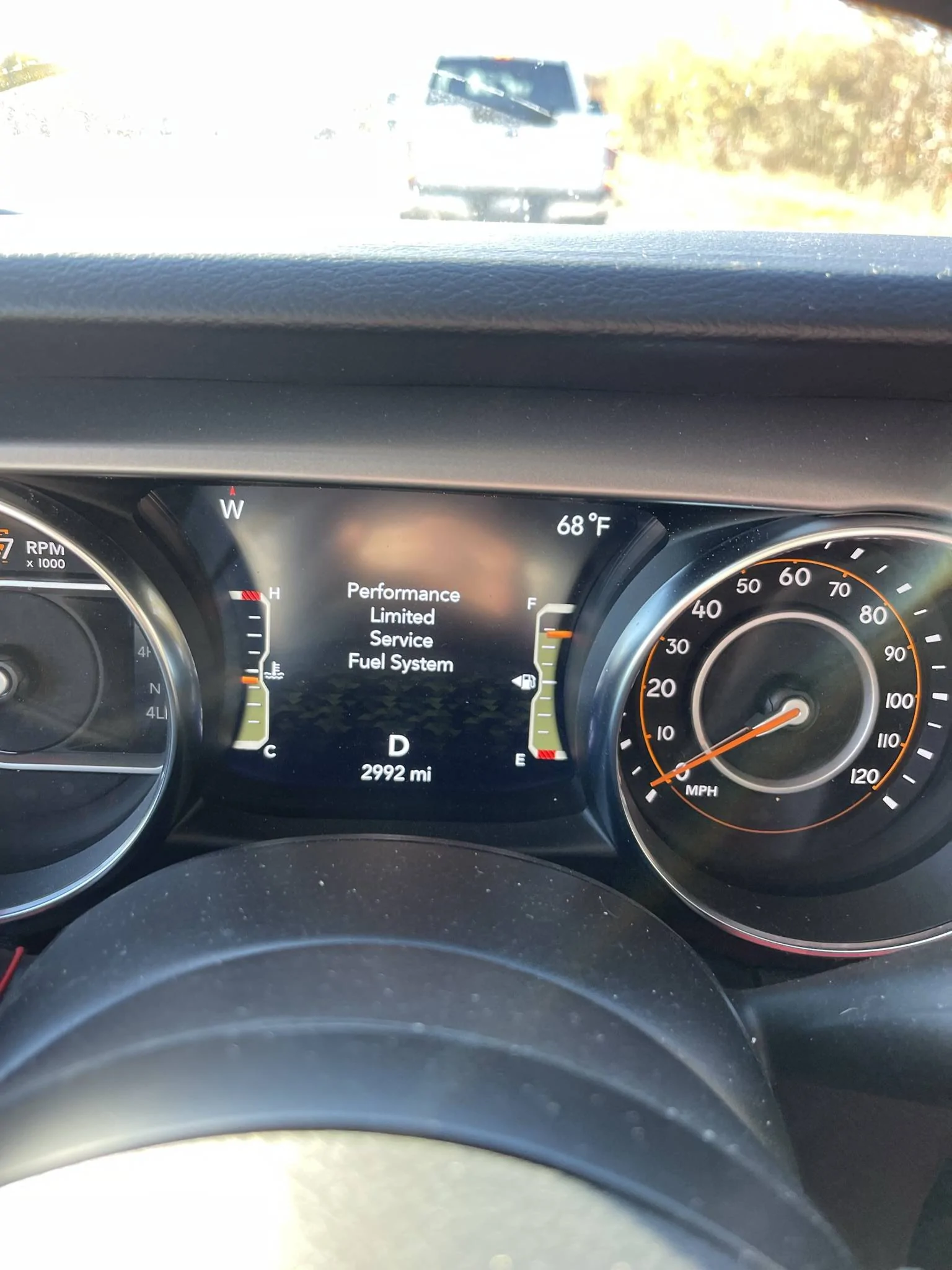

Another bites the dust …… Add me to the list I suppose. Yesterday about 3 miles after putting gas (87 Shell Gas since day 1) at 2774 mi, while making a right turn and decelerating the message popped up for about 10 sec then it went away. “Performance Limited Service Fuel System” I do have a Sahara 2.0L Automatic and this is the first time I see this happen. My Jeep is lifted with 35s what is weird to me is that I had a 2020 Sahara 2.0L Automatic with the same lift and 35s and I was getting about 19-20 mpg and in the 2022 I am only getting 16-17 mpg. Either way I’m taking in next week to the dealer and see what they say.

just to bring some more bad news to this thread, this problems lives on in the 2023’s. The “Performance Limited Service Fuel System” error message keeps randomly popping up in my 2023 Willys 2.0L. It only flashes in for 1-2 seconds and then it disappears. I only have 4k miles on it, and I first noticed the message around 2700 miles.
I've called 3 different dealerships in my area, and they all told me that unless it’s in the screen when I bring it in there is nothing they can do to try to diagnose it. And the best part is that They all stated that they’ve never heard of this issue, even after I gave them the Star case #. One dealer literally told me not to bring myJeep in and waste their time, unless the message was on the screen.
Note: I’ve gotten the message after using 87, 91 and 93 octane gas.
anyone have an update on this?

@Pancake_Willys are you actually losing power or performance?
If not, and with no CEL, it’s pretty much normal. The consensus is that it’s a product of the Wrangler shallow fuel tank and the fuel pump or pickup sucking in air briefly. (Usually during braking, slowing).
