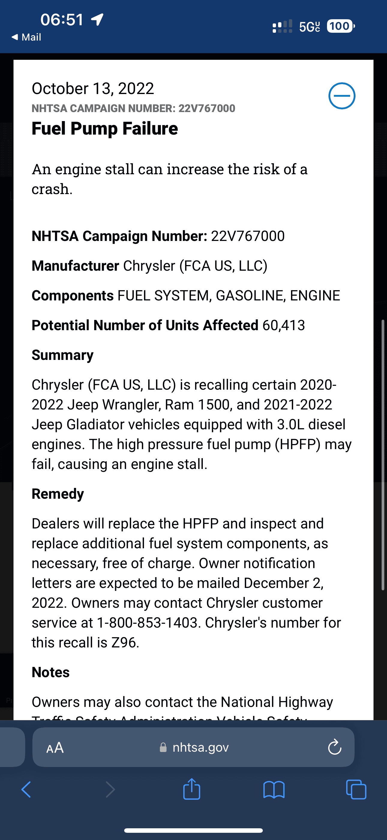

Update: Recall issued. My 2022 2.0 had this error message pop up a couple times but I’m not in the recall per my VIN.
NHTSA Recall ID Number :​
22V767

Jeep Wrangler JL "Performance Limited" Error code DDB06435-81C8-4A55-9E33-0A9F3BE53E50

That recall is for the 3.0 diesel. It does not affect the 2.0T gas engine. This is why your VIN is not listed for this recall.
Thanks. Weird that I got the email but I guess it was just sent to all JL owners and not just diesel ones.
Lol, under components they list it as gasoline but then go on to talk about the 3.0. I want the job of whoever is in charge of error codes and recalls at Chrysler. You apparently don't have to be good at it.
