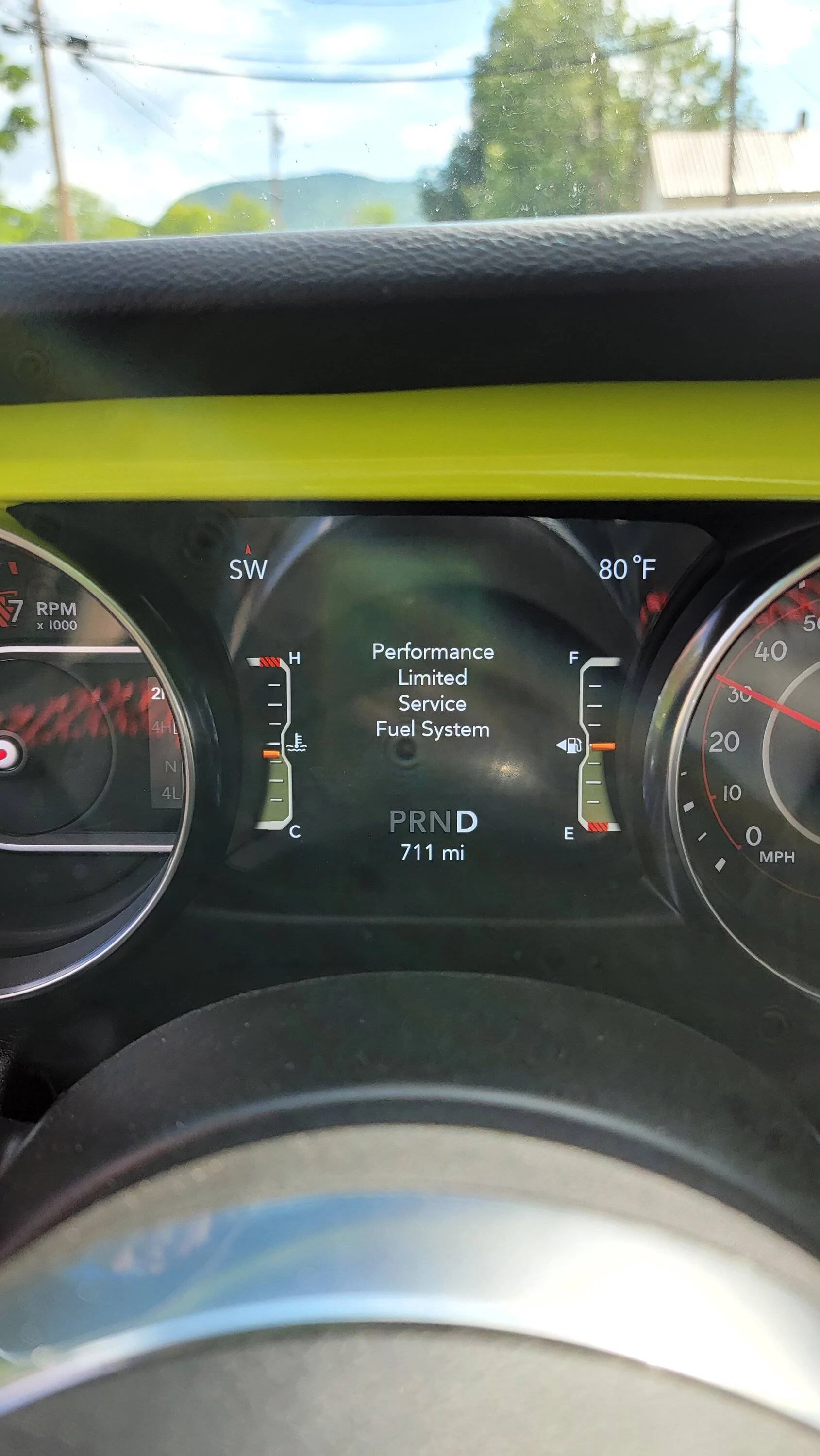

I saw it driving it home from the dealership when I bought it but it flashed so fast I couldn't read it. Happened slowing down for a stop sign. Fast forward 2 weeks and it comes on again last night as soon as I let off the gas decelerating from 55 on flat ground. Touch the gas again and it goes away. No performance issues felt. Definitely spooky to see in this brand new Jeep that cost me double what anything else I've ever had cost! 2022 Rubicon 2.0t.
Jeep Wrangler JL "Performance Limited" Error code 20220708_162718
