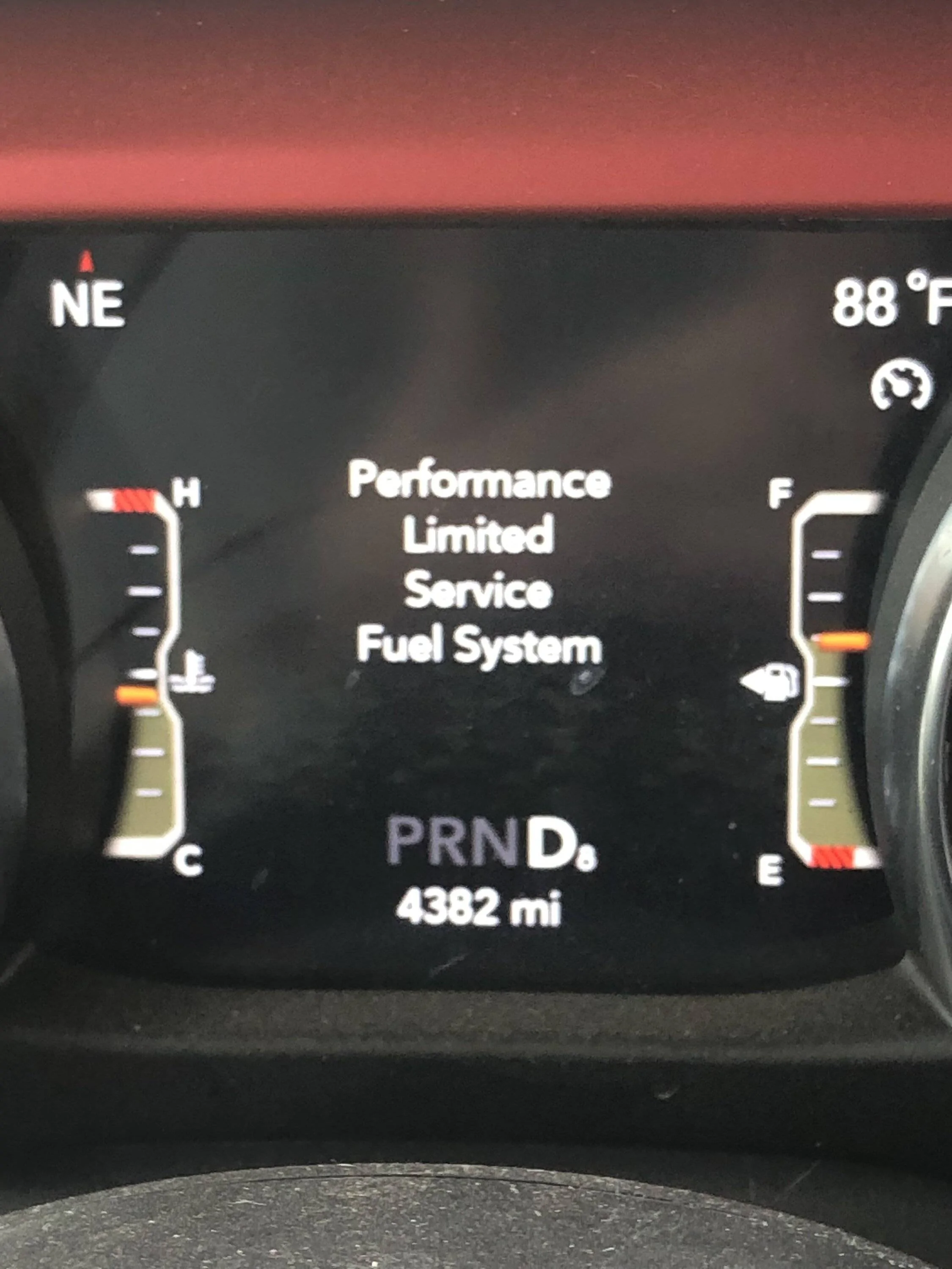

Welp, I finally got the code again. Last time I got it was the post I am replying to above back on 12 February. I am currently up to 5300 miles and this time the message "Performance Limited Service Fuel System" came on for a solid 10 seconds before disappearing. No other error messages or warnings. I live now at an altitude of around 4000 feet but the land is flat. I was cruise controlling at 55 MPH down a very straight road. I can't remember if it happened while I was cruising or after I hit cancel on the cruise control to coast towards a stop sign to make a left turn but the message was 100% there as I was slowing down and came to a stop at the stop sign. It went away just before I turned. There were cars behind me so I didn't feel safe taking a picture while coming to a stop.
Since last time, I drove all the way to New Mexico from up North. Had zero issues. I have been using 91 Octane Premium. My MPGs average around 23+ right now, I've been getting my gas from the same place (on base) for a few months now, and before, during, and after the message appeared, I didn't feel like my performance was limited. I was able to turn left and get back up to 55 MPH with no issues. I have drove that road for quite a while now going to and from work. First time seeing the code in months.
The sky was clear, there was a cool breeze, and the temperature outside was 65-70 F. I also never accidentally slipped into manual like last time. So in terms of weather or what gas I am using? None of it seems to matter. Last time it happened it was wetter, colder, and up North. I was using 87 Octane and would get gas from numerous places. Now I am in a desert where it is dry and much warmer, gas has been consistently from the same place, and a higher octane. Considering I have no performance issues, I am leaning towards the group that thinks it is software related or happening when they decelerate. This time though the message was on for a solid length of time compared to the flash of a second the first time.
I'll be bringing my 2022 JLUR to the dealership again eventually because she's got a squeaky noise that presents itself whenever I hit a bump. Before it was happening at 40+, now it is happen as low as 15+ MPH. I have not had time to troubleshoot it myself but the dealership couldn't find anything last time. Now that it is getting "worse" I am hoping they can find something and in the mean time, I can have them look into this code as well.
Another update for ya'll. Brought my Jeep to the dealership for a few things this past week. One of them being this issue we have all been discussing. They of course, could not duplicate it. Stated there was no STAR report out, no codes, nothing. So basically got told, thanks for your time.
Then literally the next day, I was cruise controlling down a road going 45 MPH. Up ahead was a stop light that is notorious for going from green to yellow to red within a very short time frame. And you know that small window where you either need to speed up or slow down to prevent running the red light? Well I always opt to slow down cause well I don't like accidents and as I was very firmly pressing my brakes, the error message popped up again. So for me, it 100% happens when I am deaccelerating. It only popped up for a few seconds, again, no error messages or performance issues.
What I find odd is the dealership telling me there were no STAR reports, despite this thread saying there is one, as when Jeep inevitably fixes this issue and has recalls as a result, I would like my Jeep to be known as one of them having the issue, albeit, not as serious as some of the others here. Maybe the STAR reports is a state by state thing? It is something I am unfamiliar with.
Anyway, that's my update so far. Attaching a picture for some proof.

Going down a grade today with cruise on. It downshifted to 6 to grade brake, which I didn’t want. So I canceled the cruise and shifted manually back to 8. Got this.
It remained on until I stopped coasting and reapplied throttle. Went off as soon as I touched the gas.
