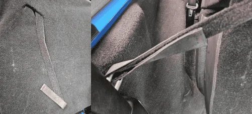

Use the Velcro straps to hold it to the anchor points behind the two front seats!

The key is to take the velcro straps, spin them 180, and attach to the tie down loops in the BACK of the jeep.
or if you want it tumbled all the way forward securely (not flopping around) you can use the same velcro straps to attach to the silver lugs on the B pillar.

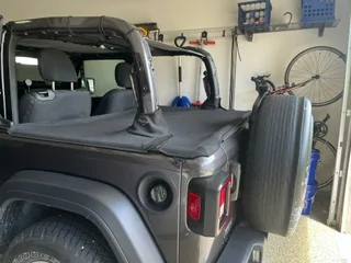

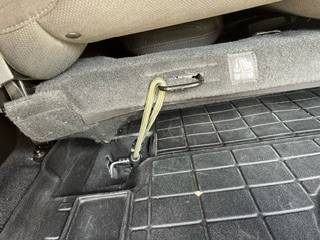

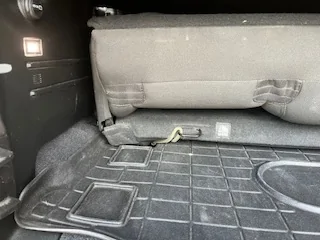

Another option. I like running my Jeep with a tonneau cover in summer while keeping the rear seat in place vs. removal for when I have passengers. Jeep configured the rear seat to flip forward, not 1/2 way. To keep the seat folded in 1/2 position, I used two small bungees (8-10") and attached them as photos. I lifted the seat in the first photo to show bungee attachment points. This solution prevents the seat from rocking and allows me to use a tonneau cover or covert back with passengers.
Jeep Wrangler JL Passengers (In a 2-Door) image0
Jeep Wrangler JL Passengers (In a 2-Door) IMG_2299
Jeep Wrangler JL Passengers (In a 2-Door) image1
