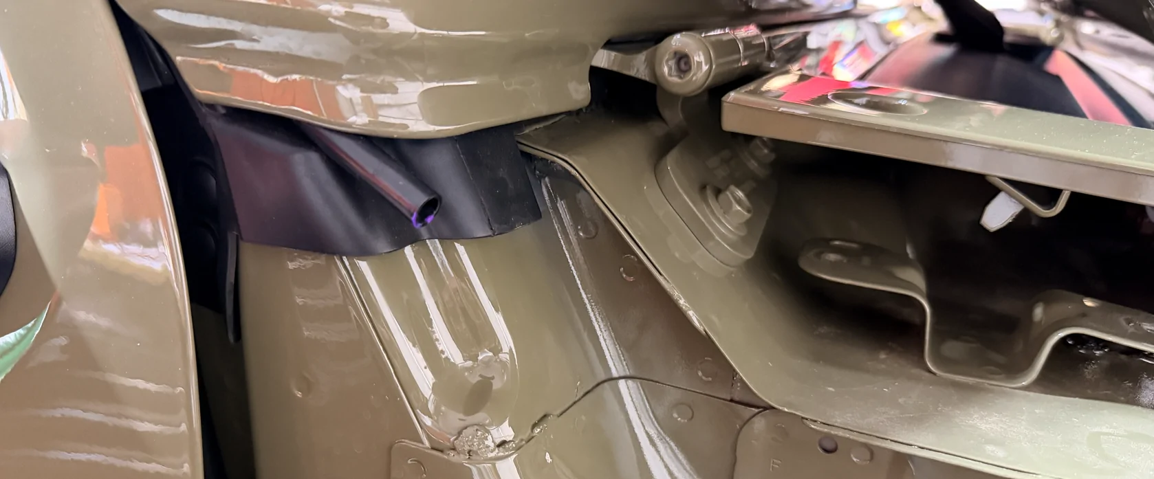

Below is the picture of the drain pipe under the side cowl

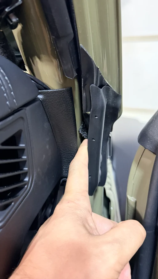

from inside, thats the area filled with thick foam

Take the bolts holding your windshield out and fold it slightly forward and pass them through next to the drain tube. I have my GMRS antenna run at that exact place and then ran it up the a-pillar to a molle panel above our heads.

I’ve run a few wires there and use one hand to lean the windshield forward slightly and another to feed the wire through. I feed a flat fish tape through from the interior and attach the wire then pull it back through. Maybe simpler ways to do it.

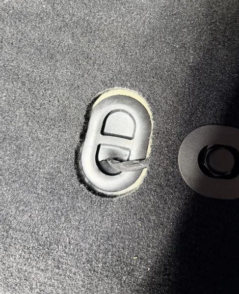

I ended up running the wire though the passenger side drain hole, will fill that plug with RTV and call it a day
