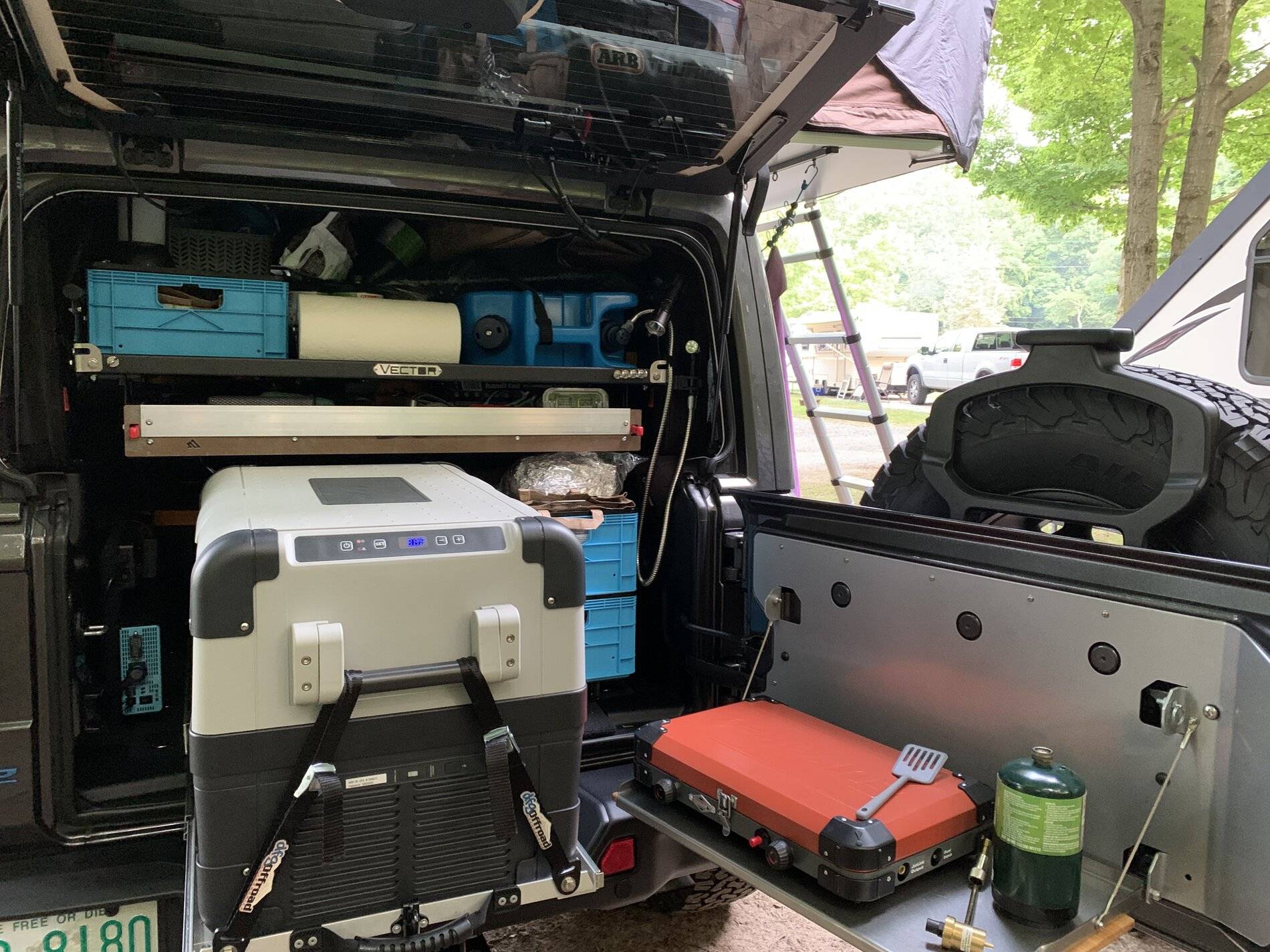

Just curious but is your fridge always on? I'm assuming it is but wondering how it's being powered without draining your batteries...
I tried powering the fridge with a Goal Zero Yeti 400, but couldn’t make it through the night. Fridge would shut off between 2am and 4am each night. I tried powering the Goal Zero with the OEM 12v plug in cargo area, then upgraded to 10 AWG wire with ARB/Engel-type threaded plug wired direct to battery, then upgraded to 4 AWG wired direct to battery. Goal Zero could never get the fridge through the night - regardless of wire gauge used.
I then ditched the Goal Zero Yeti 400, and installed the Genesis Dual Battery system and now it has zero issues. I just unplugged it last night after running it continuously full of food for 22-days, before and during our latest trip. Most days on our 16-day trip, the Jeep was running as we drove to a new location. But we stayed in one spot for 3-days, and another for 2-days. In both of those cases, I would just turn the Jeep to the “Accessory” position (not running the engine, or placing the transmission in drive) for about 5-seconds every 24-hours. Watching the voltage on the dash, you can see the voltage move up above 14 Volts. This appeared to be enough to ‘top off’ the deep cycle cranking battery, which, in turn, tops off the deep cycle house battery for accessories like the fridge.
I documented my installation experience in this thread: https://www.jlwranglerforums.com/fo...ual-battery-system-in-4xe.76402/#post-1595951
TLDR; You might be able to run a fridge off a single deep cycle battery - given the way the 4xe ‘tops off’ the low-voltage cranking battery under the hood by means of the high-voltage PHEV battery under the rear seats. Alternatively, you could use a better lithium battery like @johnnyj did above.
In my case, I happened to have the Genesis system and two deep cycle batteries on my shelf from my last 3.6L JL build, and wanted the redundancy, switching, jump start capabilities, etc. So I just put the whole system in.

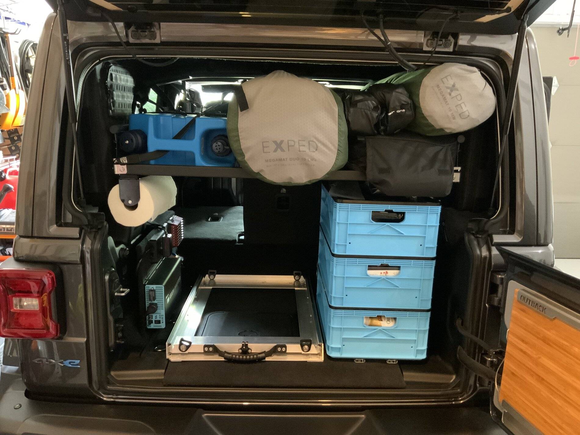

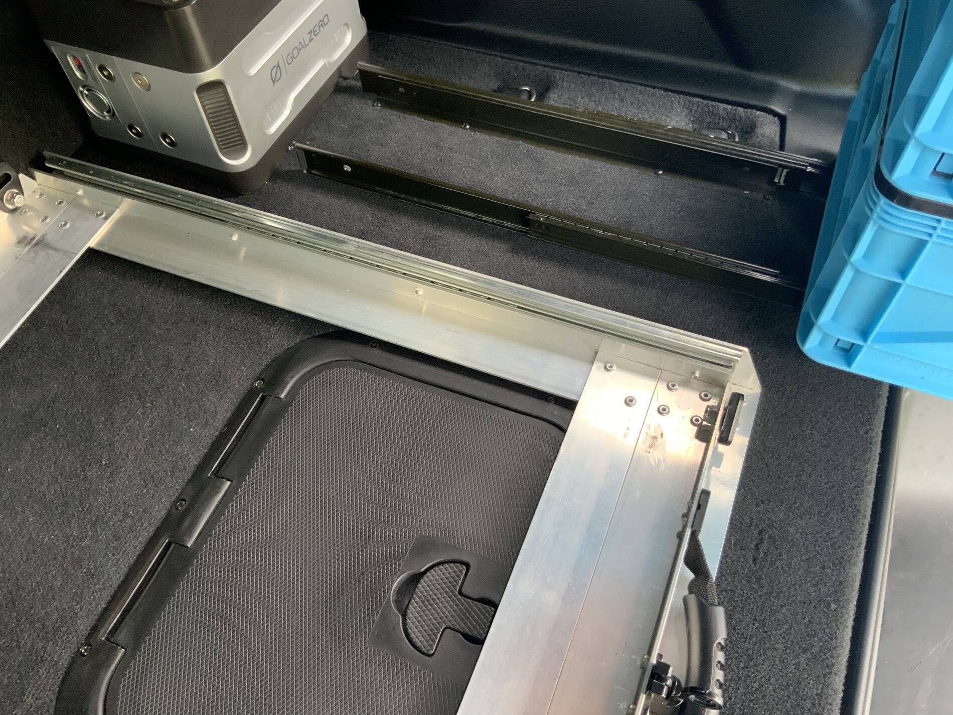

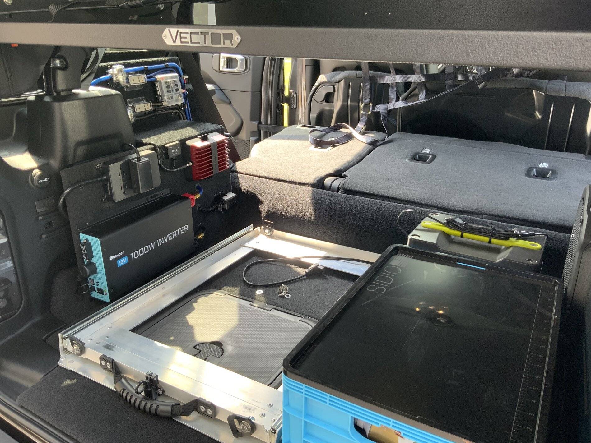

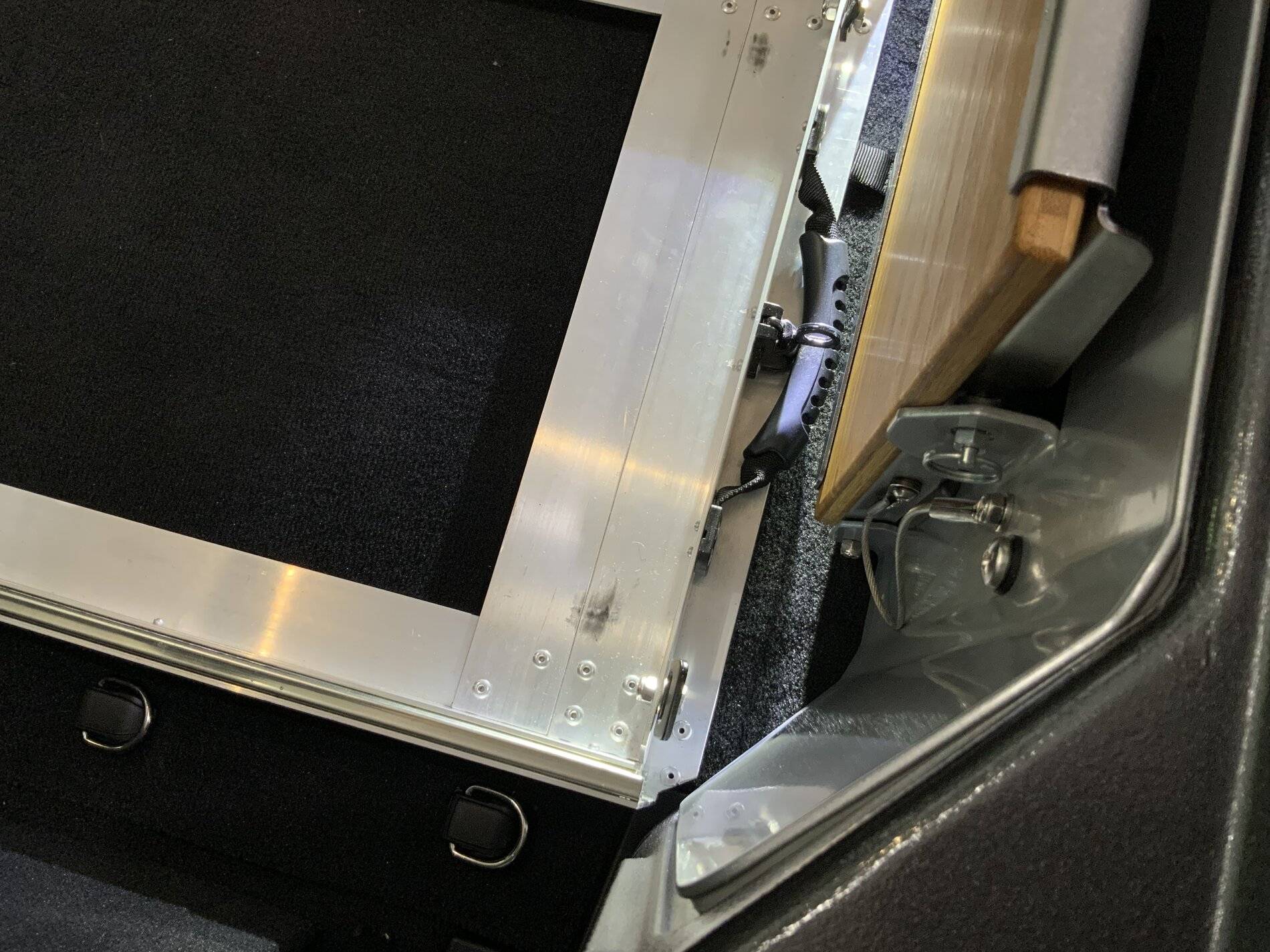

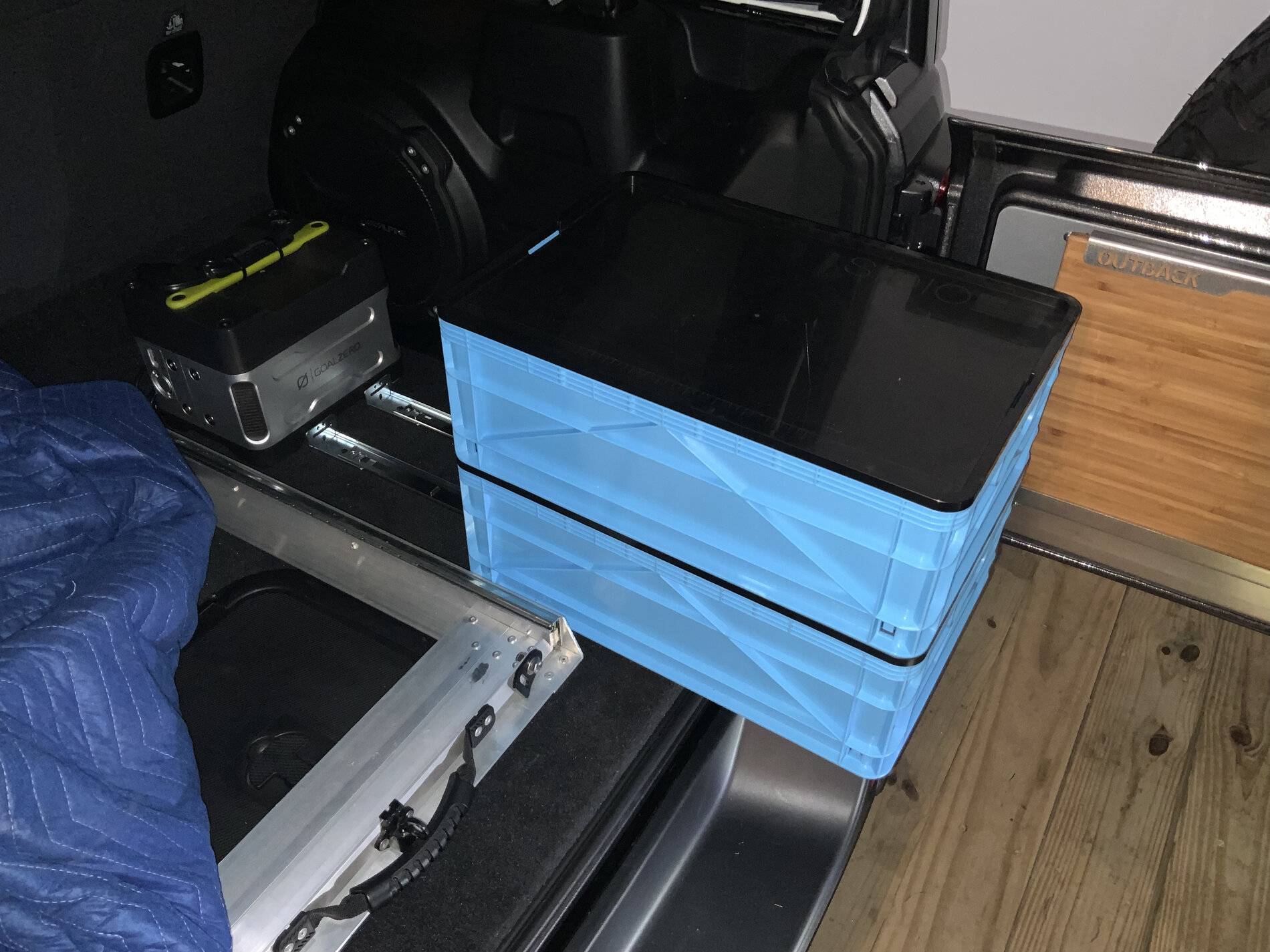

Thanks. Surprisingly, all the electrical stuff didn’t fail during our latest 6,000+ mile trip. And no electrical fires - which is always a bonus.
The drawer is kinda makeshift. It’s actually a lateral fridge slide from American Adventure Lab https://americanadventurelab.com/product/mass-wide-slide/
Sounds like AAL is working on an actual drawer - which would have been a better approach - if it existed.
The fridge slide is definitely overkill for the job, as we just used it for camp stove, pots, pans, utensils, etc. But I had a real tough time finding a drawer that was the right size to fit underneath our Vector GGB shelf, and this was the perfect size. It’s meant to mount to a floor or base. So I had to buy some cheap “L” brackets and additional bolts on Amazon to mount it underneath the shelf. I also picked up a cheap piece of aluminum at Lowes for the front to make it more like a drawer. Lastly, I bought some pick-n-pluck foam, and my wife spent the time to custom fit everything we wanted to carry. The drawer slides are way too heavy-duty for this application, but it worked flawlessly. This winter, I’ll probably do something different with the front - and powder coat it black instead of the weathered aluminum look we’re rocking now.
Let me put in a plug for the folks at American Adventure Lab. They were so very helpful, and rushed it out to me so I could have it the night before our trip to have time to install it. Great folks to do business with.

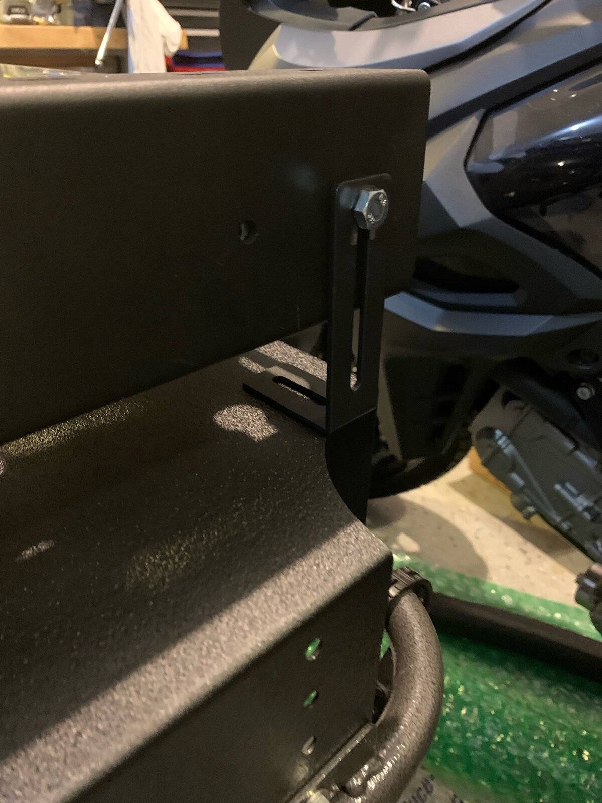

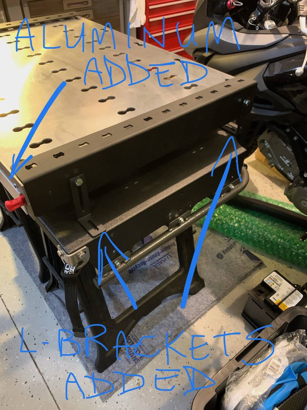

Here are a few pics of it being mounted with the ”L” brackets to the shelf:

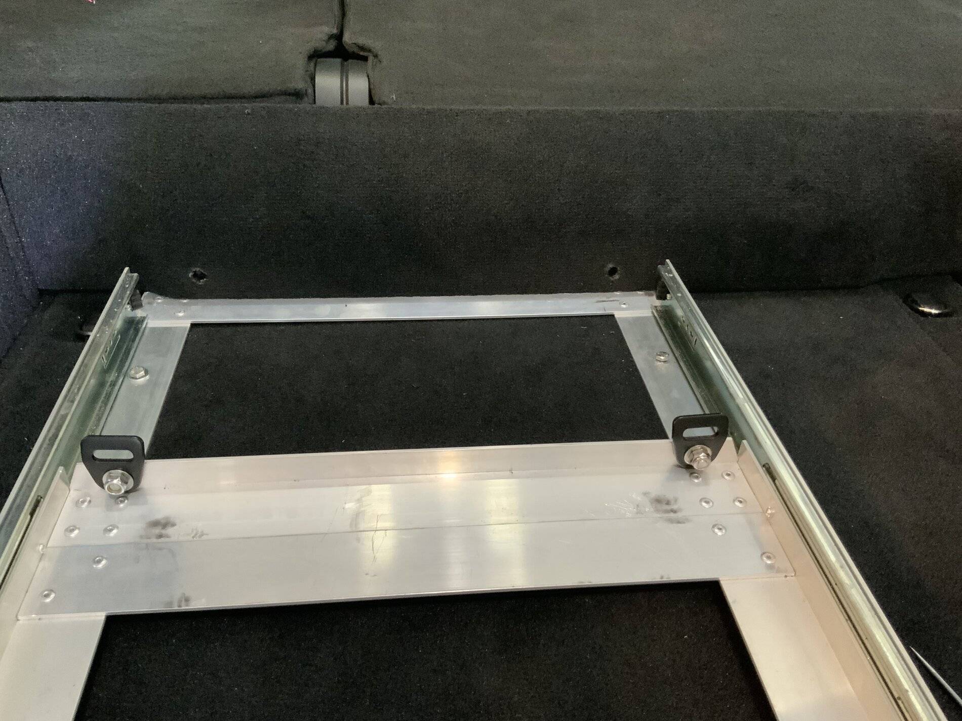

Everything works, but man…there are some tight tolerances, and I had to make numerous modifications to get everything squeezed in. This Jeep is a model of how to utilize every cubic inch available and pack the living daylights out of it!
Fridge slide is from DFG Offroad. I had it in my 2018 JL Sahara. Had to cut a little off the frame in the back where it meets the trim for the PHEV battery. Also, had to cut a corner (literally!) on the frame where it meets the tailgate - because I have a Trailgater table. Lastly, had to flip the strap mounts in the rear by 180 degrees, and drill a couple relief holes so the bolts for those strap mounts could sit in those holes to gain that extra 1/4”!
Here are some pics:
