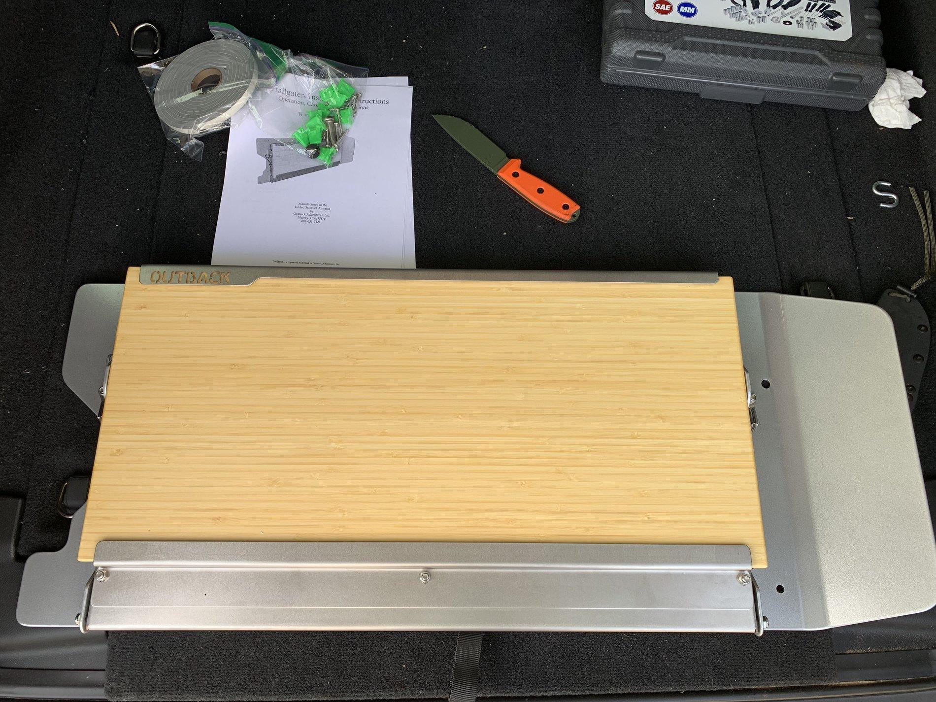

Whats in the Box?
Pretty much out of the box you get the Trailgater Table, a set of instructions and a zip lock bag with the screws, washers and clip inserts needed for the Installation.
Jeep Wrangler JL Outback Adventures TRAILGATER tailgate table IMG_1319

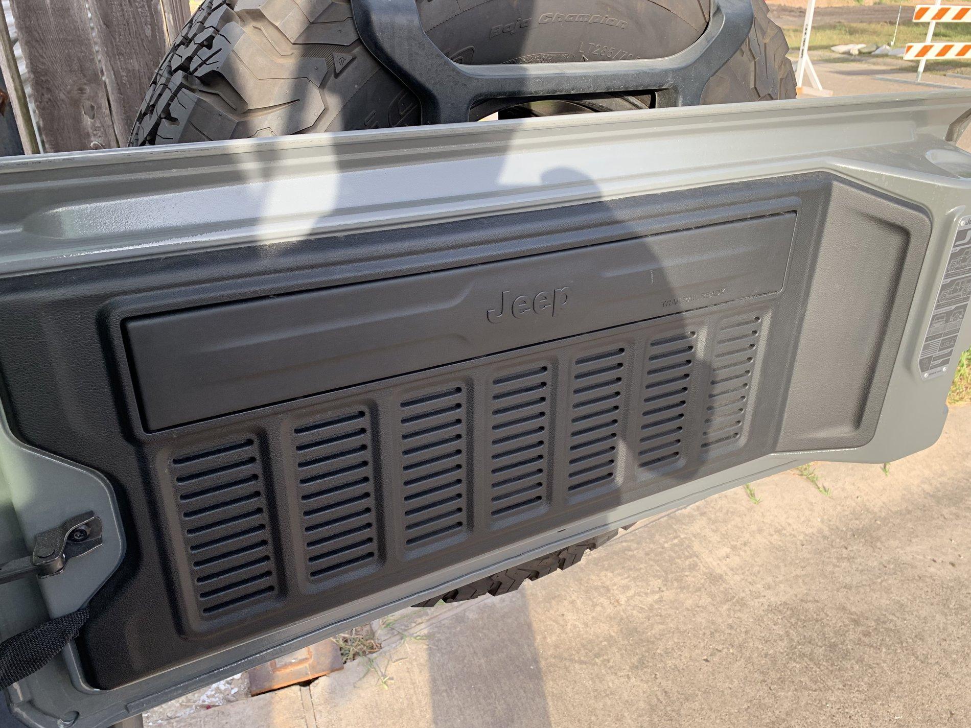

Step 1:
Remove the Plastic Cover from the Tailgate. I find it easiest to pull it out where the wiring harness goes through the plastic trim panel.
Jeep Wrangler JL Outback Adventures TRAILGATER tailgate table IMG_1321

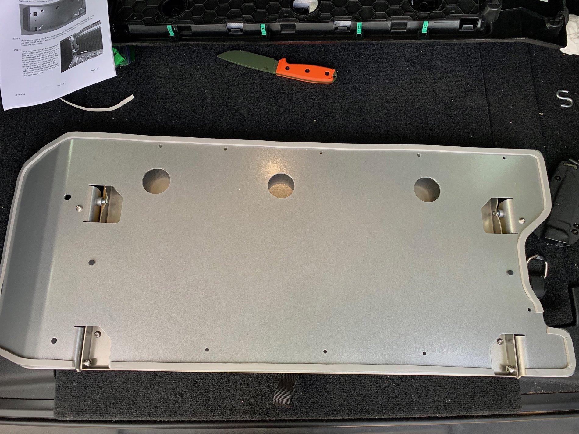

Step 2:
Insert the 9 Green Plastic Clips in the locations shown below. You can also reference the instructions for the locations as well. At first I thought I missed a spot but they give you one extra.
Jeep Wrangler JL Outback Adventures TRAILGATER tailgate table IMG_1326

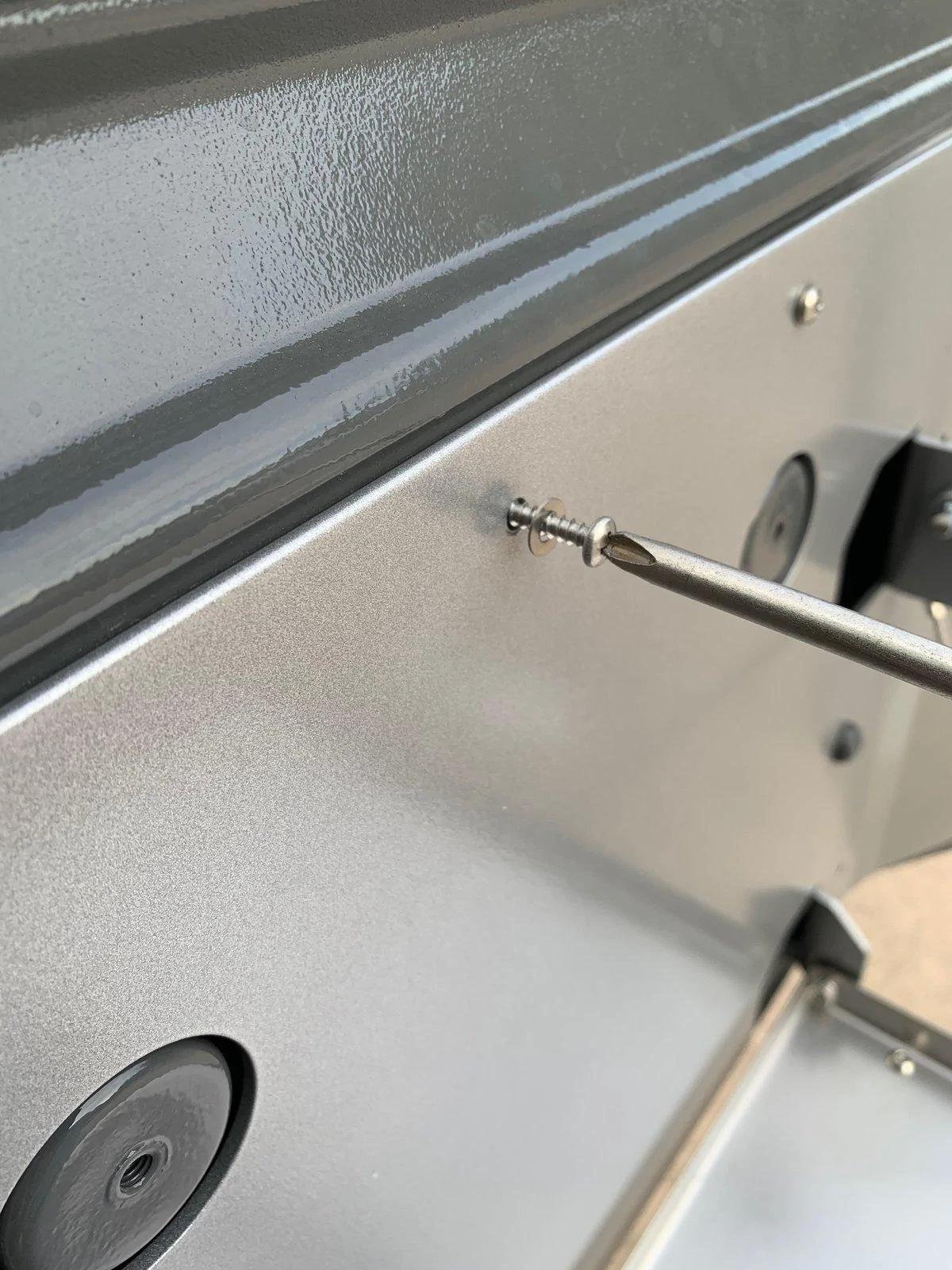

Step 4:
Open the table so you have access to the screw holes and remove the wood cutting board to make it lighter to hold up while you screw in the screws. On the Right side Latch is where you will bolt in the included bolt and washer. The instructions recommend tightening the screws hand tight. You don't want to strip the plastic trim pieces.
Jeep Wrangler JL Outback Adventures TRAILGATER tailgate table IMG_1328

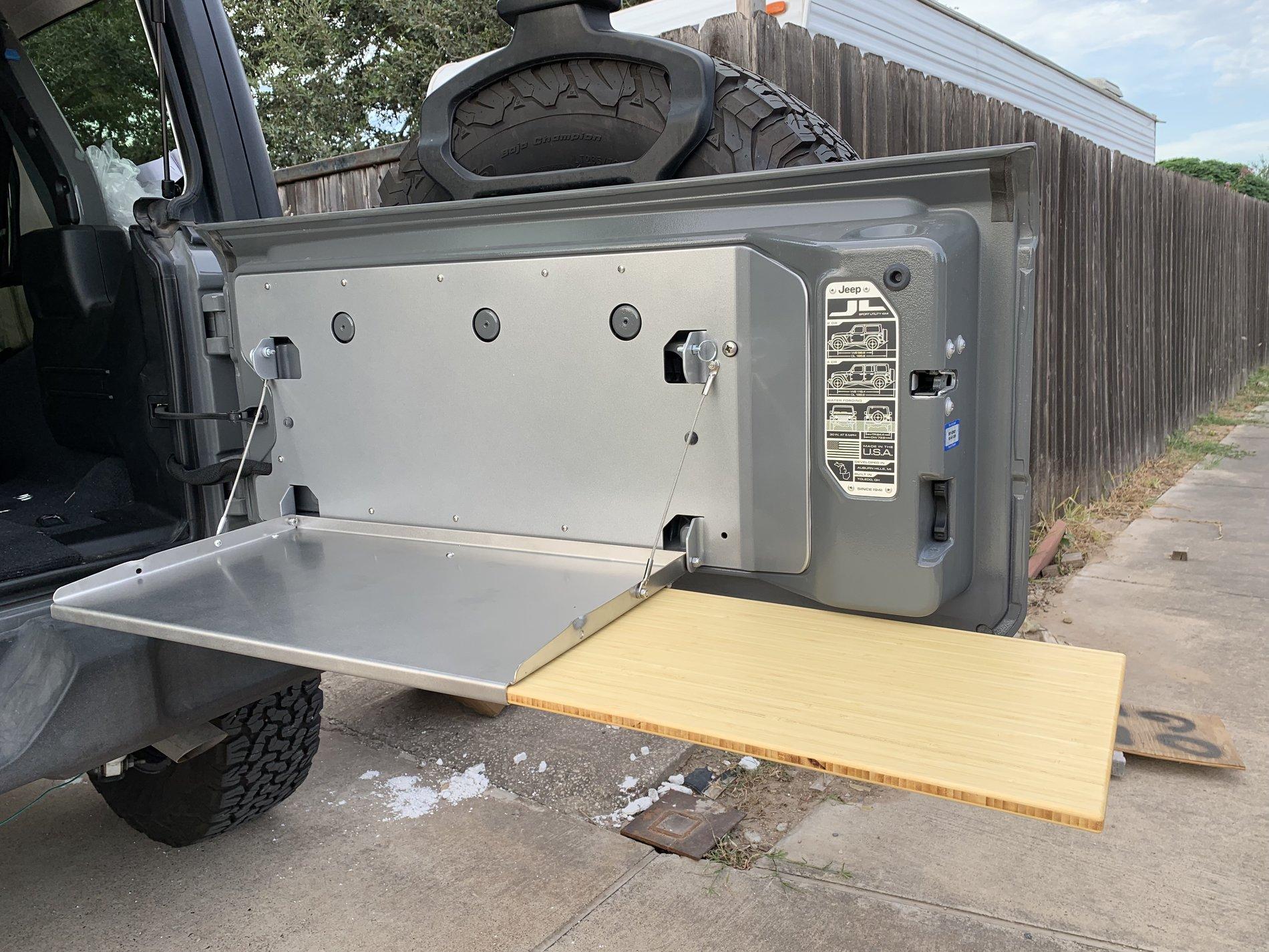

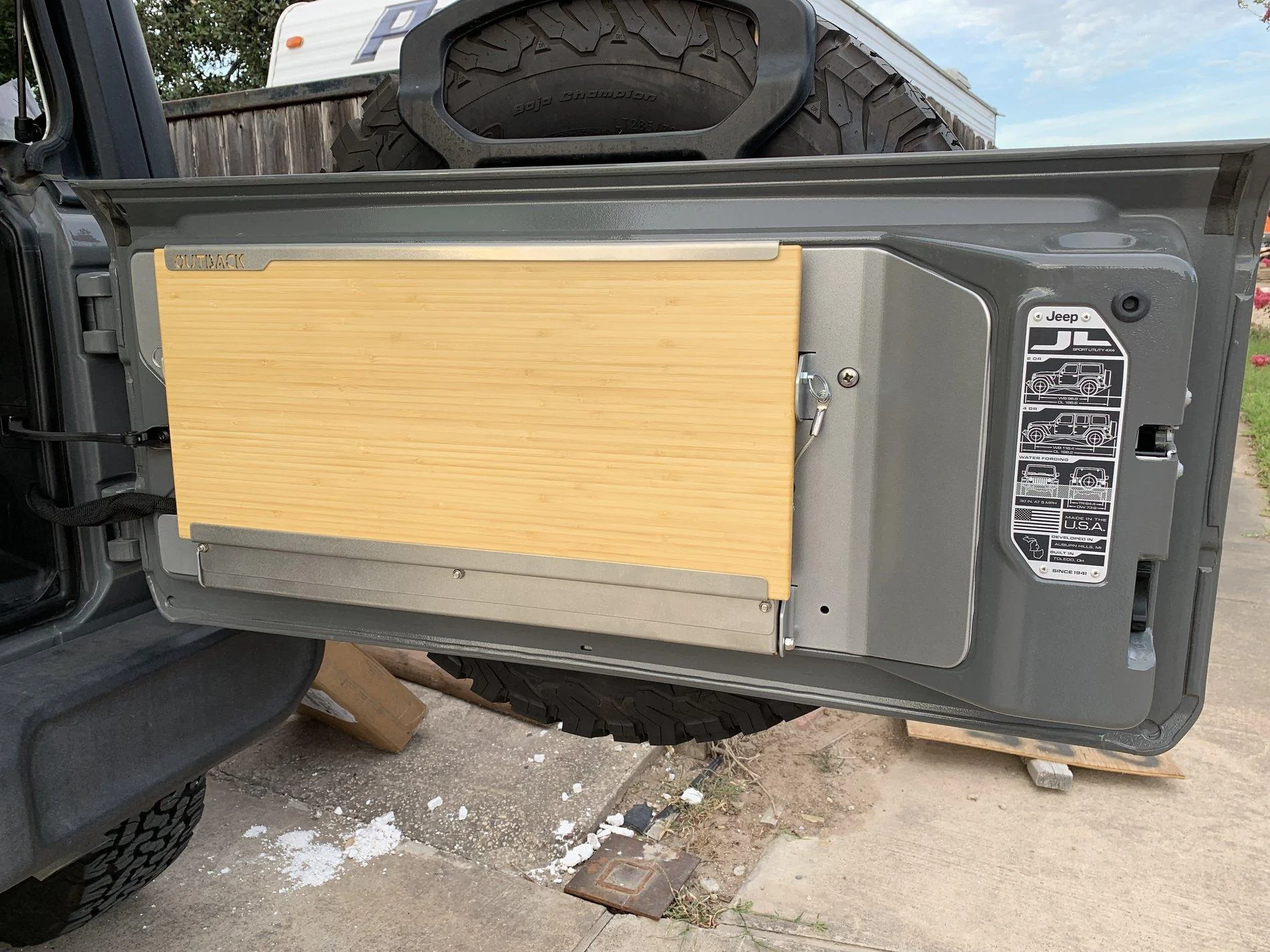

INSALLATION COMPLETE
There you have it. Its a very easy and straight forward install and literally takes about 15 minutes to do.
Jeep Wrangler JL Outback Adventures TRAILGATER tailgate table IMG_1331
Jeep Wrangler JL Outback Adventures TRAILGATER tailgate table IMG_1332
