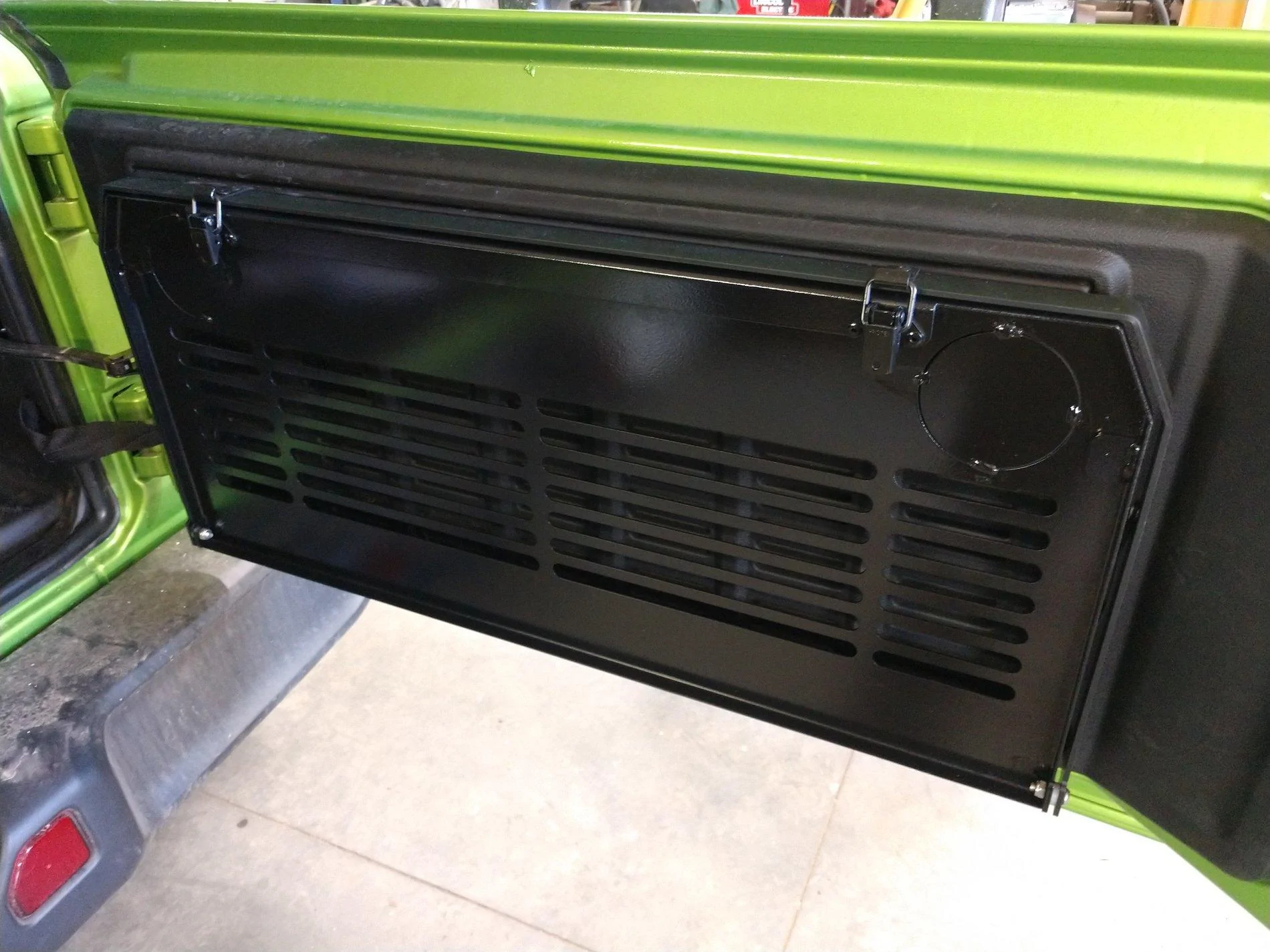

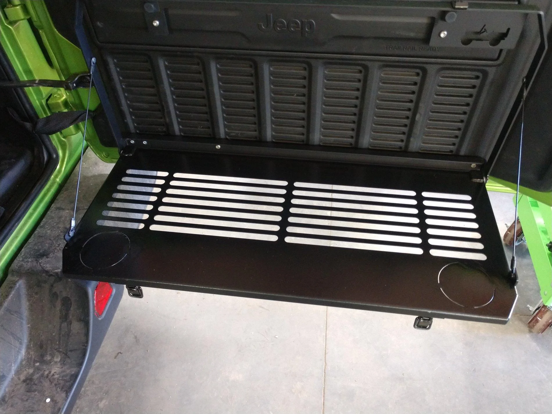

Nice change. Those massive cup holder holes is what kept me from buying it (got the Spring Tail instead). You solution is very professional looking. Great job!I just couldn't get behind the alleged cupholders and filled 'em. A 3.125" hole saw makes a nice 3" circle to fill the holes. I used some scrap 16ga laying around.
4 tacks ea, rattle can, done
Very nice!I just couldn't get behind the alleged cupholders and filled 'em. A 3.125" hole saw makes a nice 3" circle to fill the holes. I used some scrap 16ga laying around.
