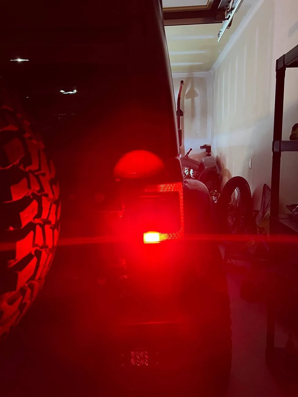

Anyone have experience with their lights not working properly?
Mine have seems to stopped working all of a sudden in a funny way
Lights off on switch, the rears work just fine, hazards, brake lights, etc
Lights on on the switch, hazards don’t work, neither do the turn signals or brake lights. I’ve changed the settings to LED tail lamps in the settings but it still persists.
Are the harnesses connected, in the sense if one resistor shit the bed, it wouldn’t allow the other side to work?
I've been considering these lights, for when I go from 37s to 38s and my spare will require my custom fuel can bracket to move another 5/8" toward the tail light which now has zero clearance from the OEM LED tail light. But the reliability seems sketchy.
video for reference
They’ve been working great for me for a few years, i’m just not sure when this started.
I’ve tried so far
  • unplugging one side at a time
  • swapping taillights to opposite sides
  • unplugged the resistor from each(there’s corrosion on the plugs on each so maybe they haven’t been working in a good bit
  • changed the following settings in JSCAN: LED Turn lamp present, LED Stop Lamps present, LED Reverse lamps present, LED tail lamps. Before this was unchanged as i never had issues with them working before
Just odd that they both don’t work. I ordered a new headlight switch as precaution as well. My dad and I were talking about it, but i don’t have high hopes.
My second theory is that something shorted in one of the lights and i’m not sure if it the BCM sees both tail lights as a completed circuit and maybe it’s just defaulting to be being on without flashing or anything. It’s just odd as normally when turning on the lights it’ll be at something like half brightness until tapping the brakes, but it’s as if they’re both stuck at full brightness.

Interesting, I’m hoping it’s an issue with my oracle lights and not some wiring harness in the jeep. I wish I still had my stock lights to test out however.
I did check the harness and aside from it being dirty and the resistor connectors having some corrosion I didn’t see any evidence of the tailgate arm hitting the harness.
