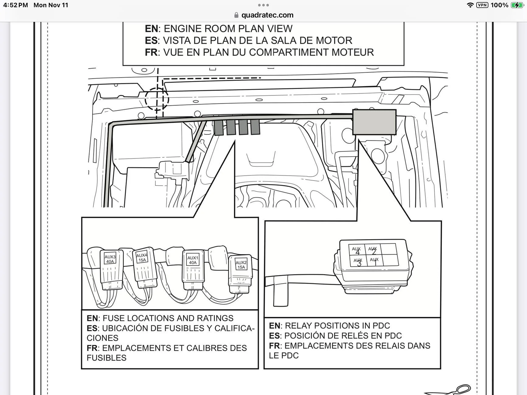

Quoting @Rhinebeck01
each of those 4 Aux switches in regard to that non factory install has it's own fuse holder/fuse on the harness and NOT fuses in the PDC like the factory installed Aux.
That would seem to make sense... I was only thinking of the PDC...ugh.....

I finally got ā€˜round to this today… I grabbed a 10mm socket preparing to remove a few bolts, when lo and behold…. There was the harness in plain sight.
The second one I opened… there it was; a popped 15 amp fuse. Replaced and resolved…. Don’t know how it happened & don’t care.
I looked for a difficult solution to a simple problem… Thanks, @Terrymo for showing me the error of my ways.
