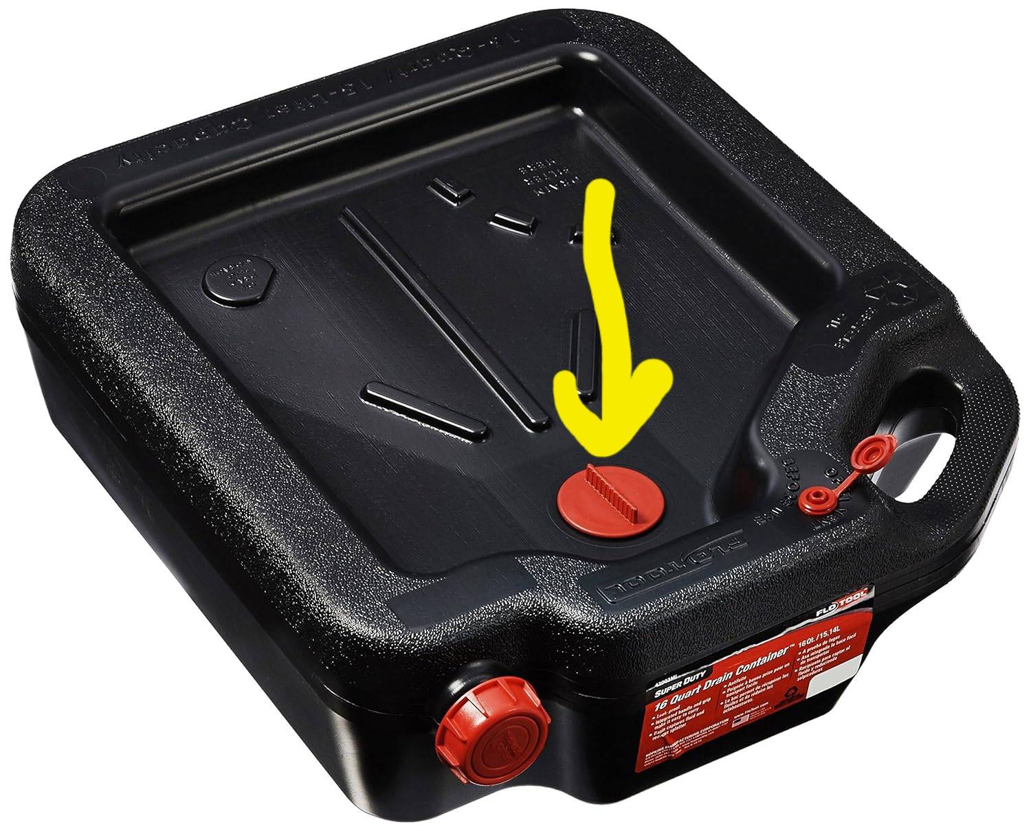

I think the engineers who designed this little powerplant hate those of us who do maintenance on them. I'm installing a Fumoto valve this oil change to keep things easier / cleaner going forward. First time I changed the oil I had hot oil overwhelm the top basin of my 16 quart drain pan faster than it could drain into the primary holding tank...it filled up and flowed over onto my garage floor before it could all drain into the primary holding tank. So I drilled out the drain holes in the drain pan BIGGER hoping they will keep up with the volume of oil leaving the Jeep's crankcase once the oil pan's drain bolt is removed in the future. The new Fumoto with a drain hose down into the drain pan's primary holding area should be nice & tiddy. I'm still trying to figure out how to make removing the inverted oil filter a 'clean' affair? Any tips? The fuel filter isn't hard...just stinky and sort of messy. Anyways, does anybody else cuss these VM engineers when turning a wrench on these things? 🤪

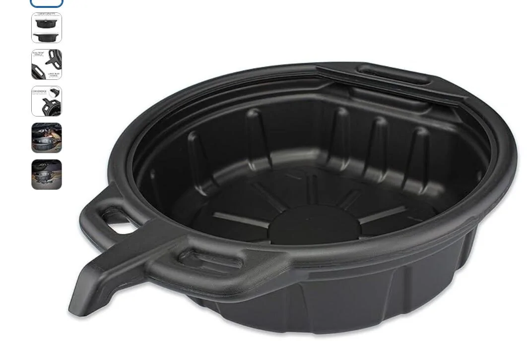

Last time I changed my oil I was watching the pan fill up and asking myself, why is oil about to spill over? Yelp! I forgot to pull out the drain plug in the drain pan. Too hot to dip my hand in it, oil everywhere, dang it! Don't think I didn't feel like a bone head.
With a fumoto valve I could have reached up there and closed it. 🙂
that's the exact drain pan I got and my plug was removed and it still overflowed!!! That pissed me off so I drilled out those Lil drain
that's the exact drain pan I got and my plug was removed and it still overflowed!!! That pissed me off so I drilled out 2 more holes to compliment those 2 lil piss ant drain holes it came with! I even had the breather plug cap off so it could breathe...gheez
I surprised at that, I wonder why it didn't drain properly. Mine has worked great, no issues at all. As long as I remove the drain plug. 😆

I've the identical fluid drain pan, and it does indeed respond well to drain hole enlargement. 👍

Mine has a bigger hole and no cover ... :giggle:
