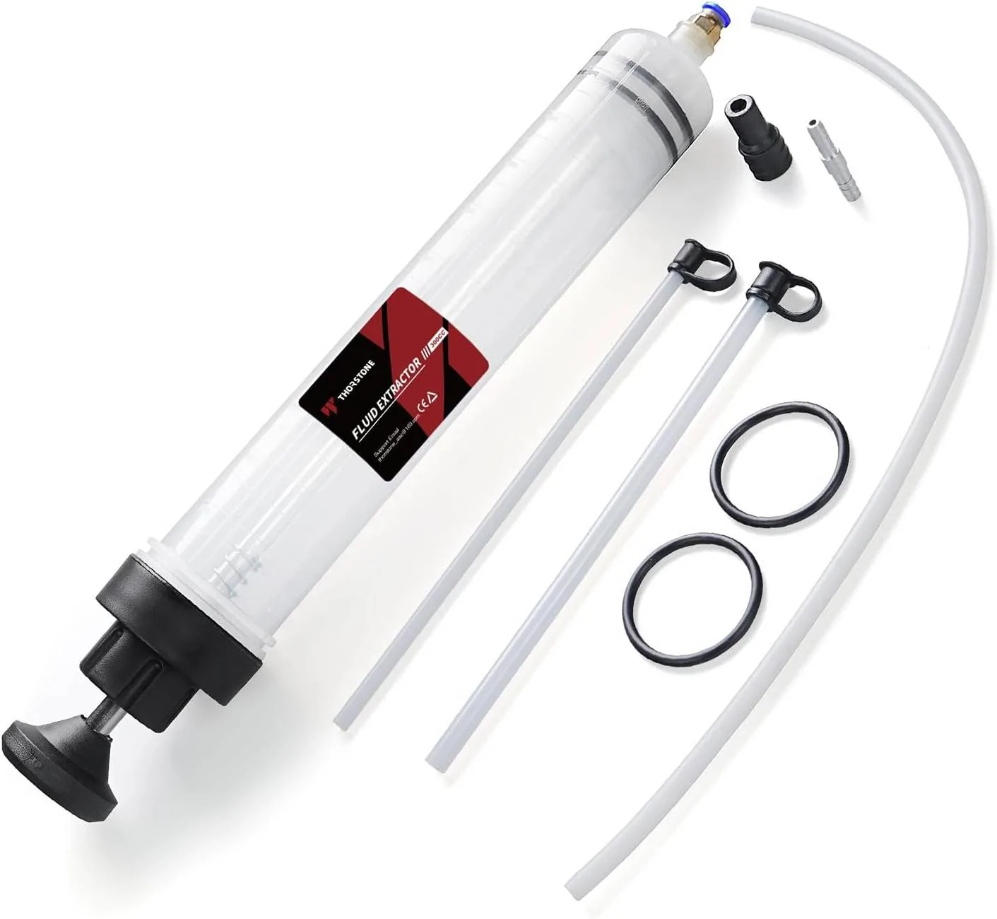

I also use a turkey baster to suck the oil out of the bottom of filter reservoir.
You mention using a "turkey baster" .... I have a couple of old school turkey basters in my tool box..
BUT .... recently my one Son gifted me a turkey baster on steroids lets say..
Talk about top notch extraction of fluids... AND, now, I even use it to do transfer case fluid fills versus using a hand pump to get the ATF+4 into a transfer case. like I have done for years..
Jeep Wrangler JL Oil & Fuel Filter Change Tips??? 61QOnfo5poL._AC_SL1500_

All I was using it for was to suck the last of the oil out of the filter reservoir. I wish they built ours like the Eco2 where the oil filter is not at an angle.
I soaked up what I could of the old oil in the bottom of the filter housing but maybe next time I'll draw it out with the manual vacuum pump I have...like the one pictured. I don't wanne get too OCD on this thing in case it craps the bed on me! As for the fuel filter, I dropped it into a short bucket and reinstalled new one w/o-ring & I just primed it 4 or 5 times and it took approx. 5-8 sec and busted right off.
