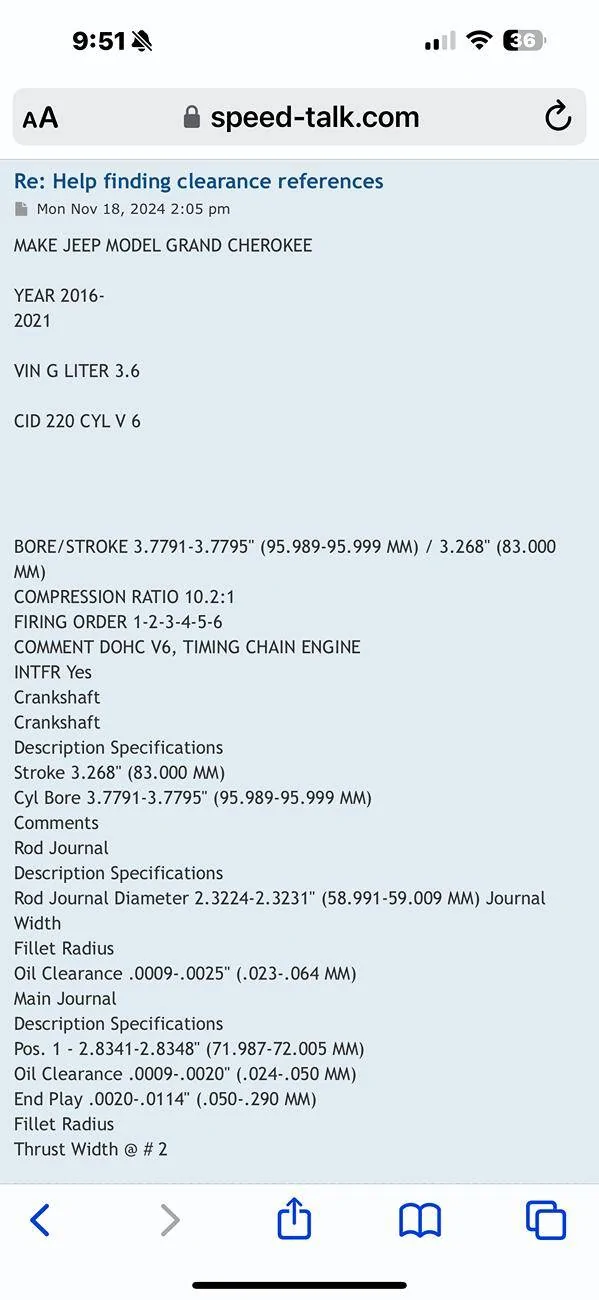

25 microns is almost exactly .001” Look at the oil clearances i attached. Now halve that for clearance at the top and bottom of a journal. 15 and 20 micron filtration starts looking a little more important. Just do an oil/filter change every 5k and all should be good for maximizing life. Rings too to some extent if the particles in your oil are large enough to stick out from the cylinder crosshatch.
Jeep Wrangler JL Oil filter brand IMG_4013

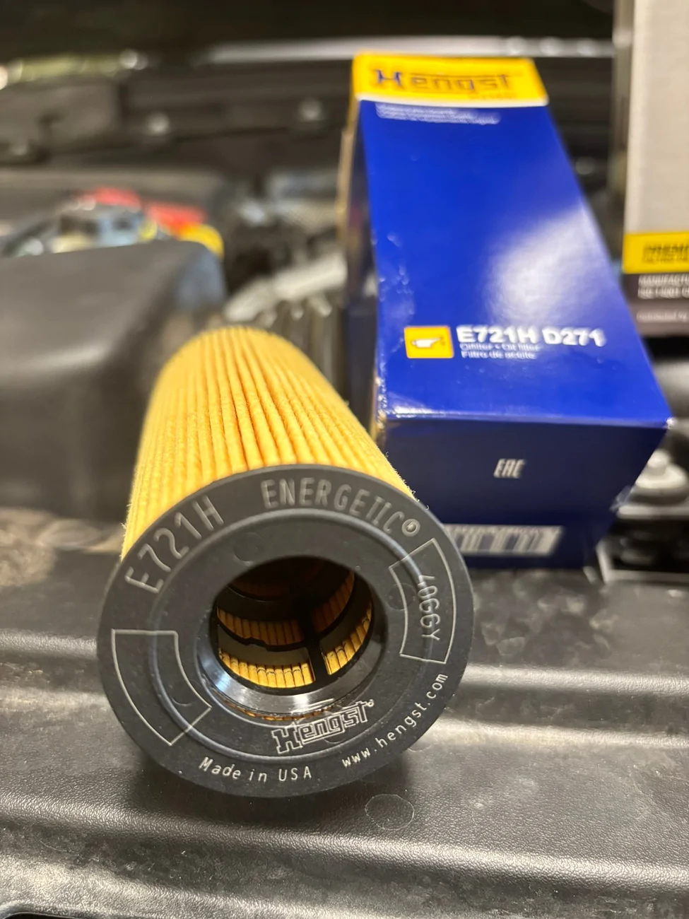

I used the FRAM TG11665 for the previous change, however I bought this beauty from Rock Auto for the next change.
MADE IN USA Hengst E721H D271
Jeep Wrangler JL Oil filter brand D8653F0D-3D7E-4368-A18D-C19A5C653458_1_102_o

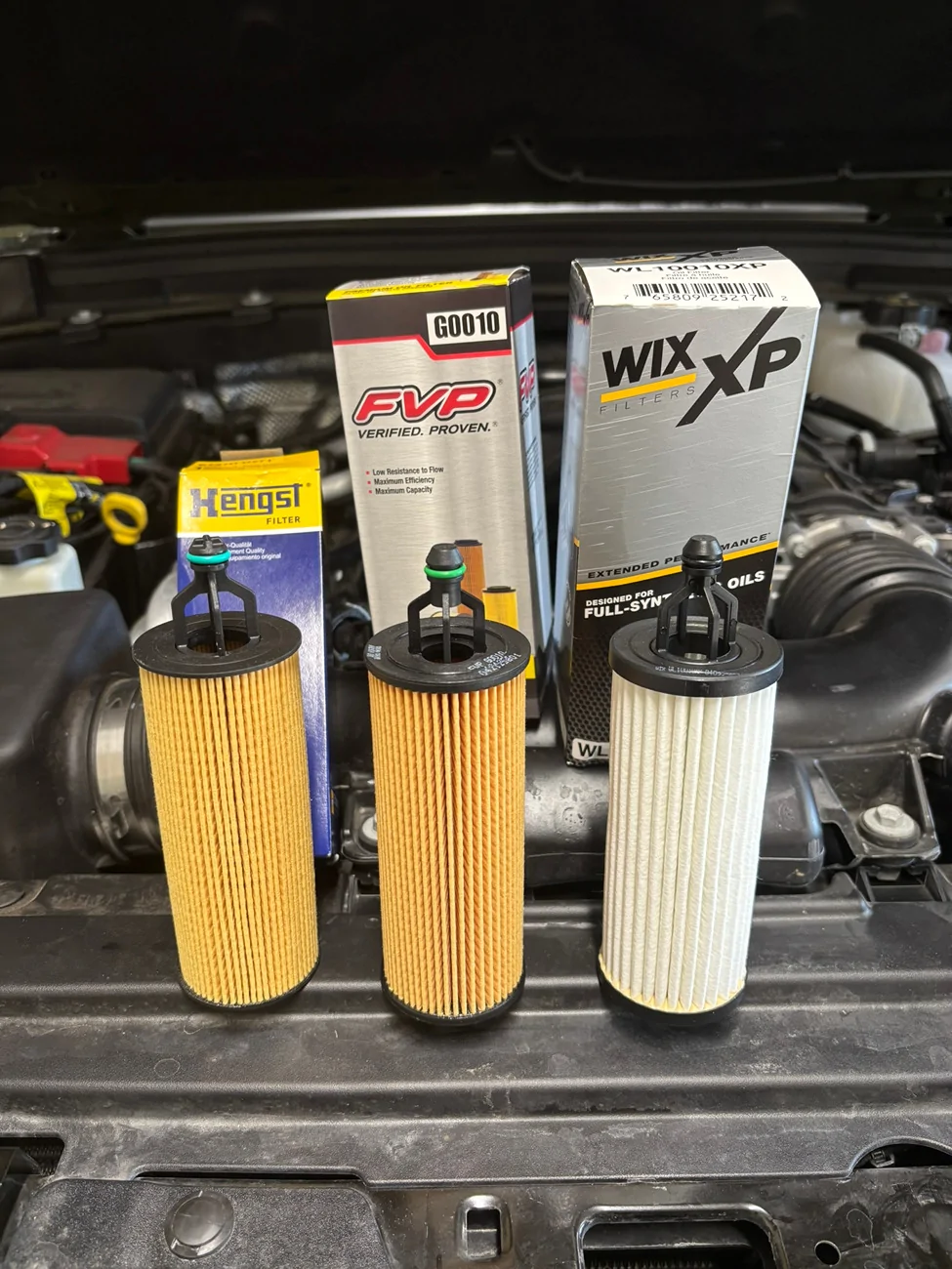

I also bought the Wix WL10010XP Made in Korea and a Chinese made FVP.
I'll probably never use the FVP. I may just cut it up to compare it to a MOPAR filter.
Is there a thread where someone dissects various filters and posts pictures of them? If so, please point me to it.
Jeep Wrangler JL Oil filter brand B11456AE-DE4B-4525-8FBB-367747CB124B_1_102_o
