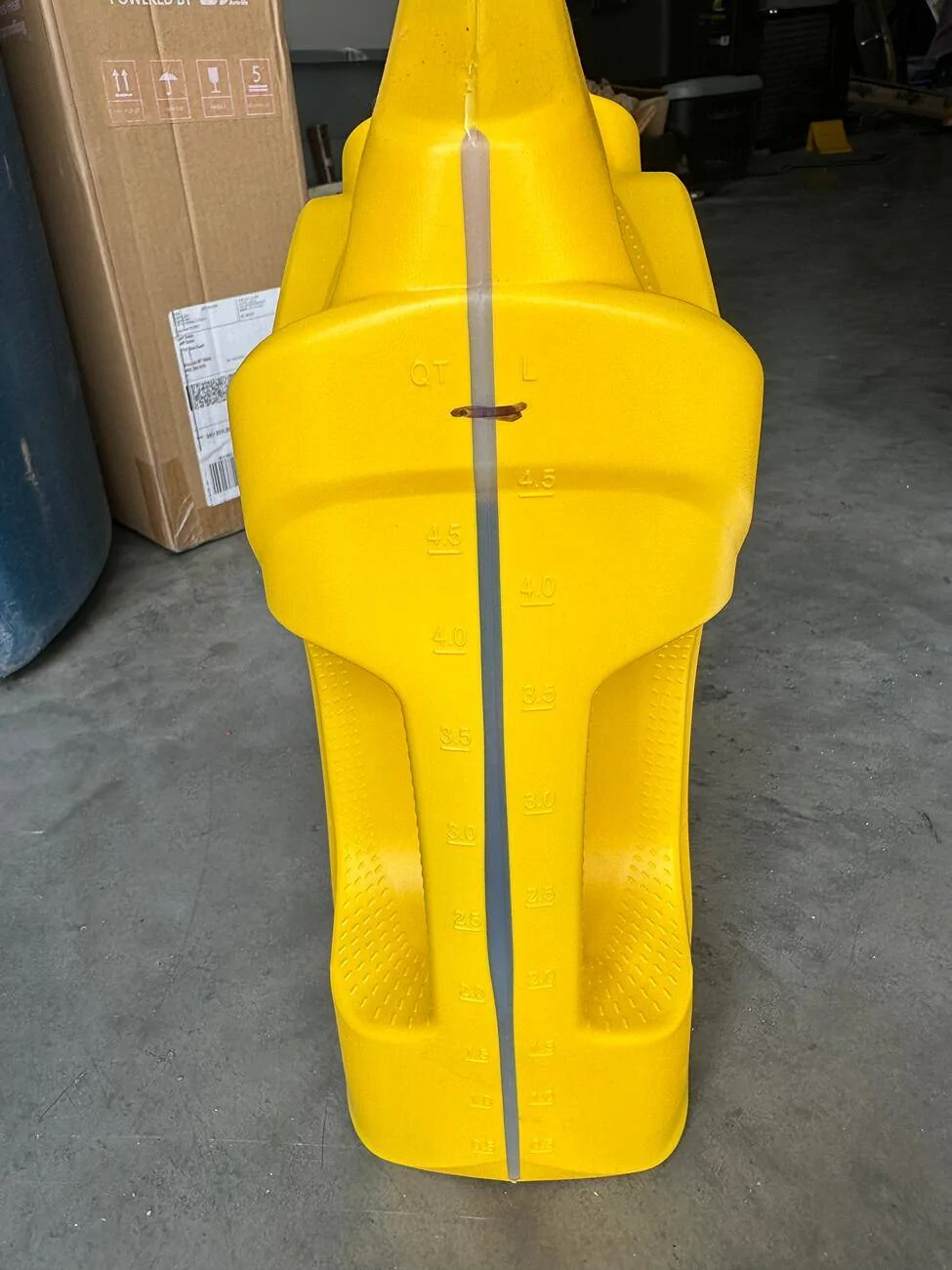

changed oil yesterday at ~3000 miles..they were pretty hard 3000 miles a trip to moab with several trails run and to Colorado and back home to Montana..much of it was high RPMs on the highway 3500-5000 RPMs was common...speed limits for most of the trip were 75-80mph so not uncommon to be running 85mph. When traveling to Utah and Colorado from Montana you are doing a lot of climbing so much of it was 4, 5 and 6 gears.. I changed right before I left so all the miles were from this trip. I did take an oil sample so a few ounces there and I inadvertently spilled some because I did not have my drain pan placed correctly but not a lot but a couple ounces and a bit of residual left over in the drain pan. anyway this what I got out of my 3.6 with just over 14,000 miles...I marked the jug's level before opening it so you can see did not really burn anything as the filter has to soak up some oil altho not sure how much.. I should have weighed the filter and could have figured it out but too late for that..
