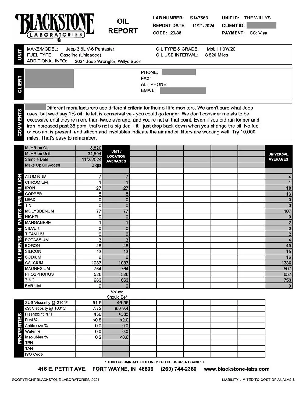

Since you're looking to extend your OCI, you might want to consider the breakdown of the oil in it's performance for HTHS. I believe HTHS is what protects your cam/rocker system. 0w20 is very low on HTHS and running it long intervals takes it lower. Consider moving to a 5w30 with improved HTHS for extra margin in long OCIs.

You are aware that your CST at 100C is the one of a 0w16 ?

I see lots of threads about how often to change oil, but most posts seem to be based on gut feelings. As an experiment I decided to use the Jeep's oil monitor as my guide since I see a lot of scoffing at that metric. I didn't let it get all the way down to zero, but I did get it down to 1%. This meant an oil change after 8820 miles.
An oil sample was sent to Blackstone. It's nice having data to take the ambiguity out of a decision. I'm going to take the advice and go 10,000 miles next round. But I might be giving my Jeep calcium supplements.
Your approach is solid—relying on actual data to make maintenance decisions removes guesswork. From the report, your engine seems to be performing well within normal limits, even after 8,820 miles. The absence of excess wear metals or contaminants supports extending your interval to 10,000 miles.
The calcium content looks normal, as it’s part of the oil’s detergent and dispersant package. Unless you switch oil brands or notice something unusual in future reports, it shouldn’t need supplementation.
If you’re sticking with the Jeep’s oil life monitor, this data should boost your confidence in its algorithm. Anything else about the report stand out to you?
