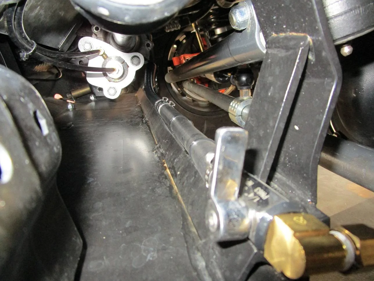

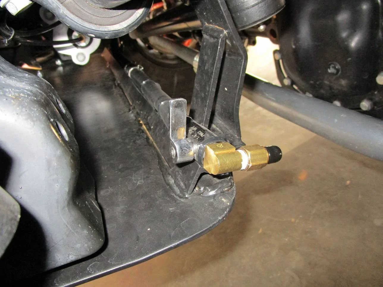

Willys41
Larry
Nov 2, 2021
1,167
1,301
Pleasanton Ca.
2020 Jeep Willys
That could be true and depends on the type of driving and the oil you use.
I am now running 5w40 and will do my first oil can drain today.
Same. pics please good sir. My catch can is filled to the top when i do my oil changes
Here is an earlier post with pictures.
As you can see I made a bracket for the UPR catch can to clear the Baxter oil filter adapter.
This also gave me more room for the drain hose.
Also just drained my oil catch can at about 1500 miles. about 4oz. and all was in the drain hose none in the can it self.
https://www.jlwranglerforums.com/fo...ion-carbon-build-up.89553/page-4#post-2548170

Sorry I responded in the wrong thread. Very cool but I don’t see where you have the hose coming out the catch can. Did you drill and tap a fitting on the bottom of the can or something?
Willys41
Larry
Nov 2, 2021
1,167
1,301
Pleasanton Ca.
2020 Jeep Willys
The UPR already has a 1/4 pipe drain in the bottom.
