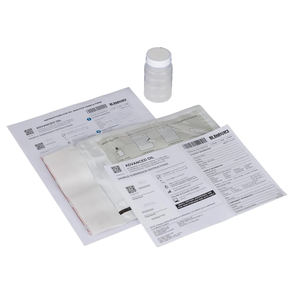

@CarbonSteel just curious how you know the Amsoil kit is polaris? Not doubting you, you obviously know your stuff, it just doesn't say it anywhere that I have seen. Do they give you a summary statement like blackstone to help the layperson understand the results? I have found that to be helpful in viewing others reports. Thanks!
I have performed more than 40 UOAs with the Amsoil kit (both diesel and gasoline) and it is 100% Polaris/Horizon. Look at the picture of the document on the Amsoil site for the kit and you can see Oil Analyzers on it with a Houston address:
Oil Analyzers Lab, 10910 W. Sam Houston Parkway North, Suite 700 Houston, TX 77064
Jeep Wrangler JL Oil Analysis results? kit06new-ea
Also in their document here - https://www.oaitesting.com/images/docs/Oil-Analyzers-User-Guide.pdf you can see they have a location in Houston. This document gives a good explanation of how to interpret the results.
On the Polaris site they also have a location in Houston - https://polarislabs.com/whypolaris/

fantastic. Thanks!
