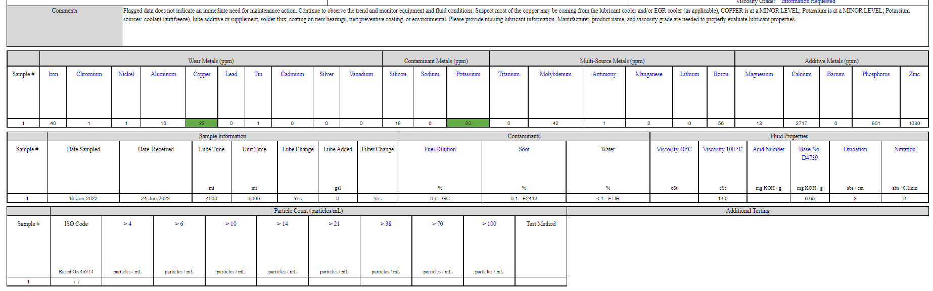

I didn't see an oil analysis thread for the 3.0 Diesel. I recently had a oil change and had them pull a sample (about 9000 miles). I thought if there wasn't a thread already up, I'd start one. Here's what I have so far but needing to get additional information for filter brands and oil brands etc.
Looks like they "flagged" copper and potassium.
9K miles is way too many. The potassium is really odd.
