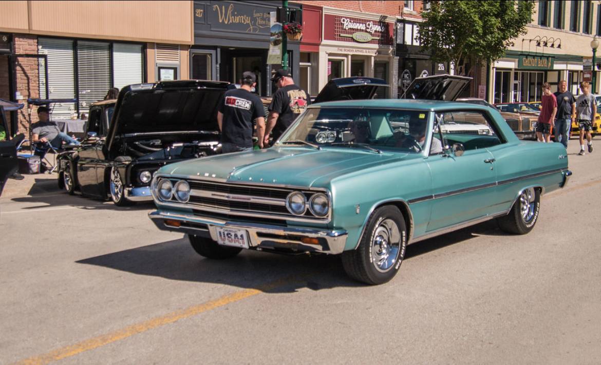

It just got to the point it’s not fun anymore. I started a new pro touring build on a 65 Malibu. That’s going to consume most of my time. I actually stuck the Jeep in the back shop today and covered it. When spring comes I will decide what to do, burn it or sell it. Lol!
