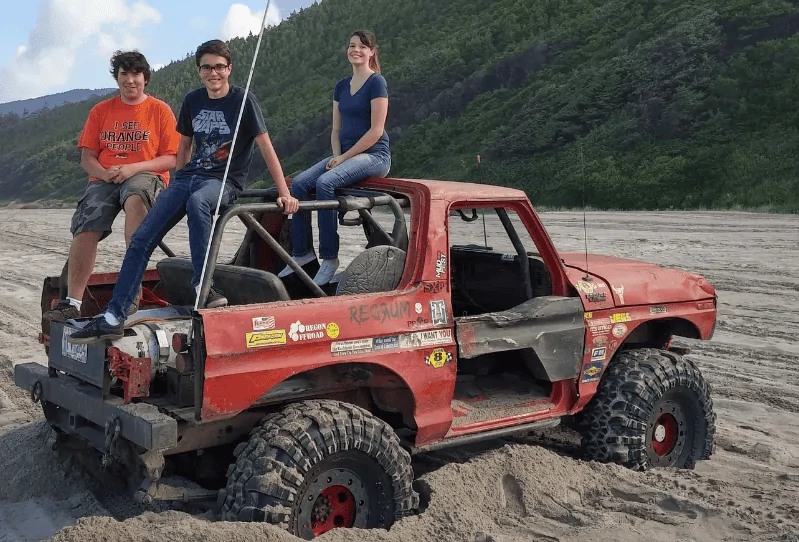

I fought the death shakes in my old bronco for ever, every bolt bushing nut I could think of was inspected tightened repeatedly... the fix eventually came from a motorcycle buddy, he told me tire pressure and rake were the keys. He learned this after he experienced DW on a bike at 85 which was induced by an over inflated front tire that rebounded like a superball after a bump in a turn. On a motorcycle rake is sort of locked in but on my bronco I adjusted as close to 0deg caster and problem solved. If you go back and look at old scouts they came from the factory with 0deg caster, likely for the same reason. There are downsides to 0deg but nothing as bad as crossing freeway lanes IMO. Anyway, free internet knowledge.
For giggles, here is the old bronco (currently undergoing major surgery).
