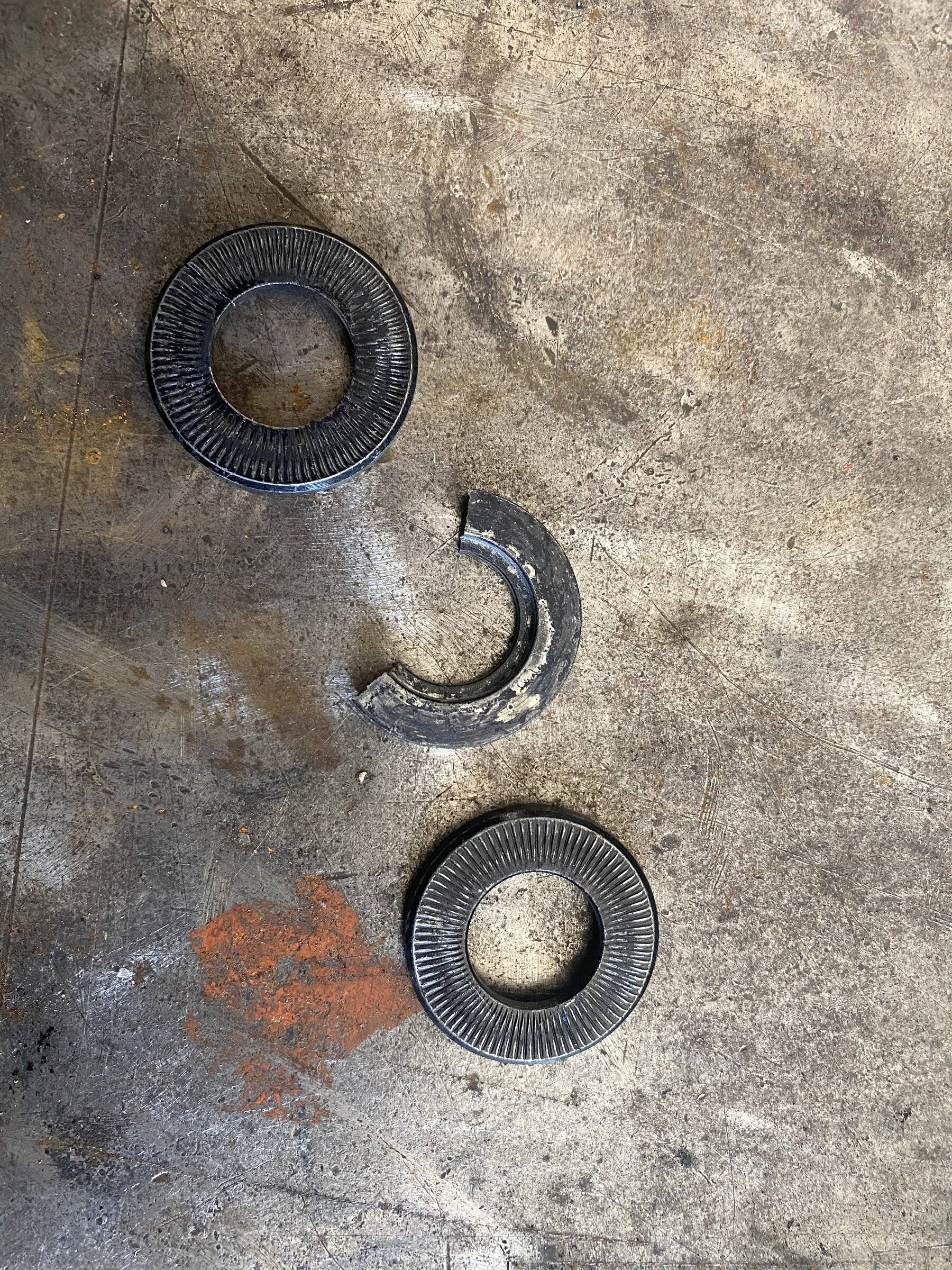

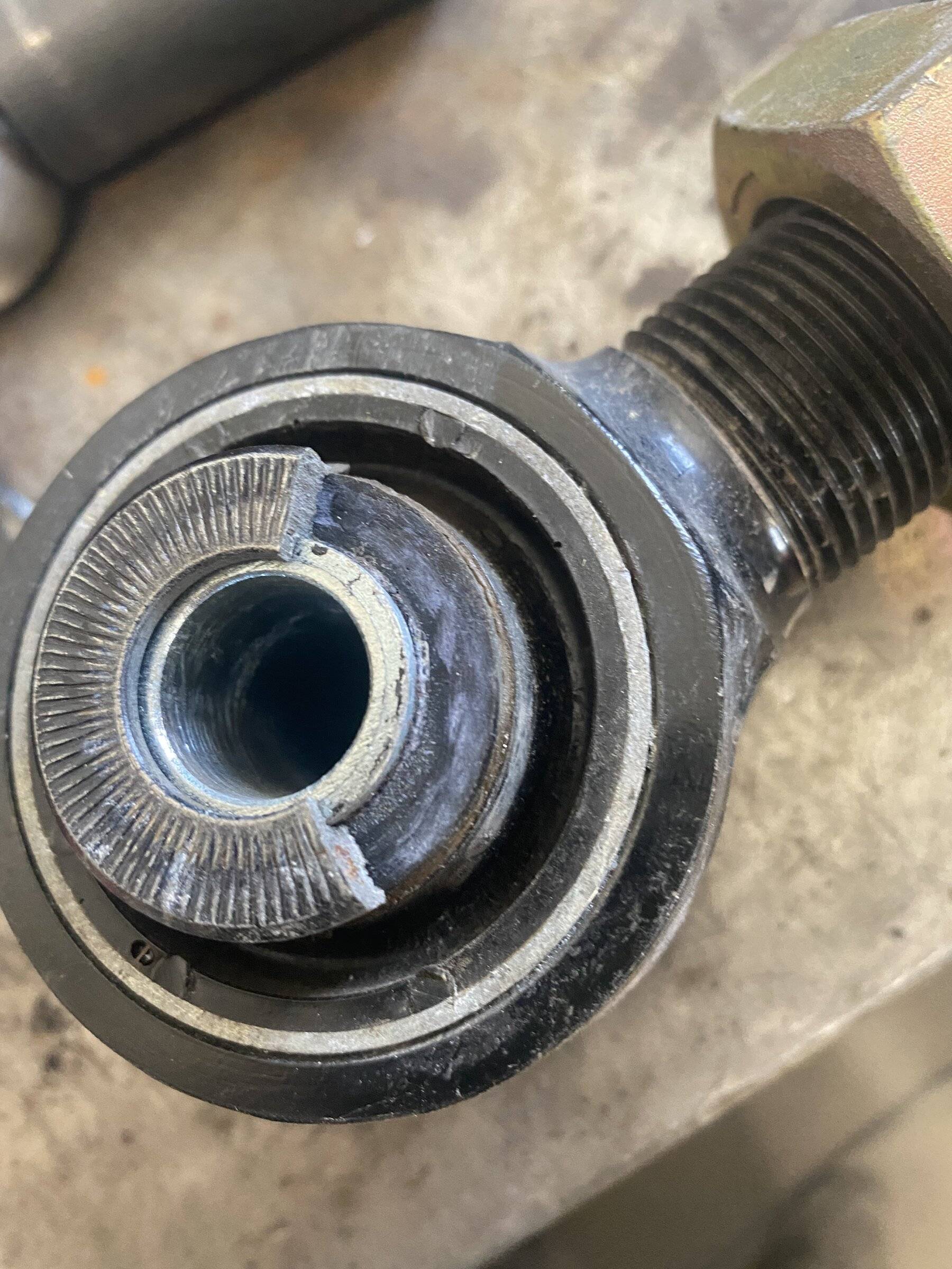

I actually found this in a different group. The poster had a similar issue and was also running the Clayton arms. Apparently the outer part of the lower control arm bushing had cracked. The inner portion of the bushing was able to move and you couldn’t see it. I might have to actually pull the arms off again and take a look to see if they are cracked internally.

and in response to the photo of the supposed internally cracked lower control arm bushing, we’ll it’s not internally cracked and only thing wrong is the side space shim/washer thats used to fill the gap inside the control arm bracket because someone obviously designed their stuff wrong. And two, regardless if that washer/shim is broken the way it’s pictured if it was torqued properly it wouldn’t matter. That is not causing any death wobble.
Post #47 of this thread https://www.jlwranglerforums.com/forum/threads/bad-idea-…-opinions.101746/page-4 he found a torn bushing on the upper Clayton track bar
