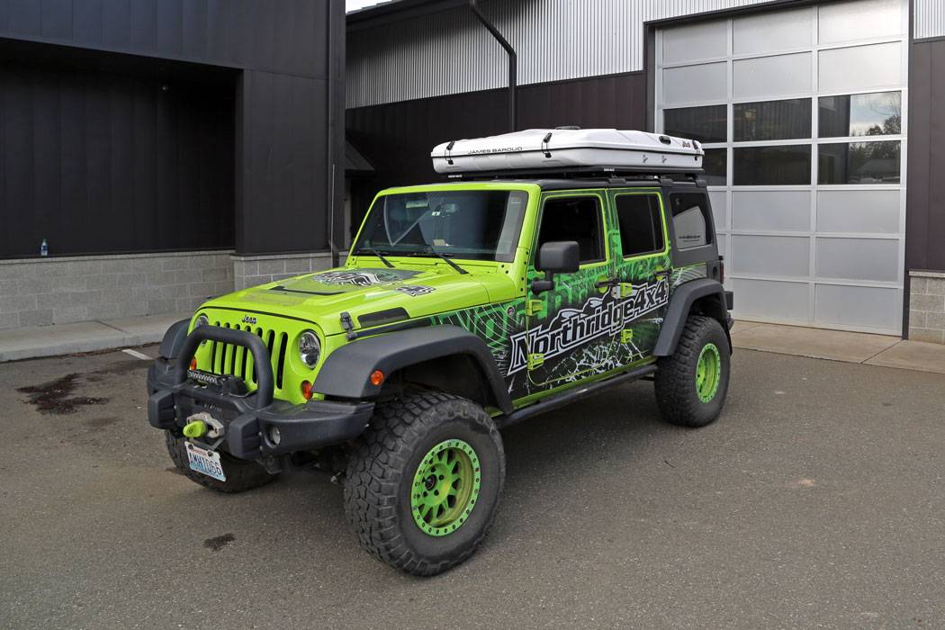

Rhino Rack Backbone and Pioneer platform with the short legs is a nice mounting platform. The backbone adds some rigidity inside the hardtop and the Pioneer platform sits real low to the roof, plus with the flat deck you can use it to easily haul all kinds of things when you have the tent off.
JL Backbone & Pioneer package:
https://www.northridge4x4.com/part/...oneer-platform-w-rcl-legs-72-x-56-unassembled
Here is one of the JKs in our fleet. This has the RR Backbone, Pioneer Platform and that is a James Baroud tent. Unfortunately we don't carry the JB tents anymore. They were low profile, comfortable and decently lightweight.
