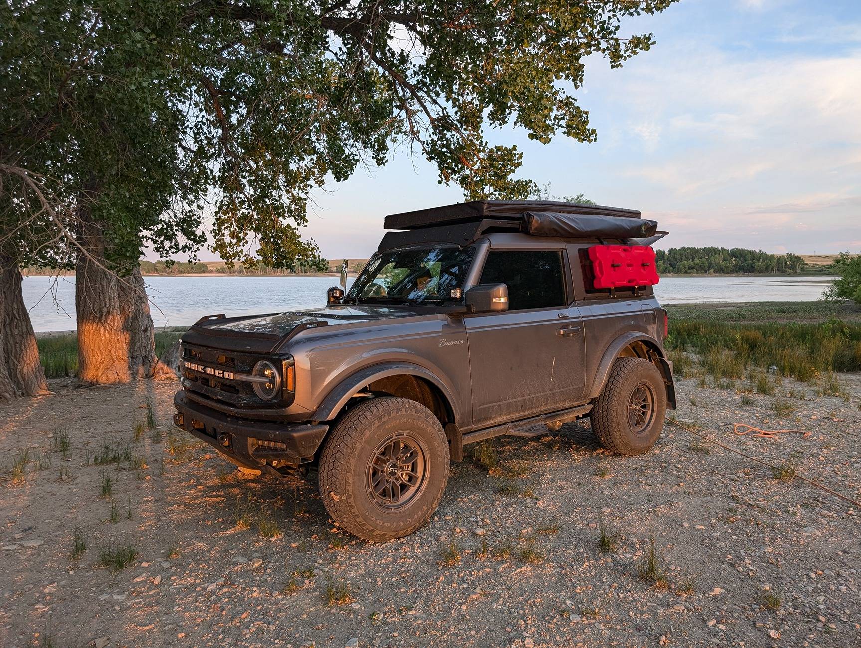

For a two door I don't recommend it.
I've got a RTT on my F-150, that I legitimately cannot notice it's there.
I had that same RTT on my 2 door Bronco and it was very noticable.
