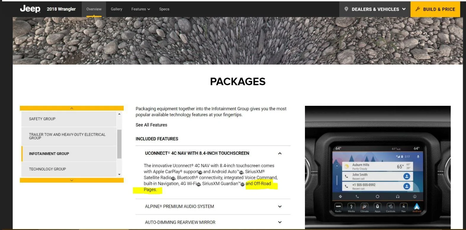

If it's true we need to be a subscriber to Guardian, then this is false advertising. This screenshot is back from 3/5/18 before Jeep pulled it from the website (Notice no asterisk after Off-Road Pages):

If it's true we need to be a subscriber to Guardian, then this is false advertising. This screenshot is back from 3/5/18 before Jeep pulled it from the website:
That also says it comes with 4G wifi and SiriusXM Guardian which are services that you have pay to use/subscribe to.
Those have asterisks (or whatever those, "reference below for more info" things are called) next to them specifically saying those are paid subscription items. Off-Road Pages does NOT have any asterisks, therefore its included permanently with no subscriptions.
