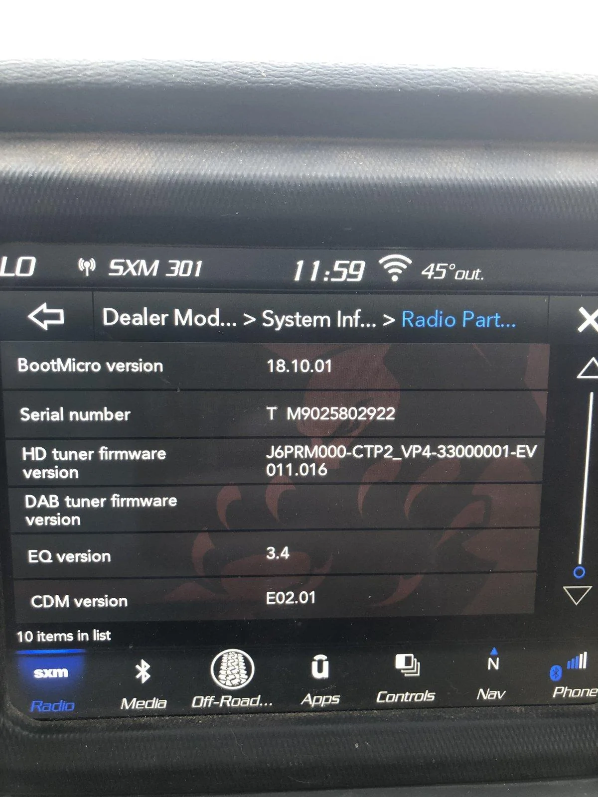

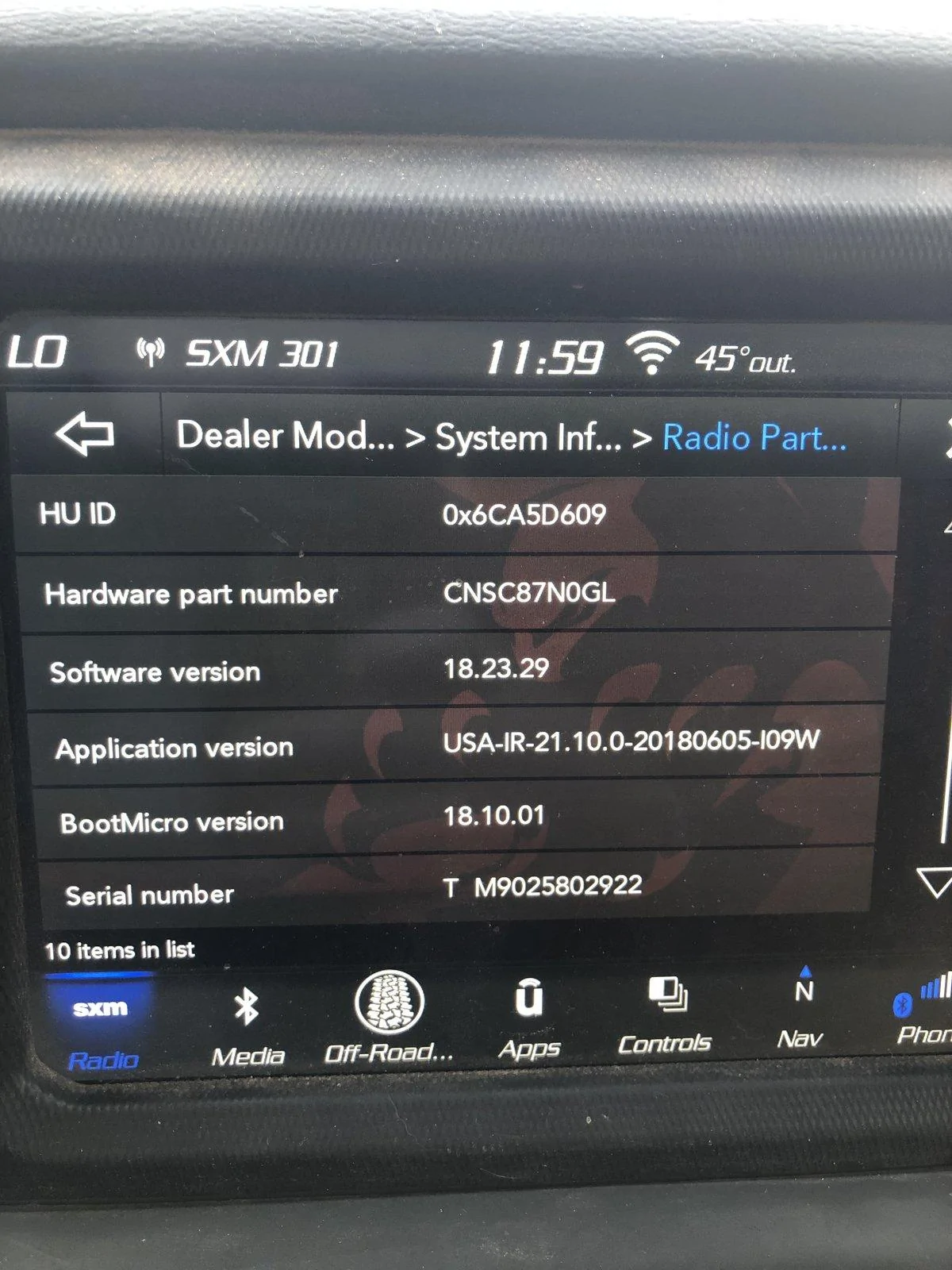

Original / old version:
>> SW Ver: 17.43.44
>> App Ver: USA-IR-19.9.0-20171026-I07G (notice embedded date code 2017-10-26)
Interim ORP version:
>> SW Ver: 18.23.29
>> App Ver: USA-IR-21.10.0-20180605-I09W (notice embedded date code 2018-06-05)
"New" version:
>> SW Ver: 21.01.00?
>> App Ver: ??? (Can someone post)
>> Or are they misinformed / misleading again and referring to App Ver 21 from last June!?
Remember you can get to this info: (Dealer Mode)
Press 3 simultaneously for ~5 sec
Press Hot (Red Up Arrow) + Cold (Blue Down Arrow) + Front Defrost

here is my info, if it helps. 2018 rubicon JL everything is currently working.

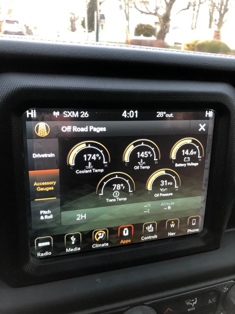

I think the execution of the off road pages has been terrible based on the horror stories.
Operationalizing these "off road pages" is just as bad. Why does this Off Road Pages tab require a lag while it finds it's GPS signal - that could be embedded elsewhere (I have NAV so it's redundant for me anyway, it already tracks my location when the vehicle is on)... as for my pitch and roll and oil temp, transmission temp etc, that should NOT require a lag waiting on a satellite signal, it should be instantaneous when I hit the Off Road Pages button.
Mine is working, but the way the whole thing works is klunky and needs a hard look. It could be SO much better.

Just got vehicle back from dealer. They replaced the 8.4 radio (wasn't receiving cellular signal). Software is now up to date on radio and Off Road Pages working. At this point just glad it's fixed.

I finally got my off road pages! I had to take it to the dealer to install them
