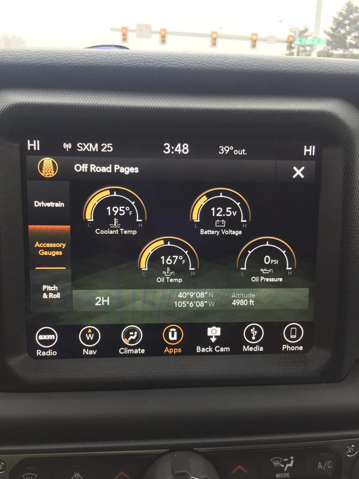

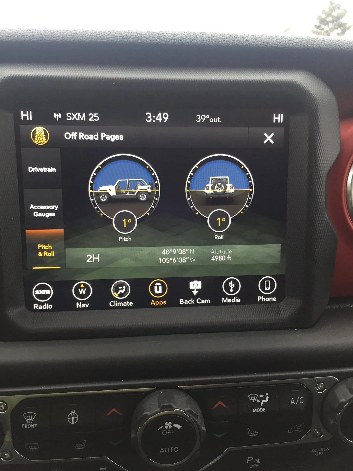

Ok, went to Prestige and got my update. ORP took and shows everything as expected. See photos.
Things of note. I asked for the TSB referenced here: https://www.jlwranglerforums.com/fo...-over-the-air-software-version-updates.12311/
Was told that that didn’t apply to me, different version TSB 08-012-18 Rev C was what I got. Hope that helps someone.
Also, mine is a July vehicle, so I can’t confirm anything about Sirius Guardian at the moment. So far it’s working though.
