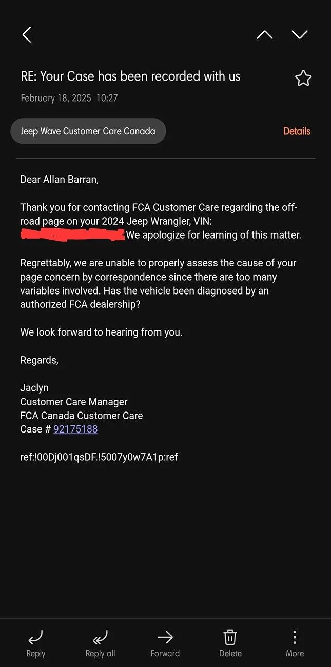

Hey folks. We are having the same problems with the Off Road Pages.
2024 Jeep Wrangler JL 3.6l
5000km
Brand new, literary.
Off road pages just won't work. Everytime I touch the app, it just goes back to the home screen.
I have read all the previous posts, and nothing is working.
Just might have to go to the stealership.
Will keep you updated.

Message Jeep Cares with your VIN & radio ID/version and they might be able to push an update or similar. They fixed mine with that information when I had a similar problem.
Sent a Jeep Cares message tonight. Let's see what happens.

UPDATE....
Well pick up my JL last night from the dealership, it seems that the off-road pages were electronically locked from the factory. Not sure why that is. They did a factory reset, install the fix unlocked the pages and everything seems to work just fine. It's been over 24 hours now. Pages still work so that's good news.
