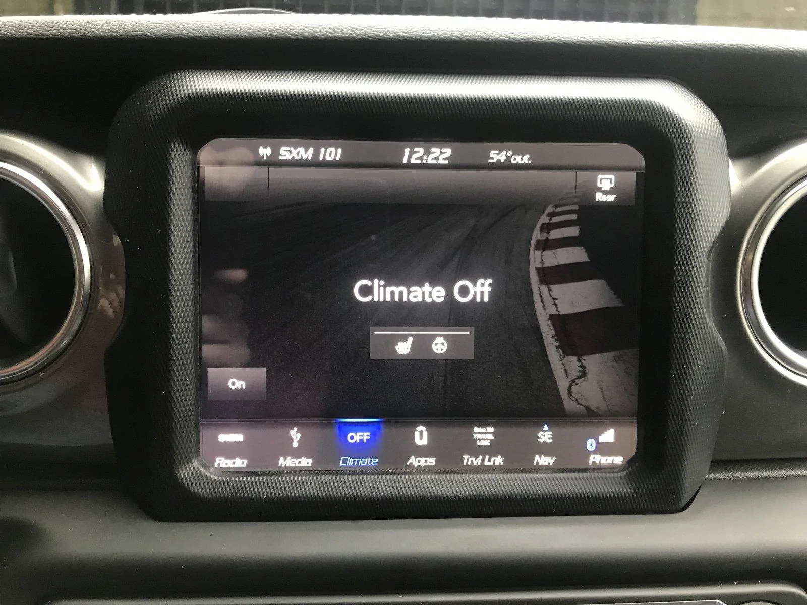

Long time lurker, only recently joined.
Bought my JL in February and its been fairly uneventful until now. On Saturday I parked my jeep after a 45 minute drive, attempted to start it on Sunday less than 24 hours later. Dead as a door nail. Got some jumper cables and waited about 5 minutes to attempt to start it. Push the button and fired up, but everything was warning lights and disabled notifications.
I then let it run for about two hours and drove it 45 minutes and put it on a trickle charger overnight. Starts now just fine however since the jump start I have no climate control available at all.
Since it was jumped, none of the button controls work, none of the radio screen buttons work for climate control. Heated seats and steering wheel works. The "on" button the radio does nothing. I have shut the jeep off and back on many times, but this has not provided any luck.
One thing I have noticed is my dash lights and shifter lights do not turn off when the vehicle is parked and turned off, with or without the key near the jeep. I have gone out hours after turning it off and the lights remain on.
I have searched the forum and google but no luck there either.
I have called three dealerships in the area and none can get me in until next week.
my two concerns are;
1. No climate control (fuse?)
2. Whats draining the battery? (dash lights)
Just noticed thread, and don’t have time to read through it right now, but I experienced the EXACT same situation, including problem arising after a dead battery.
Dealer replaced my AC module, whatever that is, and all is well.
I’m growing ever more certain that the electronics in JLs are not ready for prime time.
Pretty sure I’m going to trade in before I go out of warranty.
